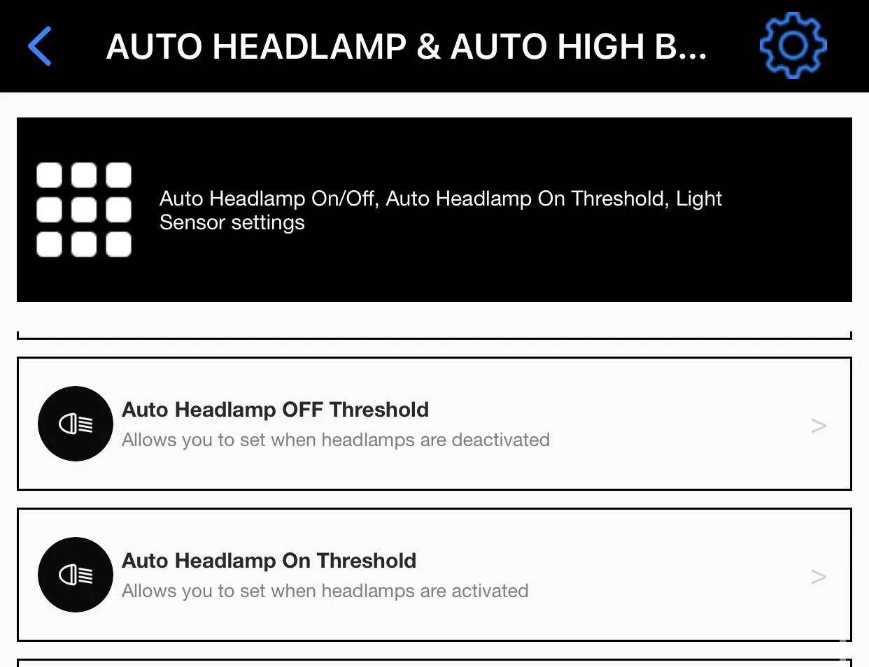

en480c4
Ian
Aug 14, 2021
70
York, ME
2018 JLR
You can adjust it with the JScan app. I had the same issue and it drove me crazy. I turned up the threshold for it to turn on so it won’t come on in shadows on an otherwise clear day, and turned down the threshold to turn off so that when it does turn on, it stays on a little longer if you’re in and out of shadows at dawn or dusk. I think I went from 3.6 V to over to 4 V for ON and from 2.8 V to closer to 2 V for OFF.
