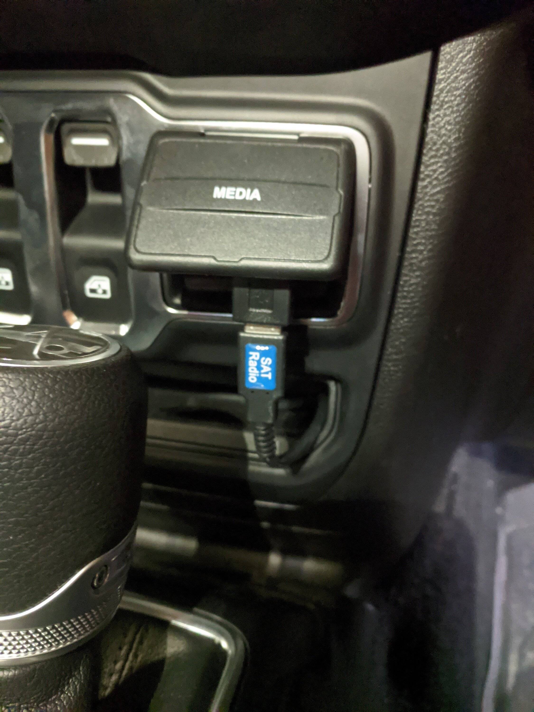

As a follow up to my previous post #46 above, I have since located the major source of my ESS / battery charging issues. It turns out that a professional installation of my satellite receiver was the primary culprit. In order to keep the cockpit clean I purchased an integrated Vais Tech GRS FC02 Satellite Receiver unit that plugs into the UConnect 3 Radio via the USB-A plug in the Media Center. The satellite receiver then shows up and is controlled as an iPod with full control of browsing channels and presets via either the radio touchscreen or steering wheel pushbuttons. Pretty nice.
It turns out however that this unit was wired directly to battery instead of switched ignition. This then was the source of all (well most) of my ESS trouble. It was just enough of a draw to drain the AUX to a low enough potential to make it appear to be discharged to the point of disabling the Auto Start Stop system.
Interestingly, after measuring the parasitic power draw, the GRS only consumes several milliamps (pretty insignificant), but as long as the USB port is plugged in, the UConnect 3 consumes about an amp. Even with ignition off. Yikes.
So until I can noodle out how to internally shut down this crappy 3" UConnect when something (likely anything) is plugged into it, I just have to unplug the USB cable. Picture below.
So no matter how well you do your modding homework on these JL's, there's always some sort of cause and effect with unintended side effects. But I really do enjoy listening to music way out in the mountain wilderness well outside the range of cellular service when off-roading here in my home state of Colorado. Sure I can run an mp3 collection or two but the pseudo random variety of dozens of my favorite stations and news feeds are certainly much easier. It also frees up my smartphone for GPS navigation.
