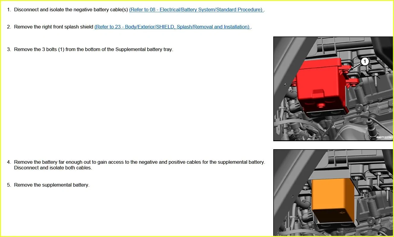

recently got stop/start unavailable service stop/start message.
check engine light not on but Tazer was able to pull code P00FD.
I have checked both main and aux battery voltage and both are 12.4 when Jeep is off.
anyone Have any idea on what could this be? Jeep drives fine. No issue besides annoying “circle A” light.
