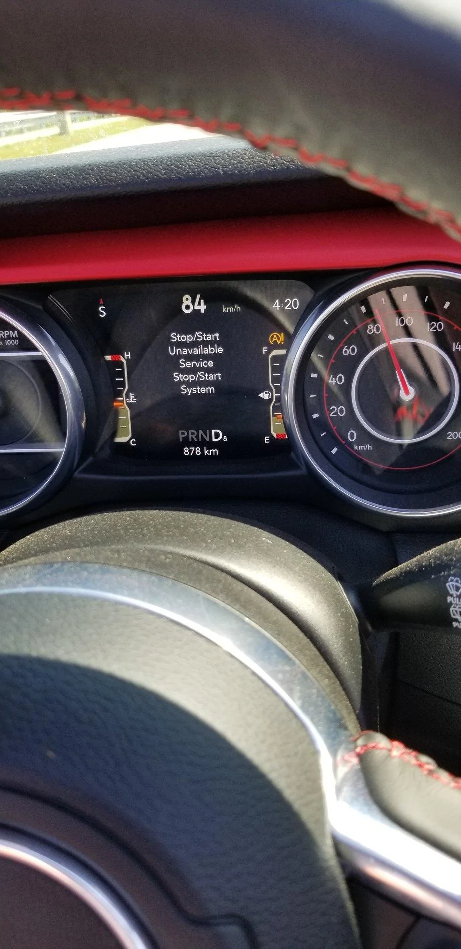

I received this message today. It went away after turning the engine off and on, and the ESS worked properly afterwards Jeep Wrangler JL Stop/Start Not Ready - M/T 20180529_162058

I had the same issue with mine, along with the Service 4wd and Swaybar Disconnect Not Available lights. Dealer had it for 5 days and found the culprit, a connector not properly seated.

Well, I guess AwCrimey, but in reality I don't know if my ESS worked even though I had that warning because I always turn it off. So, if it did in fact work, even though the system said it didn't, then it's possible you could have a loose connection type issue as well. What do I know though? Nothing, lol.

Now that I think of it, it's not too far out there to think your issue is easily fixable (by the dealer) as well. I know my 4x4 system worked, and so did the swaybar disconnect, but since the connector wasn't seated right it was throwing that code. Just saying. Hopefully you get it taken off soon, for peace of mind.
