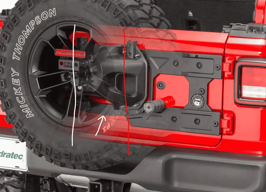

So I will give you my experiences:
I started with a 33". moved to a 35" and then later moved to a 37". I installed the Mopar tailgate reinforcement and spare tire relocation kit at the same time as the 35". The studs are pressed into the tire relocation kit and they eventually started puling out. I fabricated some new relocation plates from 5/16" stainless steel and backwelded studs into them.
It worked OK for a while, but the tailgate always rattled and over time, the tailgate reinforcement plate would loosen despite me keeping the 4 bolts incredibly tight. In the end, when using the OEM reinforcement, the tailgate remains a load bearing member and that would be fine IF the hinges were about a foot longer creating more leverage on the tailgate and spreading the load further out, but that is not the case.
Look at the photo below without the tire mounted. With the Mopar kit everything to the left of that red line is unsupported and the tailgate takes the weight/vibration. The CavFab holds 100% of the weight/vibration on the hinges and tub mount--meaning that if you left the tailgate off, the spare would still be 100% supported. The Mopar kit cannot do that.
When I upgraded to 37" tires (BFG K02), it was never a consideration to use the Mopar kit. I sold it and installed a CavFab kit. I would highly recommend it for you. You will ultimately change the Mopar kit to something else and will have spent more money than needed.
Buy once and cry once...
First, let me say, fundamentally, I do not disagree with anything you said. This is not a challenge to your opinion nor your experience in the matter, but rather some counterpoints for those who might be afraid to use the Mopar kit.
I wonder if (hope) you got a bad kit from Mopar? I wonder if the rattle wasn't coming from somewhere else and you over tightened the nuts on your tire carrier and that pulled them loose?
I also put on the Mopar reinforcement kit, and have a 37" BGF hanging on the back. I do not hear any squeaks or rattles even when off-roading. The tailgate and mounted spare feel firm and strong with the Mopar kit installed. But, I do agree that your current system would be much stronger than the Mopar one.
*note* I am aware of the fact that your off-roading in or near Colorado is not only "serious" but frequent compared to mine OH/MI/PA with off-road parks.
Also, I think your picture of a red line that holds the load is off. The Mopar hinge reinforcement kit extends to the first 4 bolts on the tire carrier. That would push your red line toward the left, to the midpoint of the outmost bolts (from the hinge). New "red line" drawn below. Then, if you purchase the Mopar oversize tire carrier, the kit includes a couple of steel "bridges" that when assembled, build a solid connection to the next set of bolts. This would move the redline all the way to the 2nd set of 4 bolts on the tire carrier. Marked with "White line" below. Those all transfer the load to the hinge (as well to the tailgate latch when closed). Keep in mind, none of this matters if the bolts are being pulled out of the plates.

It has been a minute since I had the Mopar and forgot it went all the way under the edge of the plastic tire carrier. However, that and the aluminum plates aka "bridges" is in no way the same as a solid piece like a CavFab which completely replaces the OEM hinges and is 100% self-supporting.
Every one of those bolt holes in the Mopar kit are oversized and they are not unified in the way that a one piece "anything" would be - e.g. each of them is a place for movement to occur. In addition, note that all of it under the tire carrier is being tightened against plastic. Alternately, you can remove my tailgate and it would have zero effect on the support for the spare tire via the CavFab.
The part that loosens over time are the 4 bolts which go through the stock hinges and allow the entire tailgate to start to sag. The 8 bolts in the plastic tire carrier do little if anything to support the tailgate with the Mopar kit.
I wanted to make the Mopar kit work, but it is not the answer to a heavy tire/wheel combination. In the end, the Mopar kit is about half the cost of a CavFab, but it cannot compare.

The 4 bolts at the hinge went bad? ooh, that's not good. Can I ask why you didn't go with a bumper mounted, hinged tire carrier? Just curious...
No; they did not go bad, they would loosen over time to the point of the tailgate sagging which then led to rattles. The 4 bolts are holding the vast majority of the load.
Because the CavFab (and likely the Teraflex) look much cleaner and I did not want to change my rear bumper. I am in the "I like the OEM steel bumper" group. Besides, I have seen more than a few bumper mounted carriers break.

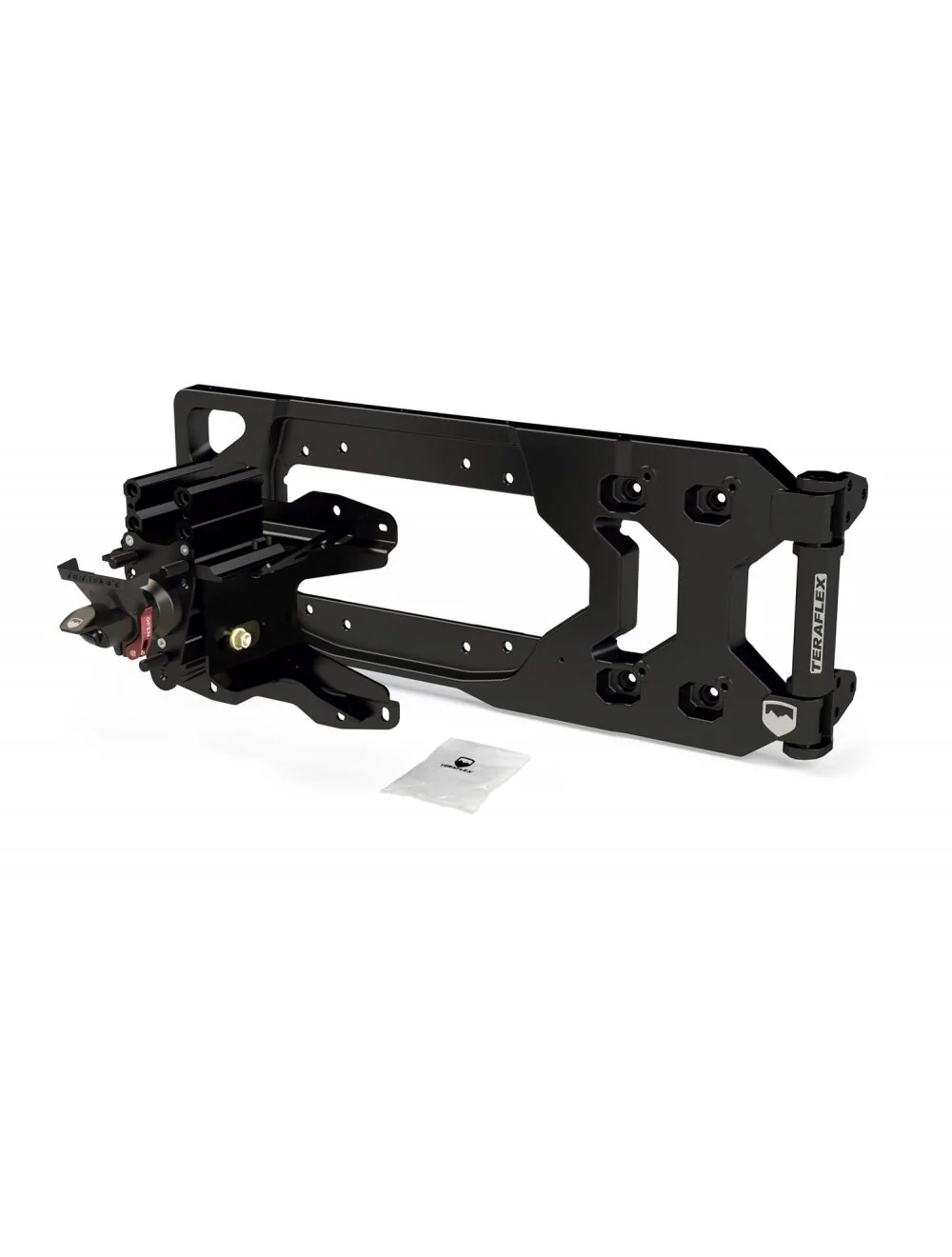

The Teraflex option strengthens the hinge of the tailgate, increasing it's max load capacity. The spare tire mount attaches to that, like the OEM/mopar options. And based on all the research I've done, it makes no noise. Plus it looks better than any other aftermarket carrier.
The Warn tire carrier attaches to the bumper, and IIRC people have reported issues with it making noise.
I have the Warn Elite rear bumper with matching Warn tire carrier. It’s silent. It’s also adjustable, so perhaps the folks complaining about noice never got the carrier adjusted properly.
The Warn bumper/carrier option is stout. It’s also very expensive for what it is and it’s a colossal pain in the ass to install.

The Teraflex has holes to the right of the tire carrier (above and to the right of the mounting bolt holes) that are there for mounting things like Hi-Lift jacks and CB antennas. They sell additional mounting hardware depending on your use case.
I definitely won't use the CB antenna. Might use the high lift jack. The water and gas is most likely, but I don't see that the teraflex option offers brackets for that.
I can't imagine that Warn would make a tire carrier that doesn't work excellent with their reputation on everything else.
