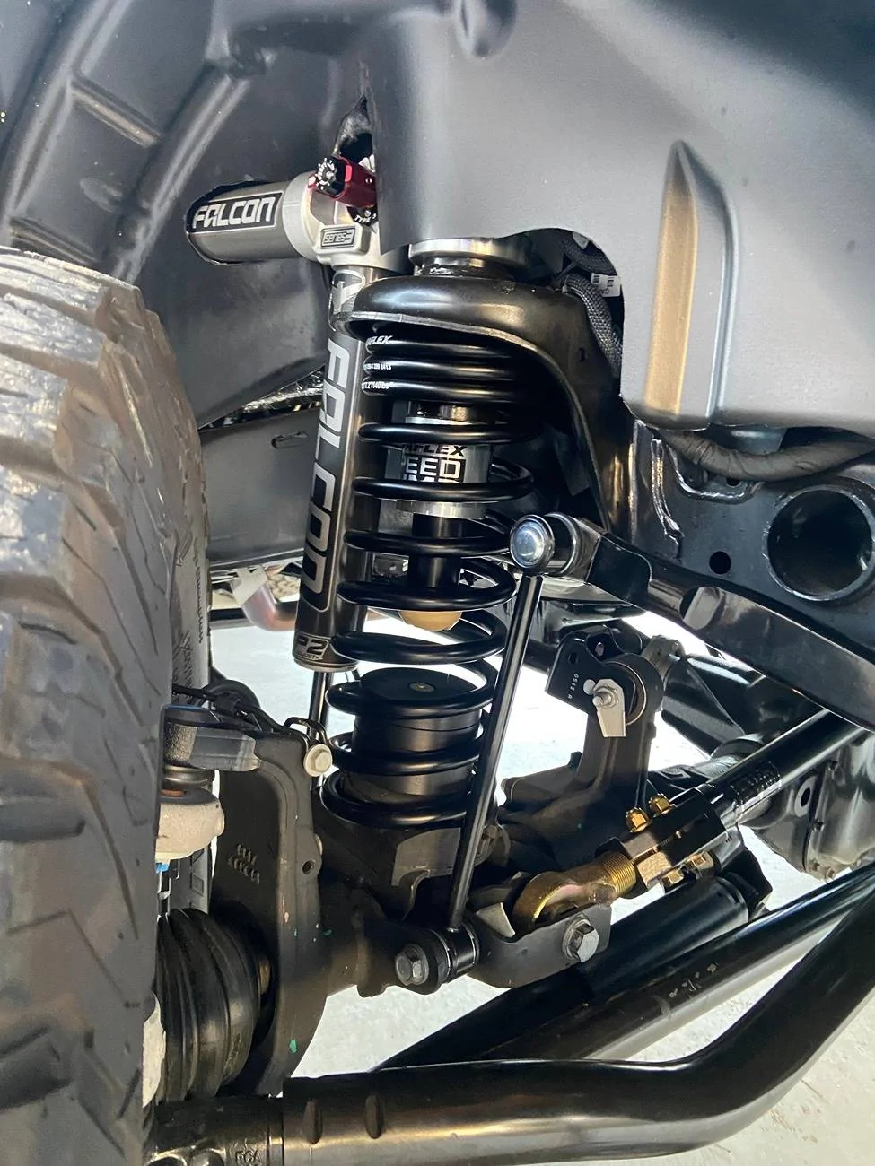

100% factory shocks suck. even with minor off roading i lost my factory shocks at 11 K. ended up getting the falcon 3.3 fully adjustable shocks. one the best upgrades to date. 4.5 years on the jeep with no issues thus far.
