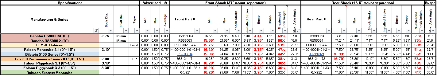

Here's @AnnDee4444 's awesome shock spreadsheet set for Rubicon height and stock bump stops. I tried to filter down to just shocks that work with stock bumps, I added in the Rancho's from @sourdough 's recommendation, it's collapsed length is about .25" more than steel to steel, but that's probably right at what the jounce bumpers compress to. This is in order of theoretical axle articulation angle.
I run the Bilstein 5100s and they're solid IFP Monotubes for the money (under $100/corner). Fox have a few additional features (slightly larger diameter, aluminum bodies), and in the no lift case, offer more articulation.
I added the Rubicon Express shocks to my downloaded version of the spreadsheet when looking at another member's request. Not sure on reviews, but are an interesting option due to the amount of travel.
is the 1.5-3 inch height bilstein 5100 the correct height to run with stock rubi springs?
GATORB8
May 30, 2021
8,831
11,726
CLT NC
21 JLURe, 06 LJ, 25 HDZR2
No, at least not with stock bump stops. In front, they're about 3/4" longer compressed than the metal to metal stock bump (17.070 vs 16.25 respectively).
That could make the shocks your bump stop.
