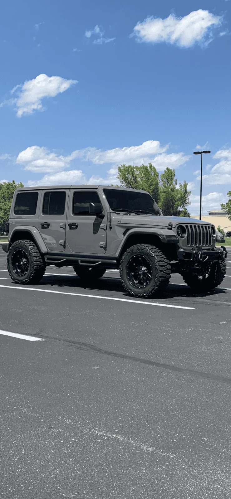

Ordered factory color in spray can and painted d rings sting gray

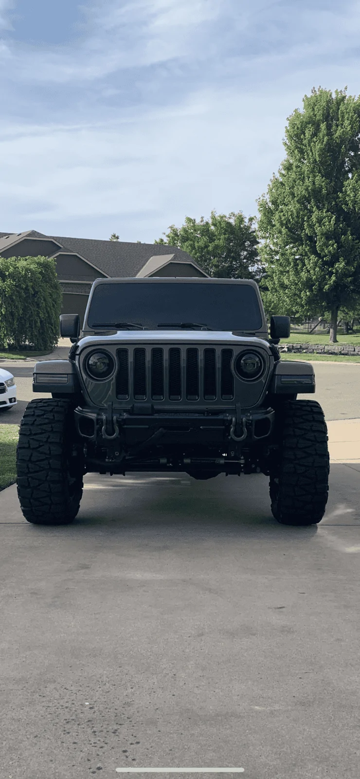

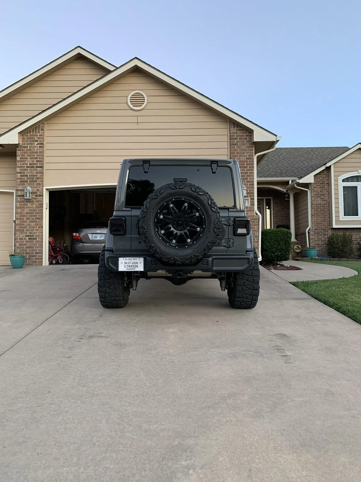

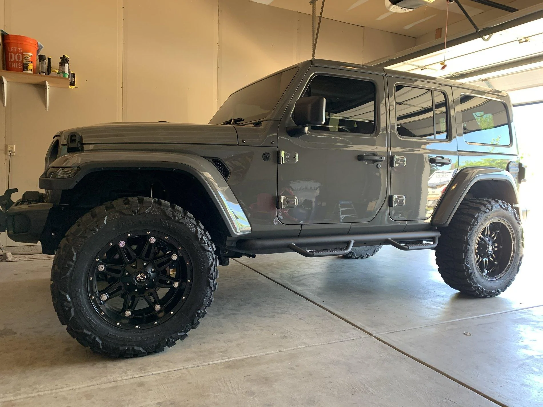

3.5” rough country suspension lift 35x12.50 Nitto grapplers 20x10 fuel hostage wheels. Rugged ridge Arcus front bumper with smittybuilt x20 winch, rough country side steps. Bi led oracle headlights oracle taillights oracle third brake light and oracle side markers, Morimoto turn signal lights then I painted everything silver on the Jeep with duplicolor black wheel spray paint. Tinted all the windows even the windshield at 30%.

No painted them cause my Jeep is keyless entry so never use them I used duplicolor black matte wheel spray paint. A friend did his also but he used plastidip. No aftermarket ones yet so did it myself.

Jus use painters tape around key whole then cut a whole out of large sheet of plastic and tape it over the key whole u already taped off so your hole u cut doesn’t have to be perfect. U will want to use fine sand paper to rough them up then clean them with degreaser use Qtip to clean inside key whole good. Give 3 light coats. Holds up great duplicolor wheel paint.

Love the view from the front, perfect choice w/ that bumper, looks mean!

FYI those are called hard shackles. My guy in NC powder coated mine for like 30$
Or for 13$ u can order factory spray can and paint them to match urself
