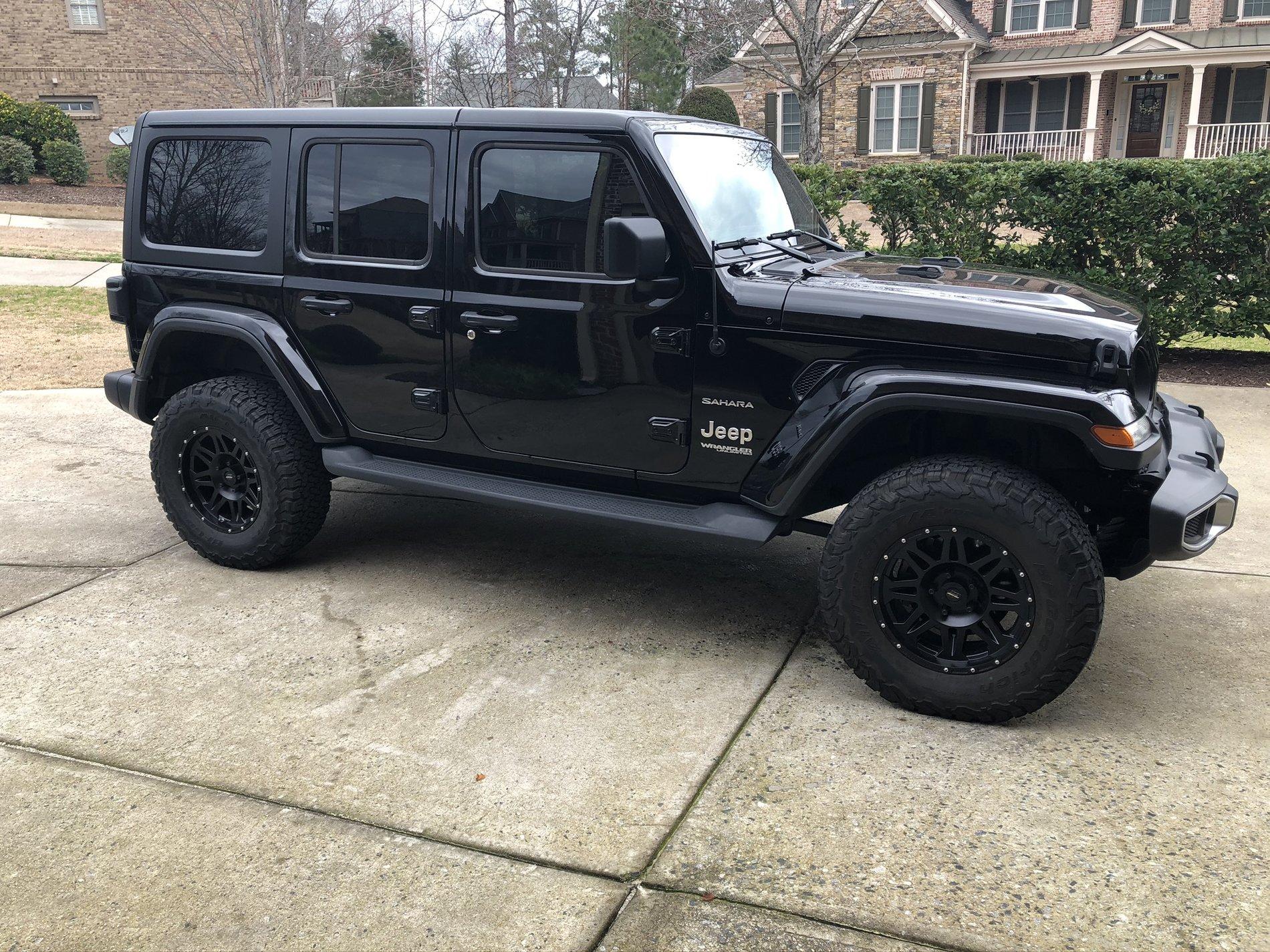

Thanks @walweb, I actually ended up installing the Teraflex 1.5 (+0.5 at the front), with shock extenders. Now I just need to get an alignment done :)
I did think about a JLUR suspension swap, I did one on my JK, but most that are being done seem to be on the two door, I am not sure how much lift a Rubi swap would give a 4 door Sahara. Keep in mind that the springs are universal between Jeeps, it’s just the more you put on the stock order (steel bumpers, tow package, hard top, etc) the higher the rating of the springs. Rubi shock would likely have negated the need for the shock extensions, but I am happy with my ride, and may look at after market shocks at some point in the future.
Here she is with the 2” lift (I didn’t have a front rake so I needed to stay even all around!)
Jeep Wrangler JL Still have rake after level kit 26942602-8F65-47A6-8494-27FFFBD93EB2

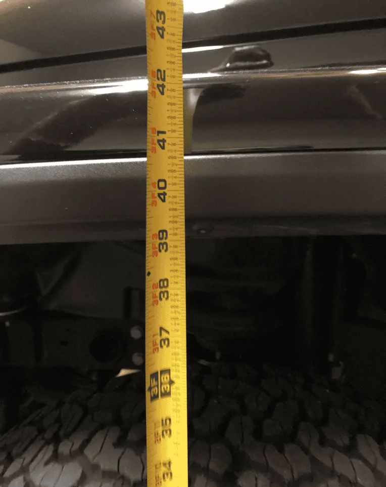

I went through the center line of the wheel to the bottom of the fender.
Jeep Wrangler JL Still have rake after level kit Screen Shot 2020-05-19 at 2.55.05 PM

Before I installed my spacers, I measured front and rear, and was at 37" on both fenders, after installing the 2" spacers I went up to 39".
In my mind, as long as you are measuring in the same spot before and after, you can determine your lift, on my Sahara, the fenders showed that I had no rake.

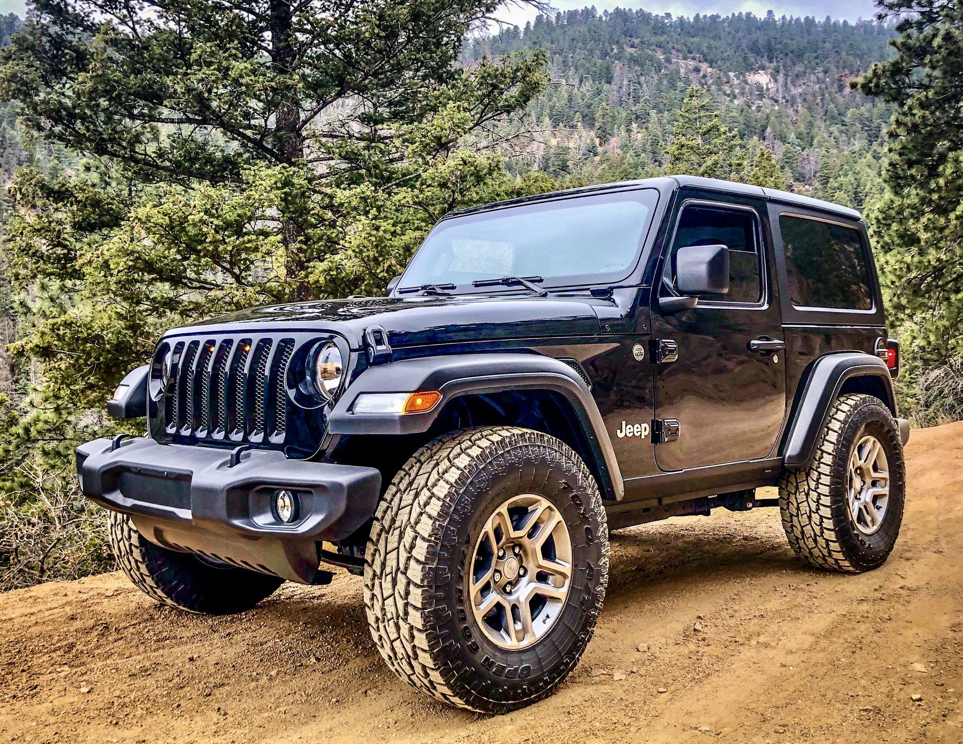

I think it depends on 2dr vs 4dr. If i were to do it again I would pre-measure what my front and rear heights are then add spacers based on what I wanted for and end result.
This is what i did on my 2dr and i think it worked great. leveled out just what i wanted with a small rear rake to compensate for future front bumper. I trust my measurements as opposed to a kit that tells me what i want.
*pic is exaggerated since the ground isn't level*
Jeep Wrangler JL Still have rake after level kit 86E37652-DA93-4118-B61A-1DCC311BB172
