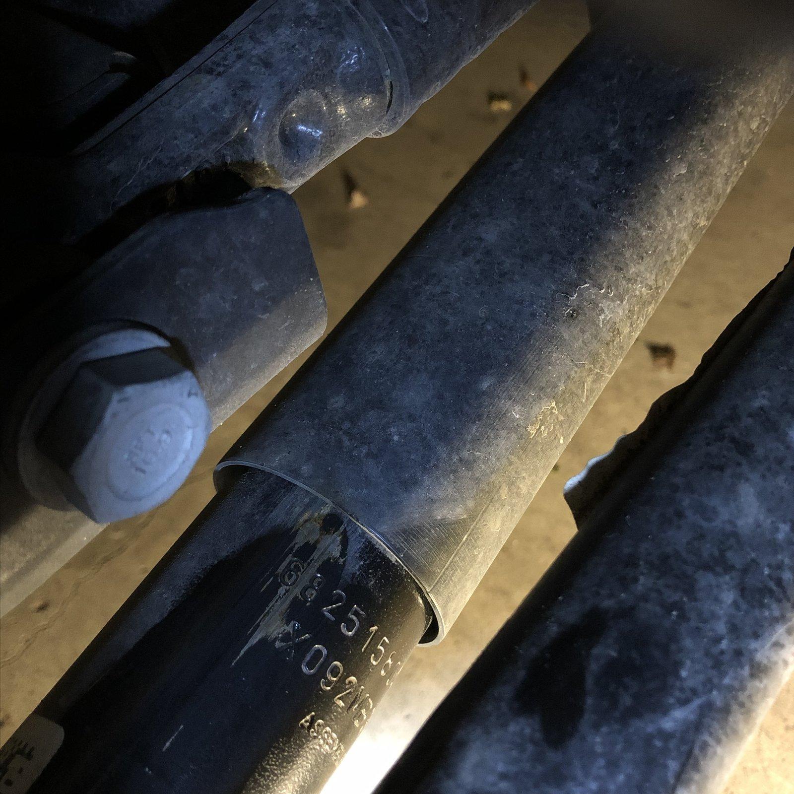

I started noticing a wobble/shimmy a couple weeks ago when driving over a bridge on I-75 only one (1) mile from FCA HQ in Auburn Hills MI.
Checked out this thread tonight after watching a video piece on a local Detroit station warning about this issue.
Thanks much to all of you who contributed your knowledge and wisdom.
I’m at 7080 miles so that is consistent with many other owners’ stories. Snapped this pic tonight X092 so I’m in the club. Note the long vertical scratch next to the X.
I’ll be calling and texting this pic to my dealer’s service department Wednesday morning. @JeepCares
Update:
Service manager, Ralph, called me within 10 minutes of my text going to my salesman at Szott Chrysler Jeep in White Lake, MI. I was able to get there by 1:30 and he already had a 2D manual Sahara JK loaner reserved for me.
He confirmed the part is on backorder but another dealer had 5-6 in stock and was willing to send it over. He will also take care of any other outstanding issues like CC. Said my welds are okay.
So I recommend getting this checked out while some parts are still floating around to avoid having to wait for the back orders to clear. Will update again when completed.
