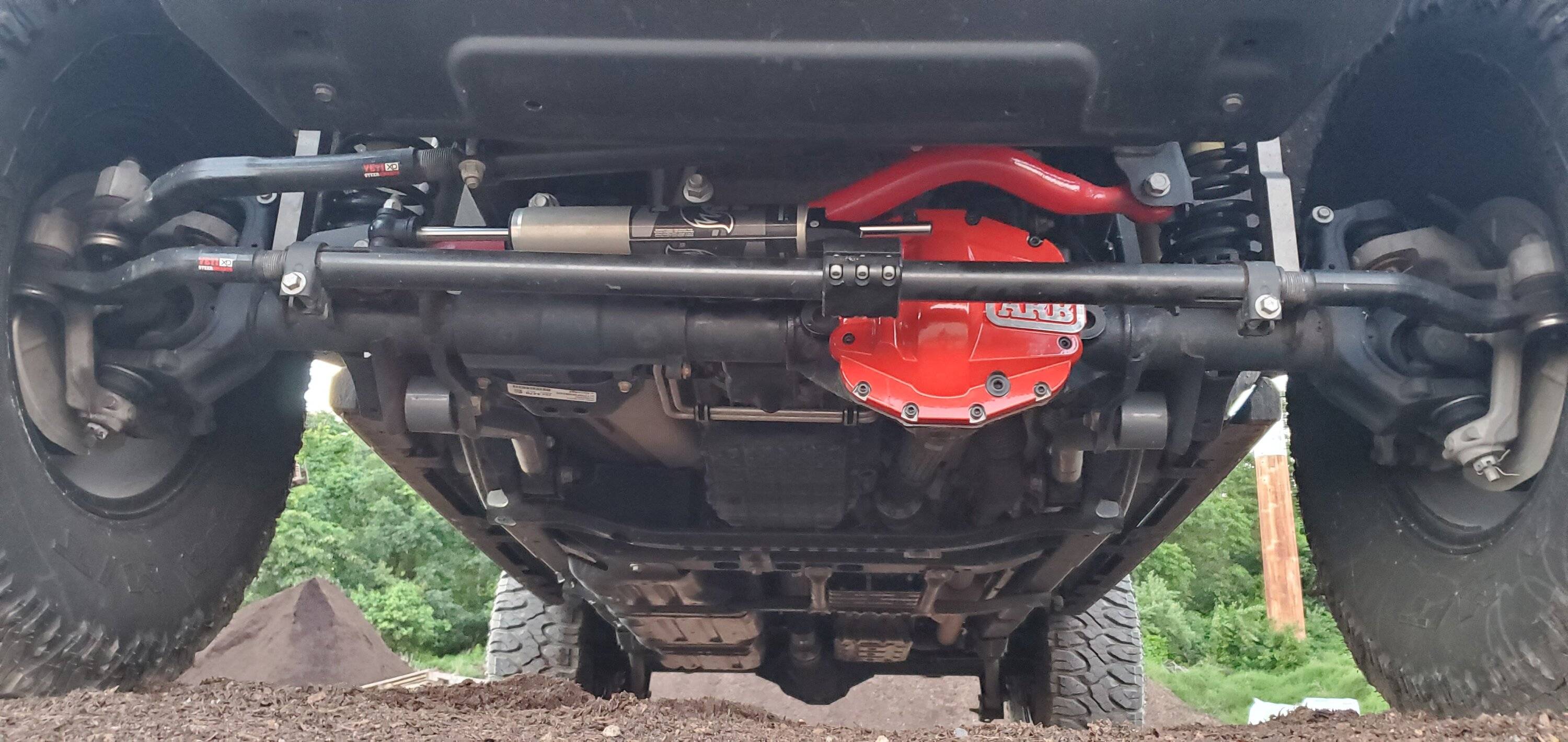

I used to have that exact combination of parts on my JLUR. Others have already showed you the JK stabilizer, which is a great shortcut vs swapping the JL bracket for a tie rod clamp.
It looks like you've got the relocation bracket too. Interesting that people were reporting that it won't work with Fox stabilizers.
Any stabilizer shock for a JL will have the same bushing width and through bolt size on the rod end, and will work with the SteerSmarts axle side relocation bracket.
The possible issue would be if someone was trying to install the stabilizer backwards, with the shock body bushing on the axle side. The through shaft would hit the ear of the relocation bracket. The only other possible issue, is if the stabilizer was oriented correctly, but a regular hex head bolt was used to attach the tie rod clamp. It would have too high of a profile and interfere with the through shaft, which is why the lower profile countersunk bolt is needed.
