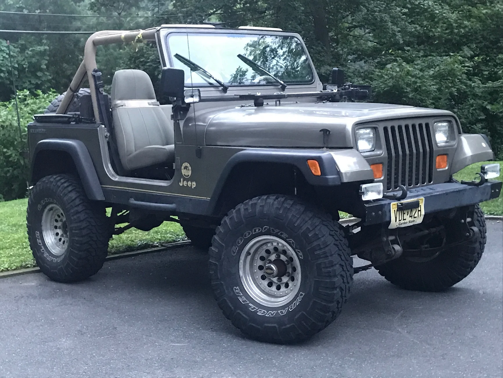

This is the first JL, last Jeep was a YJ I built up in my garage, lift, Wagoner and Rodeo D44 swap, motor mount lift, you name it. It had bad death wobble until I reset the axle perch angle then it was a 1 finger steer, no track bar or stabilizer Jeep.
Jeep Wrangler JL Steering gyrations instability over bumps IMG_0349
