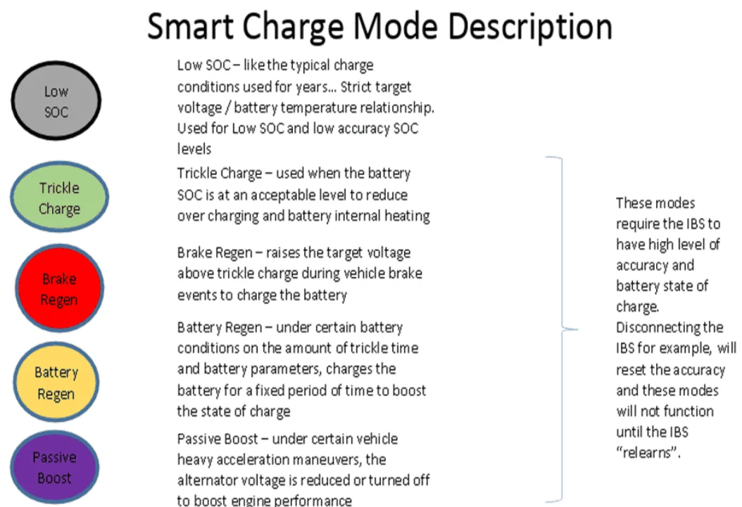

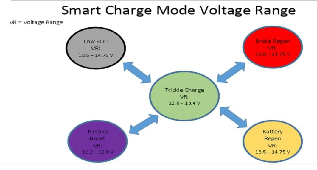

The undercharging whilst moving -- 12.5 volts -- is a charging system red flag. It should be 13.9 to 14.2V. The voltage regulator may indeed be an issue here.
There is no voltage regulator. It's controlled by the PCM based on information from the IBS, engine torque required, going up hill, down hill, ambient temperature and other factors.
The normal range is from about 12.6 to 15.0 and that can fluctuate.
If the battery is at a 100% state of charge and/or running hot, the PCM cuts the alternator back and the voltage will drop because the vehicle is then running mostly from the battery. If a large increase in engine torque is required at the same time, the alternator is totally cut off.
The exact voltage you see can be 14.7, for example, if you haven't driven the Jeep for a while and the batteries are down. I 've seen mid to low 13s if the batteries are full, it's a warm day and I'm going up any of the many hills around where I live. Then when I crest the hill and start to coast down, the voltage will climb above 14.
There's no rule saying what it will be for my Jeep compared to your Jeep - too many variables.
If the alternator is fine and if all electrical connections are first checked and found to be ok, then yoj may be looking at an IBS or PCM issue.
Any time batteries are replaced- ALWAYS:
Charge each battery fully before installing
and
Leave the IBS disconnected for at least 15-20 seconds to reset it
so it will learn with new batteries.
Skipping either step can lead to really weird things like weird voltages, batteries not staying up and so on.
I resolved issues by separately charging both batteries with a good AGM charger (10 amps or more) and let it go through all charging phases, and leaving the IBS disconnected from everything for a while to reset it. Charging voltages and weirdness went away.
Yes, the brake regen applies to gas and diesel Jeeps - it's when the system senses you are braking, need no extra engine torque, and it ups the load on the alternator to regenerate the 12v batteries.
Oh, and parts stores don't know how to properly check batteries and normally don't know squat about today's smart alternators (well, it's really a smart charging system, the alternator itself has no smarts - it's just a modern version of your 1975 Plymouth alternator) A parts store is the last place I want messing with the charging system on my Jeeps and I don't trust their battery tests because they just don't do the whole slate of tests properly with those hand-held devices, especially when trying to test a battery that isn't fully charged. You get bogus results.
