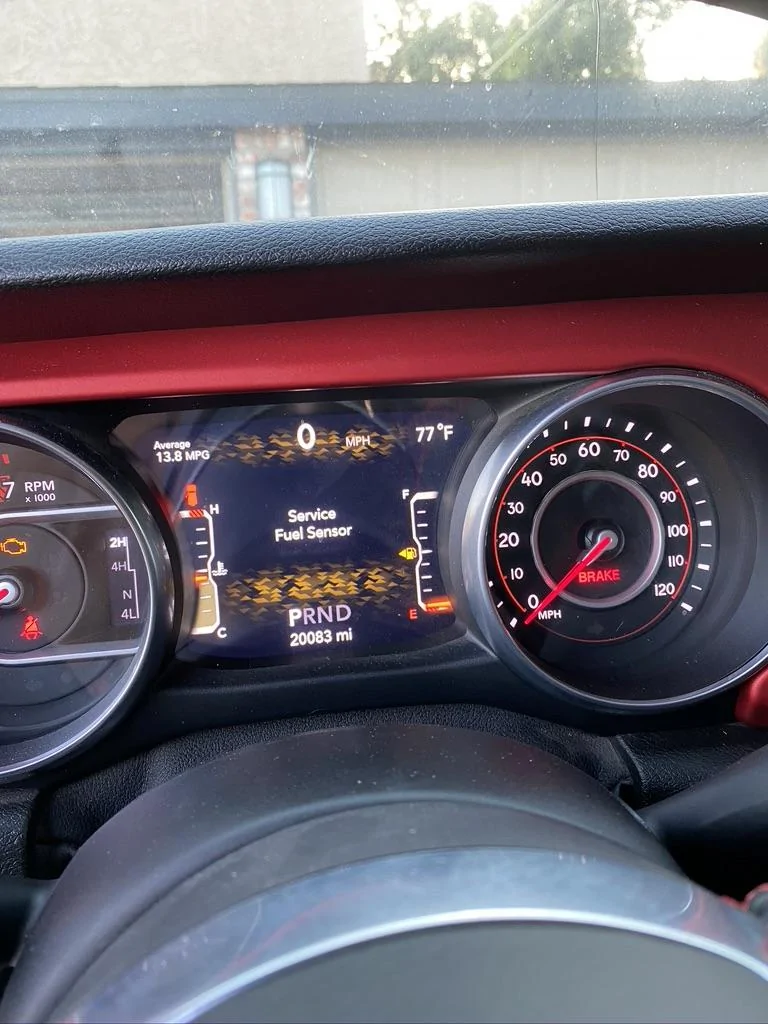

  1. "Service Fuel Sensor" - I'm getting this message on my screen. Also, the the tank is full but the sensor says it's empty and it's flashing empty on my gauge. I drove the jeep over the curb a few times to try and jolt the sensor free thinking it might be stuck but no joy. I checked the fuses and it appears to be fine. Assuming the wiring for the sensor is part of the same bundle that connects to the fuel pump I did confirm it was connected and if it wasn't the fuel pump would not work and the engine would not run which it does.

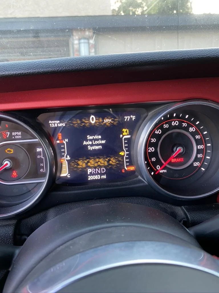

  3. "Service Axle Locker System" - I have run the jeep around the block a few times hoping this would clear but no such luck. I put it in 4H and 4L and pressed the axle locker button for the rear and also front/rear and nothing lights up on the button or the dash to indicate the lockers have engaged and I also don't hear anything or feel anything. This is my first 4wd so I;m not sure if I am supposed to hear or feel then lockers engage. I also noticed when I shift the transfer case into 4H and 4L it does not light up on the dash. Neutral and 2H do light up on the dash.

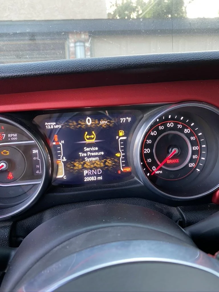

  4. "Service Tire Pressure System" - The previous owner put 37 inch tires on the stock rims (milestone patagonias). I don't know if the tire pressure monitors were removed when the new larger tires were put on. I used my Tazer and found out the jeep was still programmed for the original tire size (32? from memory). I reprogramed it to 37's yesterday and changed the TPM warning to go off at 25psi (which I think is the new minimum from zautomotive with the latest software update). I have all tires inflated to 30psi but still get the warning.

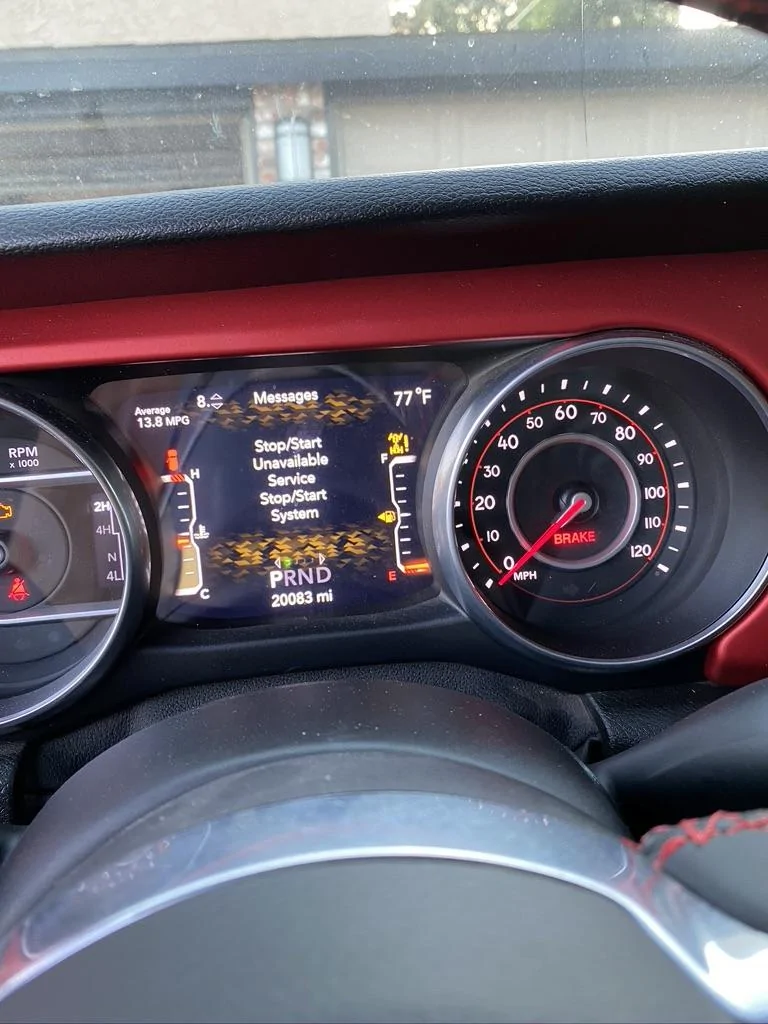

  5. "StopStart Unavailable - Service Stop/Start System" - I have not tried to start diagnosing this yet as it was least on my priority least but it may also be related to another code so it was worth mentioning here. Maybe the smaller battery that supplies power for the auto stop start function is bad.
These guys fixed a similar 4WD issue in a JT by disconnecting and reconnecting a plug, and swapping out a relay.

Hmmm, interesting. I have been all over the fuse box with the exception of the relays. Ok, I'm on it!
These young whippersnappers are my inspiration for the whole build project we are working on. Amazing young guys for sure!
