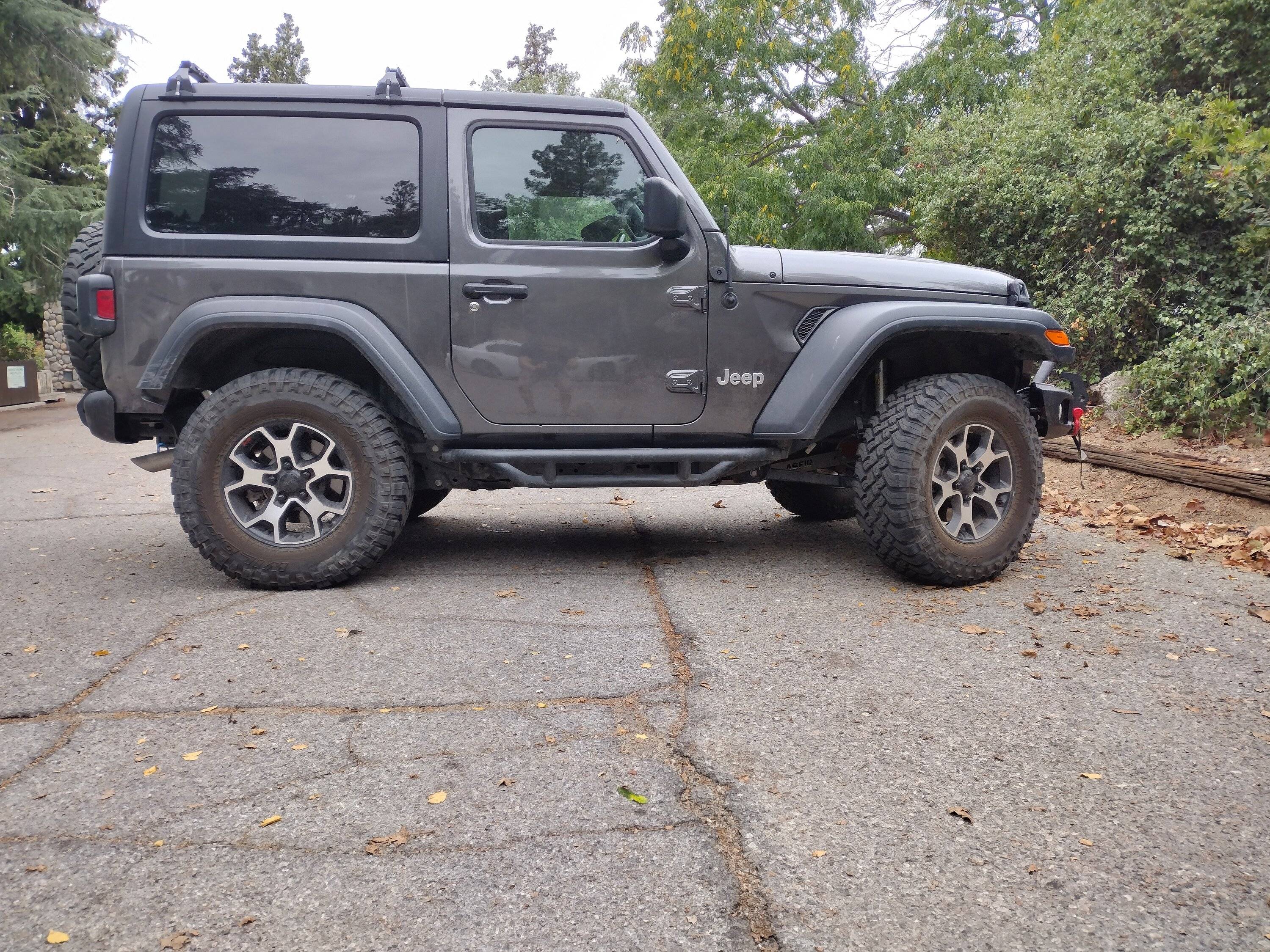

They do have 1'' spacers. It is totally fine to stack them. Theyre designed to be stacked. They fit very nicely have nipples to stack in place. He wont need extensions for the shocks. He has Rubicon shocks and his willys is shorter than a Rubicon. Sway bar links are still fine.
This is my Jeep on 33s. Rubi springs, 1inch spacer lift and 2.5in lift shocks.

Thank you!
This is basically the setup I'd like, with the exception I'll keep my stock springs.
Along with the 1" of spacers, I went ahead and bought the Mopar LCA's to improve the steering feel a bit.
I'm only looking to do mild trail duty, and on road use, so these suspension components combined with the 33" (285 series) KO's sound perfect to me.
Not really into the Willys OEM Firestone mud terrains.

Youll be fine. Youll basically be at Rubicon height with the spacers. The only thing to keep in mind is that when you add spacers when you flex your spring will be more compressed than how it is now, so you risk over-compressing the spring. Adding a 1inch bumpstop extension would remedy this.
Why dont you just add some rubi springs? Theyre cheap and it is the same job as installing spacers.
The other thing I found out was the Rubi shocks were too short. Easy to overextend and not enough droop.
