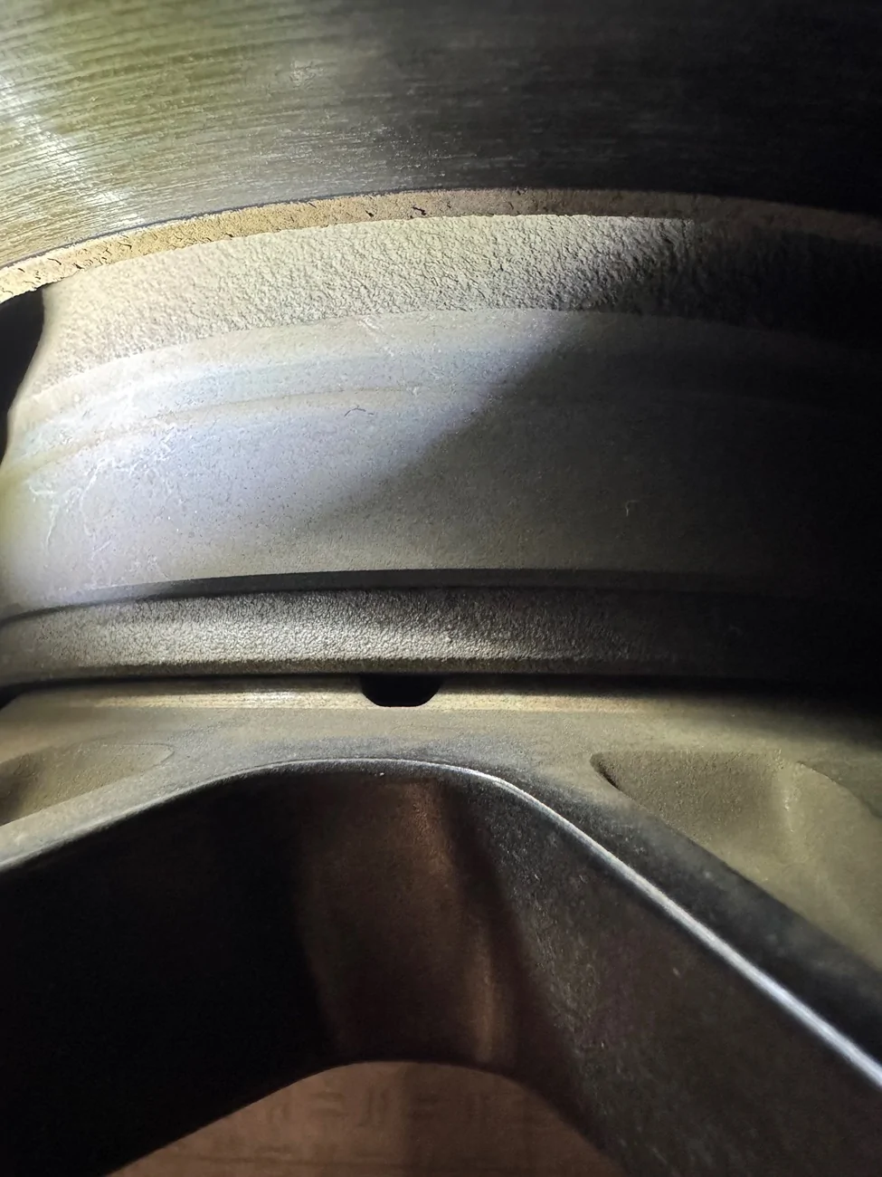

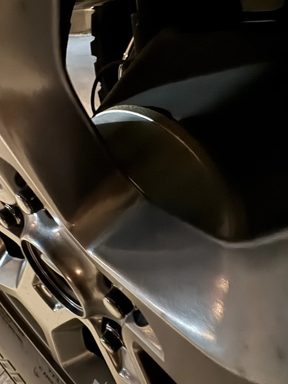

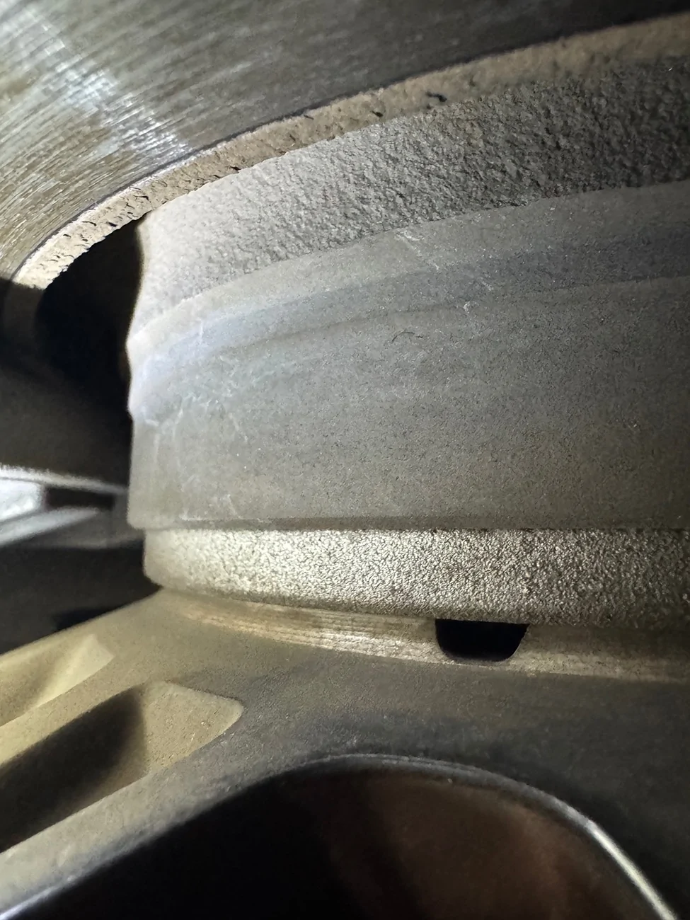

Hi everyone,
I have a 2020 Jeep Wrangler JL Sport that I bought used, and I’m trying to figure out if the previous owner installed wheel spacers.
I can’t remove the wheel right now to check directly, so I’m hoping someone with more experience can take a look at this photo and let me know what you think.
From what I can see, I don’t notice a clear spacer ring, but the gap looks a bit unusual to me.
Does this look like it has spacers installed, or is this just how the stock setup looks?
Thanks in advance!

Looks like a 12mm spacer to me. One hopes that they put longer studs in there, else your lug nut thread engagement may be very marginal.
You need to pull out at least one lug nut and see how much of the stud is protruding, and count how many turns of the lugnut when you took it out. These types of spacers without longer studs are a no-no.

I'm guessing the first picture is the spare, it definitely has a spacer, but I don't see anything on the others, but the close up photo makes it hard to tell out of context.
Yes. These pictures had me guessing at what I was looking at. Because it is a safety concern, if he has that 12mm spacer in the running wheels, he should make sure it is either not there or safe.

You guys are better detectives than me, but I thought the first photo may be a 1/2" spacer as well. That's a huge "danger signal," especially if the drive wheel lugs are stock.

if you look at an OEM plastic bumper a bigger tire on stock carrier hits the bumper and the spacer pushes the tire out enough to clear.not saying it is the best solution or if that is why his has it but I know some do it for that reason.

Do your tires stick out pass the fenders? Or close to the edge? This is another way to check visually. I run spacers 1 3/4 inch on a Sahara and tires stick out past finders
