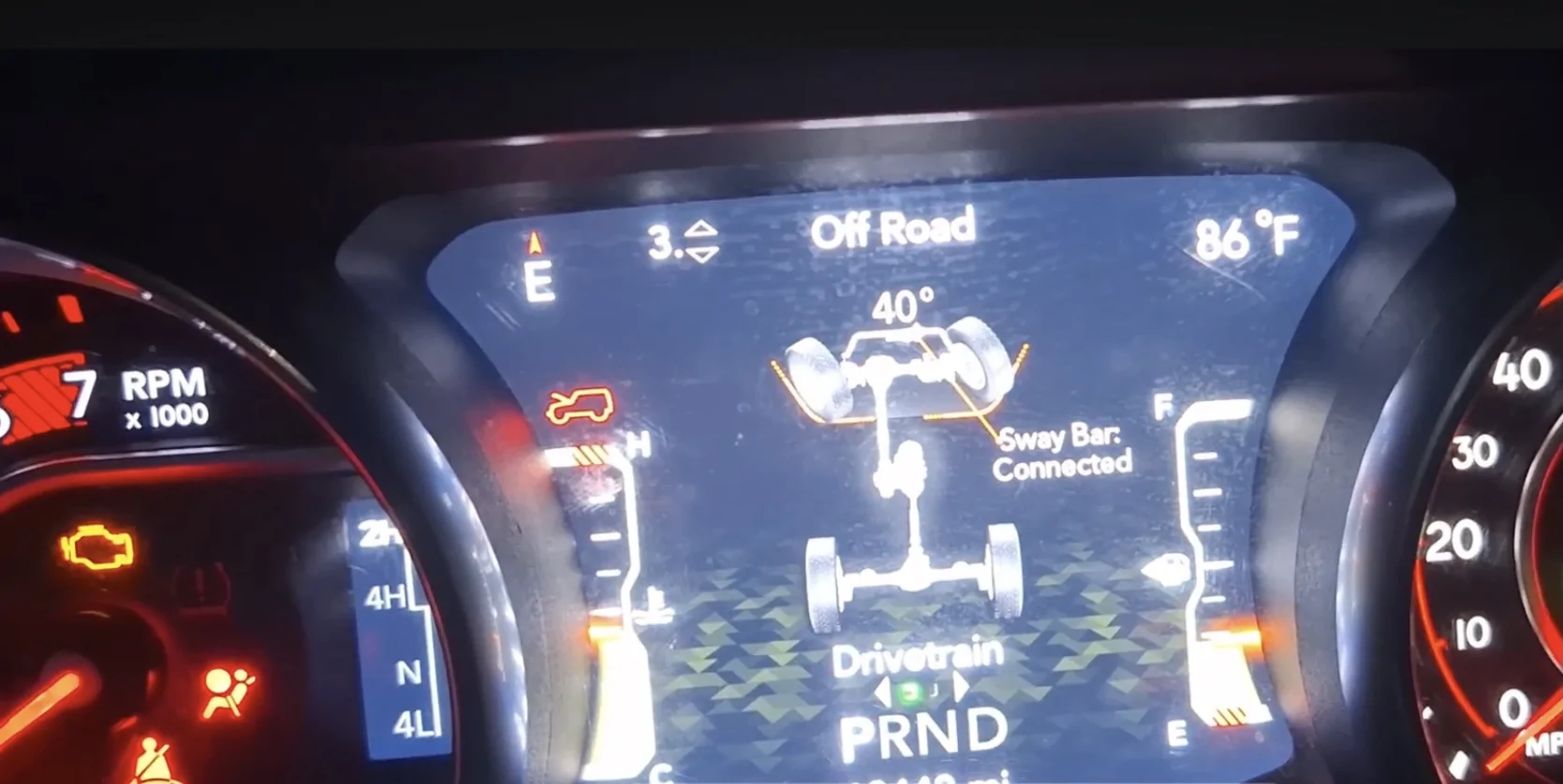

With your steering wheel and wheels straight does the off-road pages image show the wheels turned? I’m wondering if you can use offroad pages images as your trial and error rather than an Autel scanner or whatever its called.
Thanks much Terry. I'll check that now. My bet is the display show the wheels turned and that should give me the direction to correct the issue. 👍

Terry, if you were here, I'd kiss you. It showed a 24* left turn with the wheels straight ahead.
I'm going out there to disconnect the column and rotate the steering wheel one rev to the right.
roaniecowpony
roaniecowpony
Dec 4, 2018
194
12,914
20,422
Retired Engineer
Fixed. Shows 0* and now I just have to clear any code with JSCAN and drive it.
