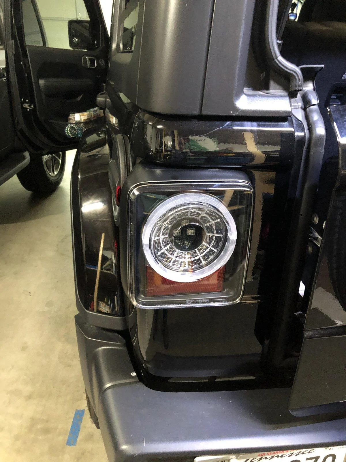

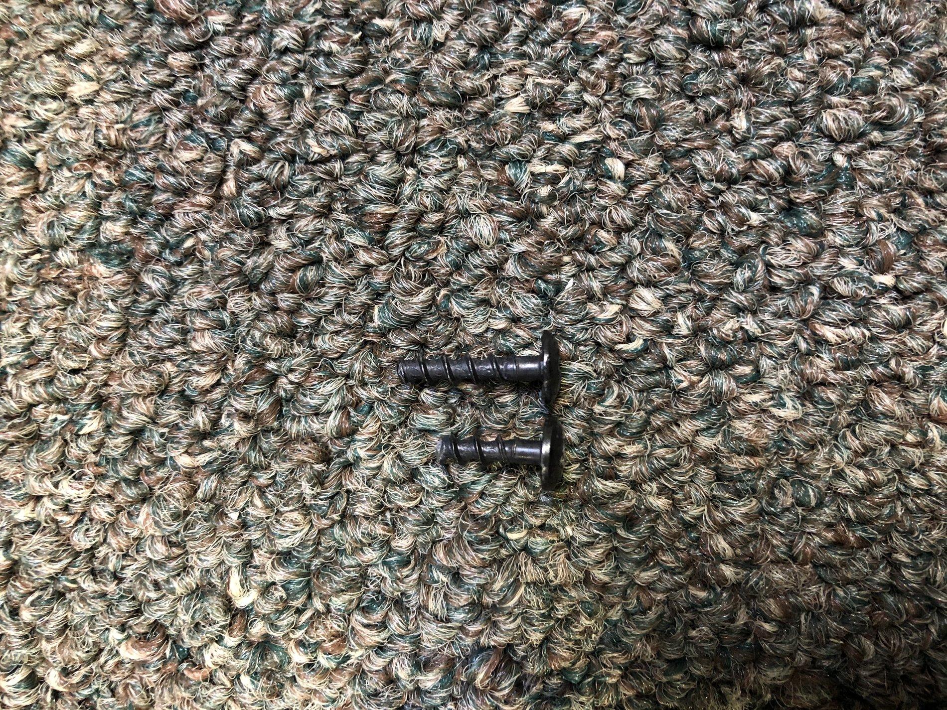

Got mine installed today, just cut off about 1/4 of an inch on each screw, they went in perfectly. I used a pair of 9 inch side cutters to cut the screws.

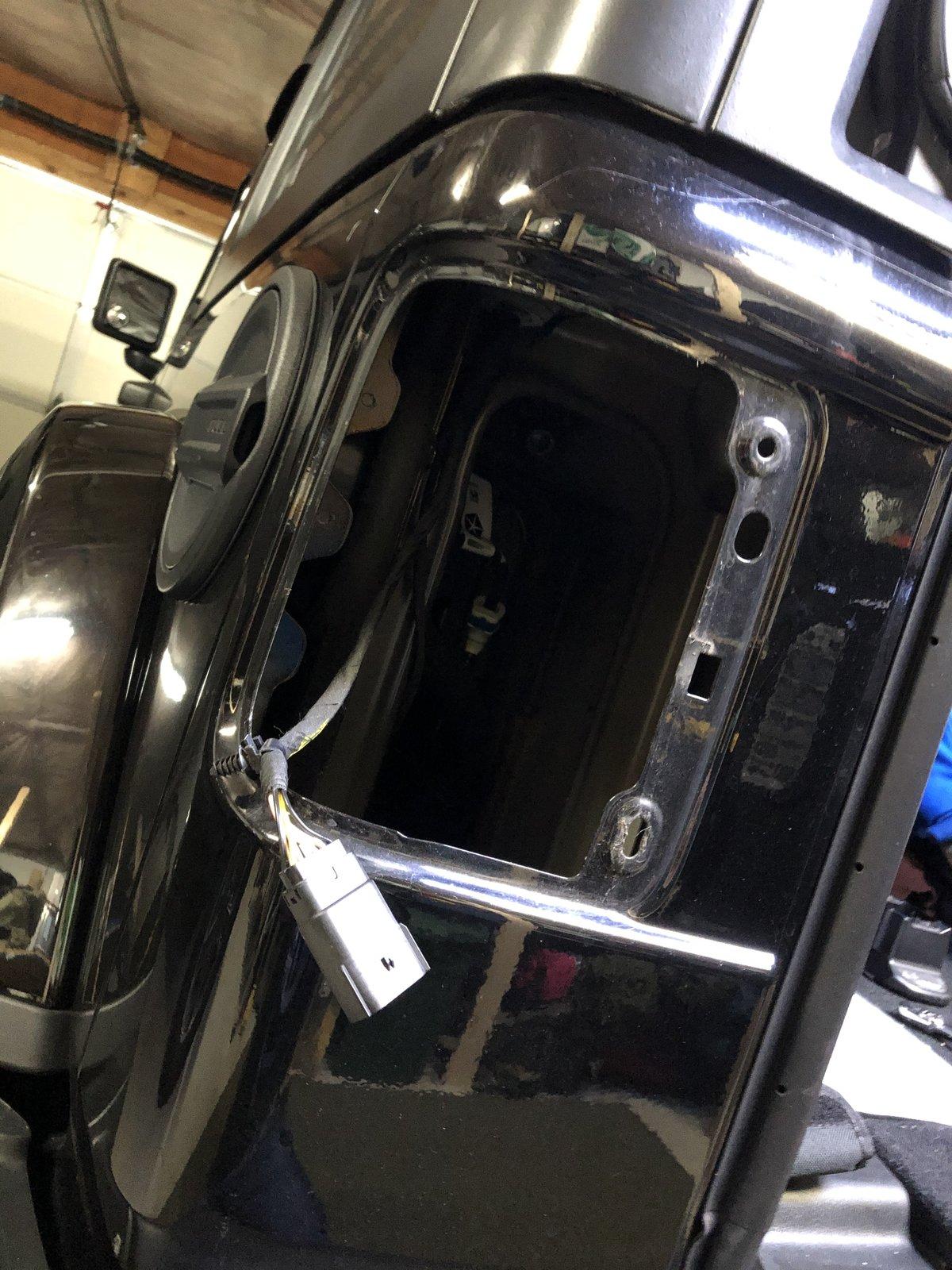

just make sure to double check the connector, my driver’s side was not working at first, tightened up the connector and it worked fine. May want to check it before you reassemble.

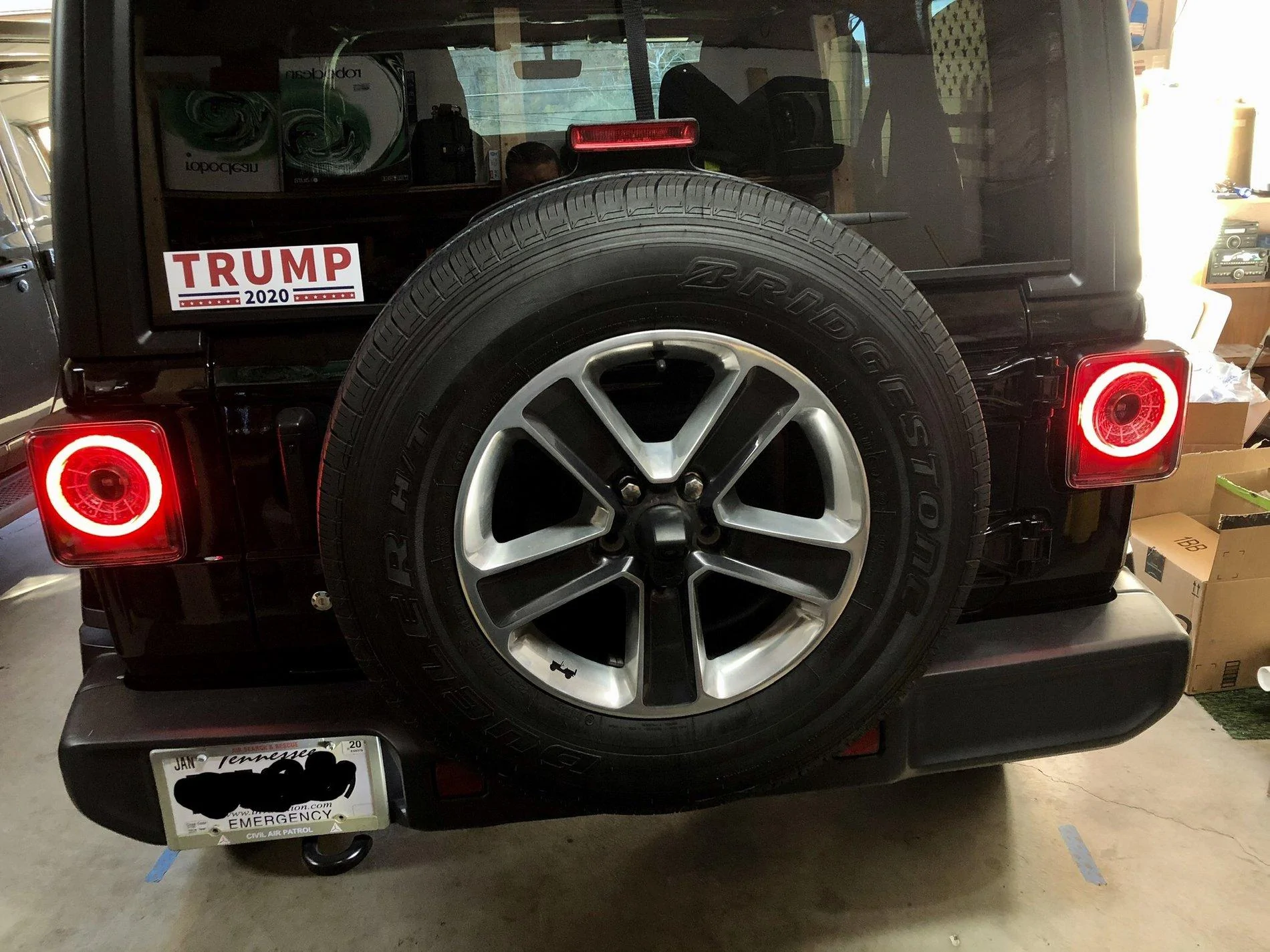

It's okay, my front side windows have been tinted so it's dark regardless... I'll end up adding some lights on the rear bumper to assist with rear lighting when in reverse though. I do love the look of them since I have the halos on the front and the red "halos" on the rear now. :)
