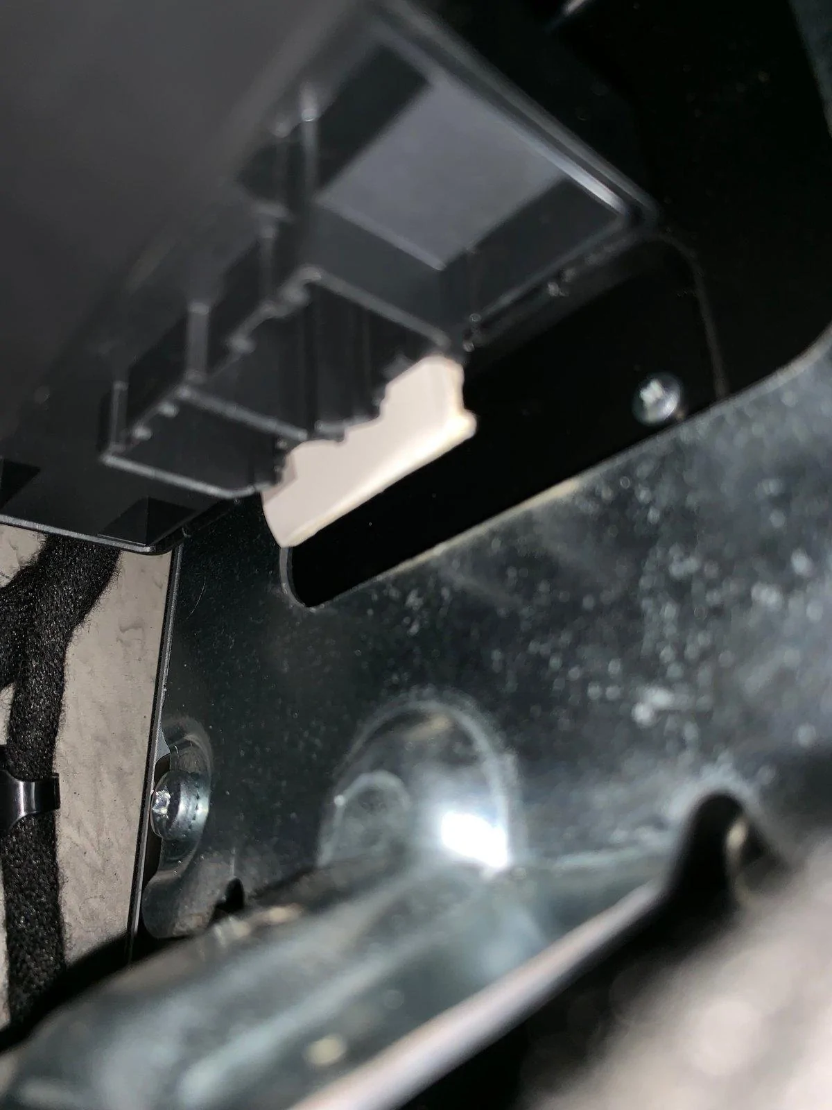

You'll save yourself a lot of frustration doing it yourself. The white thing sticking out in my picture is thin cardboard. Business card would work if you folded it. I went with slightly thicker cardboard from packaging I had laying around.

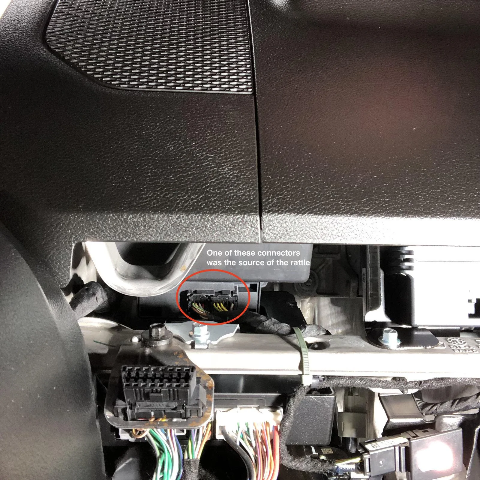

I didn’t have to take anything off. The offending connector and wires to it are just under that lower speaker, behind the trim panel/speaker grill and above the OBD II port. If you’re young (or an old contortionist) you could probably get your head on the floor under there and see it, but I used a mirror. I've included a picture. There are two connectors right next to each other. But in the picture you can also see the zip tie I added to pull the wire to one of the connectors snug (not too tight - just enough to make it quit making noise.) For me the noise was the worst at a frequency of around 145 Hz.
Incidentally, at the time I fixed it I considered that zip-tie a temporary fix. I was thinking at some point I should pull the connector out and see if there is some way to make it fit a bit tighter in its socket (Putty on the side of it maybe?). But then again sometimes my "temporary" fixes end up being in place for a long time unless they quit working...
I don't have any idea what could be causing the bass to be felt through the brake pedal, but at very loud volumes I would imagine it feels like it's coming from everywhere! I used to listen to loud music. Now I try to preserve what little hearing I have left, so if that happens on my Jeep I probably will never find out! ;)
I used this method above ...
Didn't even need to remove the plastic kick plate and just a simple zip tie resolved this vibration problem for me....
