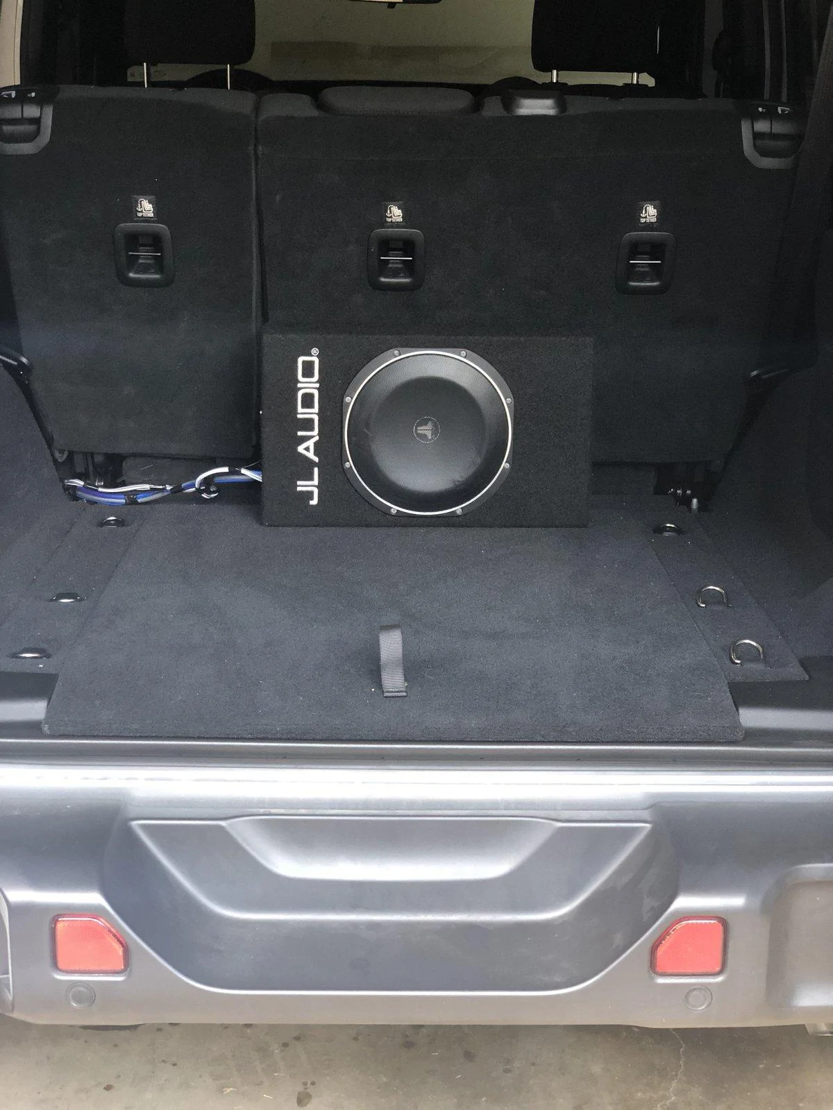

I’m literally doing the exact same set up but I’m just going with the 10” RF powered sub.
Decided on a changing out the smaller speakers in the dash and sound bar with the kickers and a 10” JL micro sub/amp combo that comes with the LOC basically built in because of the DCD technology. Small footprint, easily removable (2-plugs), and sounds great, kids are loving it. I’m very happy for only spending $600 installed. I did run the ground and power by myself and installed the speakers but paid for the wiring from the subwoofer (wired into the speaker wires) because that’s past how much effort I’d like to put in.

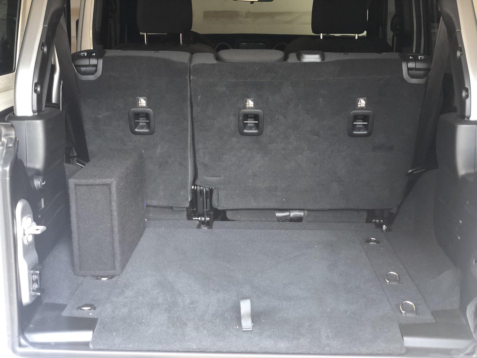

Update: I got the fosgate p300-12 sub installed and it is awesome! For $250 you can't beat this. It's not going to win competitions but it's all the bass I need and then some. I also pulled the speakers out and stuffed the dash and soundbar with polyfil and it cleaned the sound up a lot. For $350 all in, I'm completely content with my stereo now!
I have this subwoofer, transferred it from my CR-V that I traded in to my 2020 Jeep Wrangler 2dr.
Left all wiring behind, so still wrangling all that's needed to have it wired this weekend.
PS, nothing beats a *sealed* powered subwoofer...easy to disconnect, and *real* low end...tight, realistic punch, without exagurated boom that ported subs give you (nothing against ported subs, my ears don't like them).
I've always put the sub on the left side of the vehicle facing the right side of the vehicle...curious why you have it in the middle?

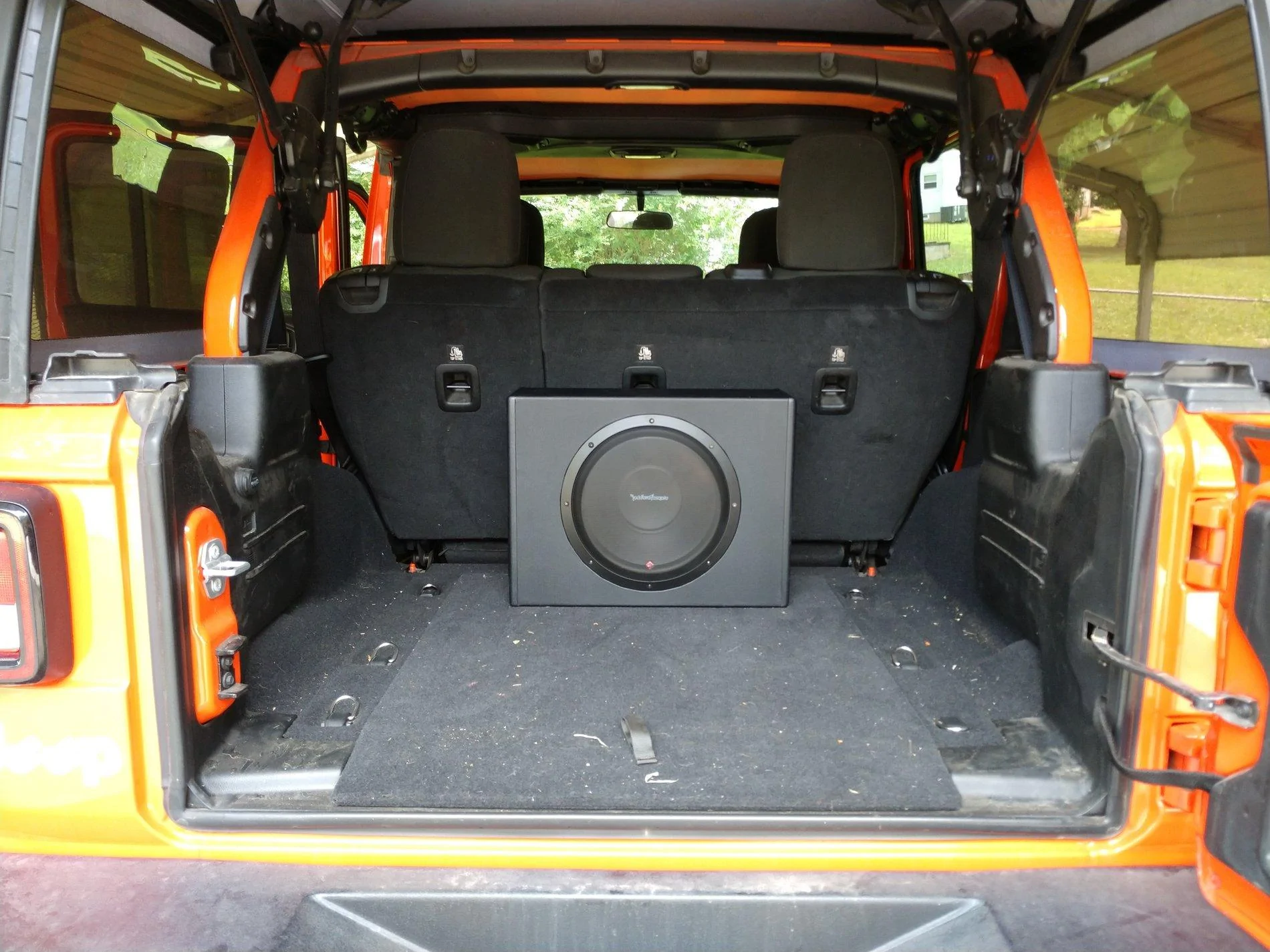

I just installed 4 of the kicker 77kick25ab speakers. Took about 10 minutes and they sound awesome. Great return for a simple $100 investment. Because they give a lot more clear sound, I notice little bits of distortion more where the cheap ones would have kind of hidden it through a lack of sound quality. But after playing with the equalizer settings for a couple days I’m finding the sweet spot and they are great. Way better quality and slightly more volume. I also got a Rockford fosgate P300-12 powered sub (has built in amplifier and is easily removable) that I’m installing this week. For 4 speakers and the subwoofer setup I’ll have about $350 invested for a system that will suit my needs. I May upgrade the remaining speakers and get them all amplified later but for now I’m happy. :like:
Just ordered 4 from BAM -- hard to beat $100 for 4 speakers if they're better!
