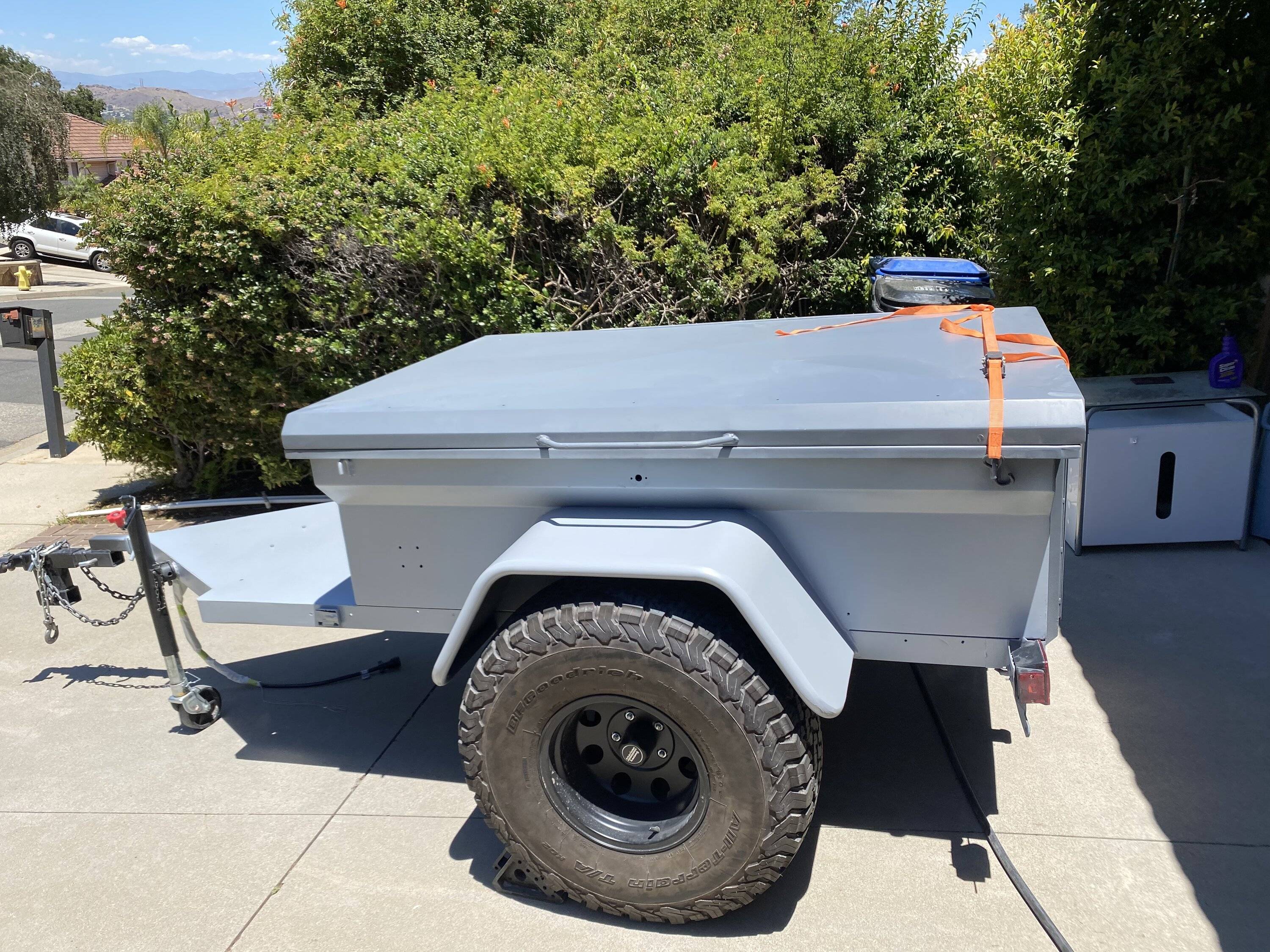

You can change the spindle to be whatever you need. I believe they have the Jeep 5X5. I run 35’s on the Jeep and the trailer but the trailer has 15” wheels which means I can run the Jeep spare on the trailer but I can’t use a trailer wheel on the Jeep.

I guess. I have 5 on 5 on my 3500# axel and I can't imagine breaking the spindle on a 10 ft trailer. I considered going with the Timbren 2000 pound setup, I doubt I would exceed that weight unless I put an 1800 pound horse in it, but putting the same lug pattern on the trailer as the tow vehicle makes a lot of sense. There are a ton of 5 on 5 and 5 on 4.5 toy haulers that must have a GVW of at least 6000 pounds. I guess you either have to carry an additional spare or find a different manufacturer who can provide the lug pattern you need. I just don't have the space for another spare.
