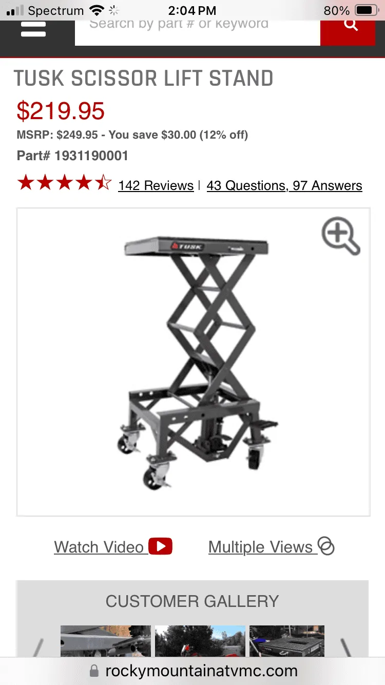

Here you go Scott. Throw one of these in the back while traveling. Just roll up, spin, straddle, lift just little and set on lugs. ??
That's genius.
Long long time ago tire/wheel weight freaked me out. Mercedes 450 SL. With their awful wheel bolts. I could just see myself trying to change a wheel on that car on the shoulder of the road in my commutes to Northern Ontario.
Now I have a spare set of brand new wheels and tires for the Rubi stored in the basement. And I'm a new heart patient. Stock K02's on stock rims.
So I'm open to ideas.
