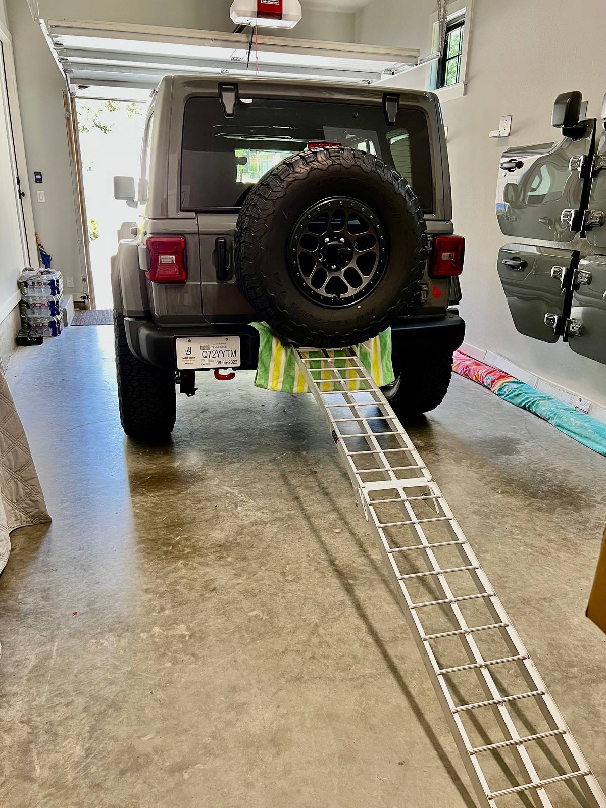

Here you go Scott. Throw one of these in the back while traveling. Just roll up, spin, straddle, lift just little and set on lugs. ??
Jeep Wrangler JL Spare tire hoist? IMG_0319

My tire/wheel combination weighs close to 115 lbs. Awkward as hell. At 68, I'm just looking for a solution that doesn't involve my back being f...kd up and I end up eating red jello earlier than expected.
