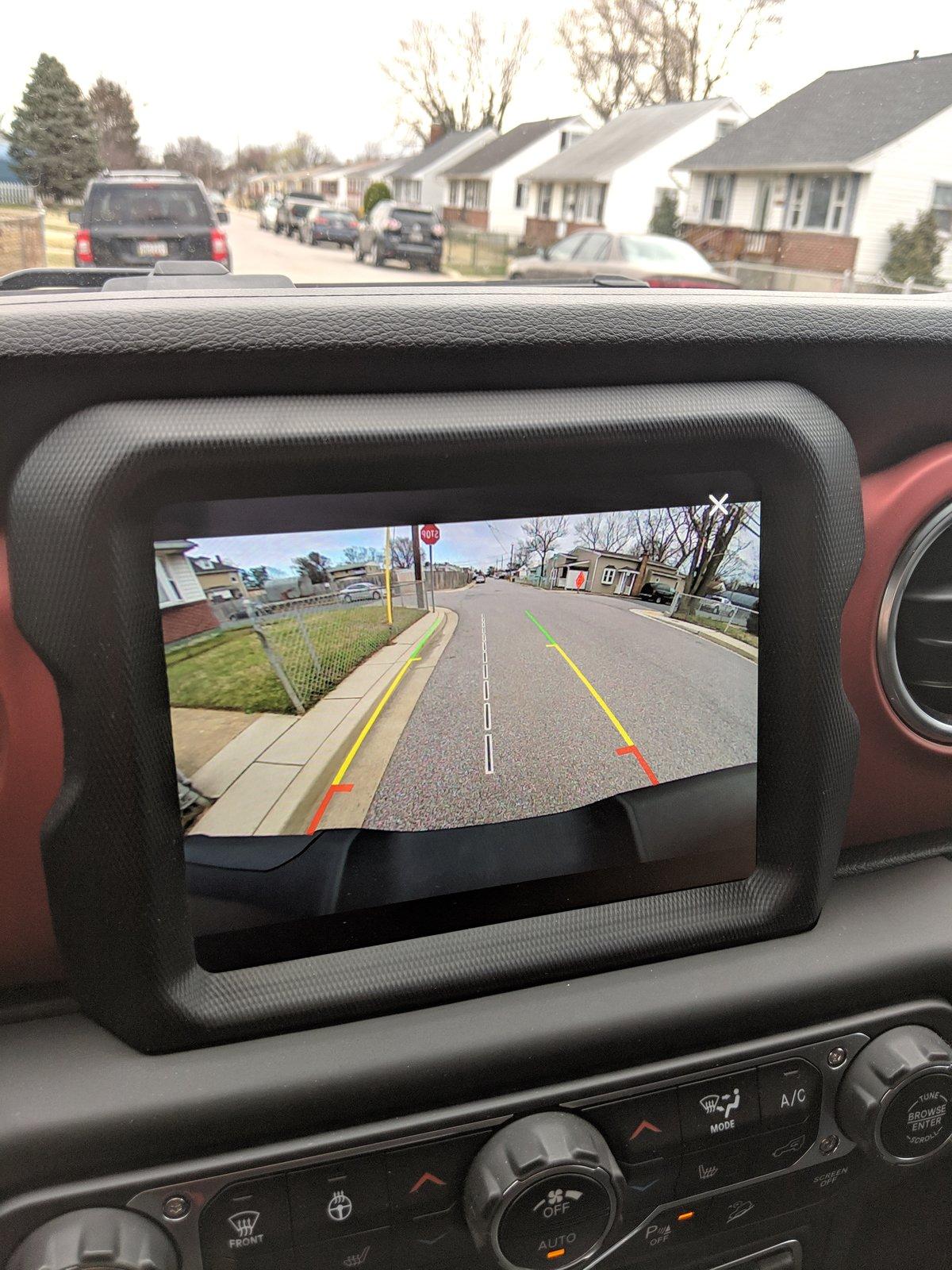

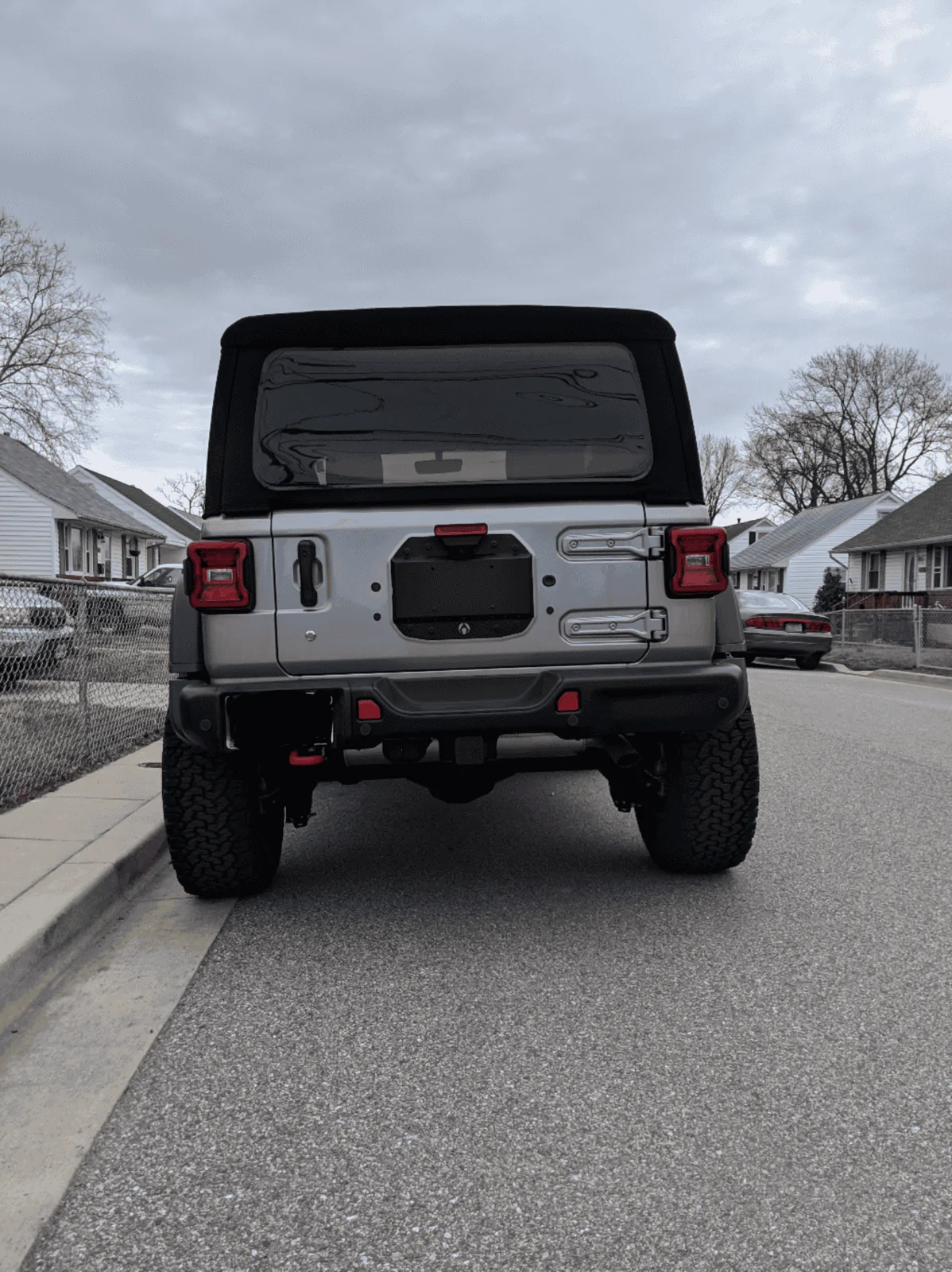

I'm going to install @Artec spare tire delete and add an all black Jeep license plate b/c I'm keeping my tag on the OEM steel bumpers. I'm waiting for the weather and time to install. What I like about it is the correct height and angle of the camera, the use of the OEM brake light, the aluminum and its compact protrusion from the tailgate.

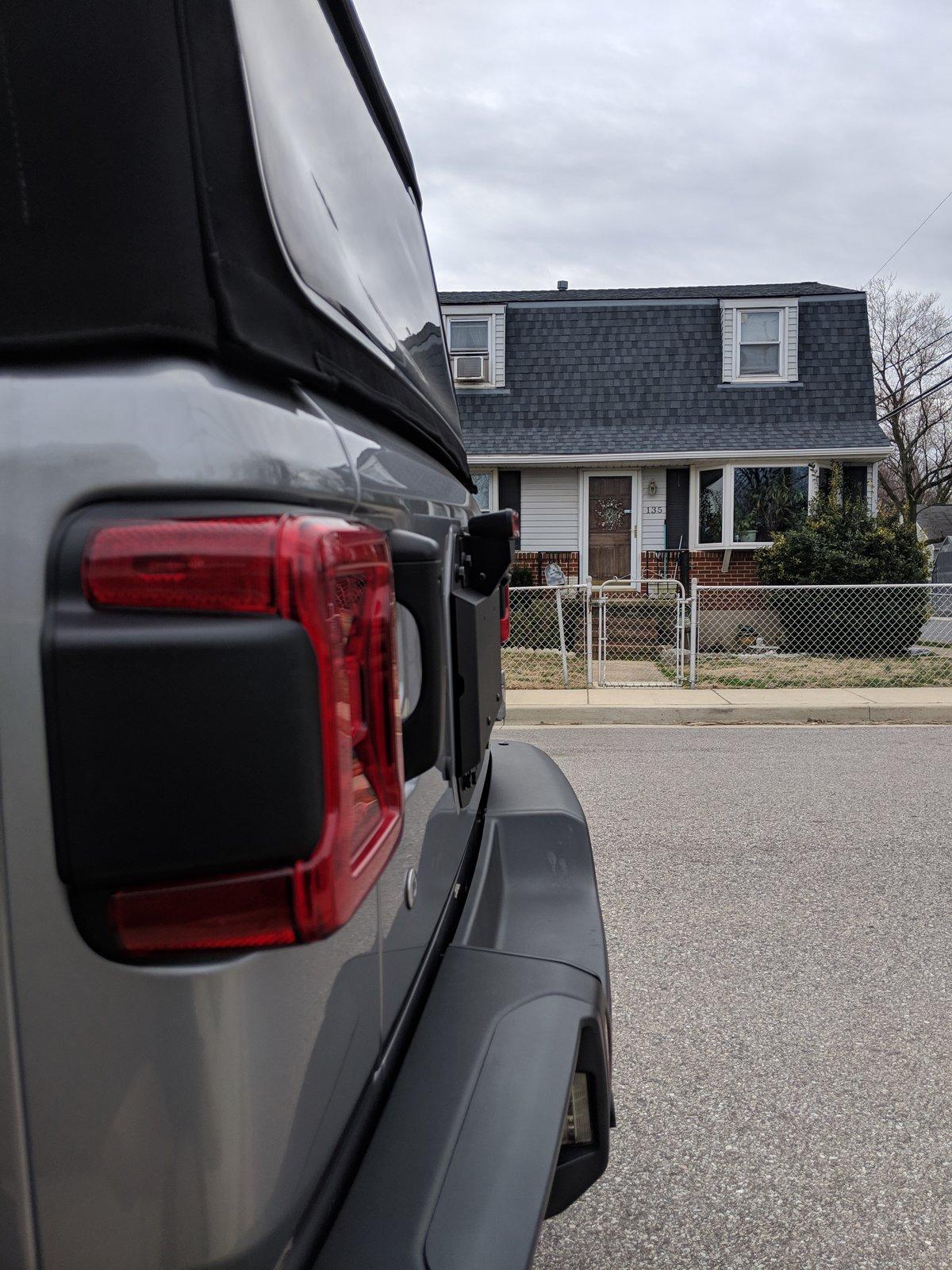

I finally got the Artec Spare Tire Delete installed. It was pretty easy. The use of the stock brake light, camera angle, aluminum material, and clean look make me think this is the best option available. It even looks finished without moving the license plate or adding a decorative license plate.
Very nice! I did one of the first Ace installs, this looks way better than mine. Much better camera angle, too. Congrats!
Question: Does the tail gate vent still have enough airflow to equalize when doors are closed with windows up? Hard to see vent holes in the fabricated piece

The air vent does indeed have enough airflow to equalize cabin pressure. I’m still running without the interior tailgate trim piece (I’m waiting for a wiring failure as I later move the license plate and corresponding wiring with LED light bolts from Rugged Ridge, lol) and can see the white flaps open and shut. The delete plate itself has holes on the bottom edge, a wire hole on the side, and small air gaps on each side (the sides of the plate don’t sit flush against the tailgate like the top & bottom do) to allow free air flow.

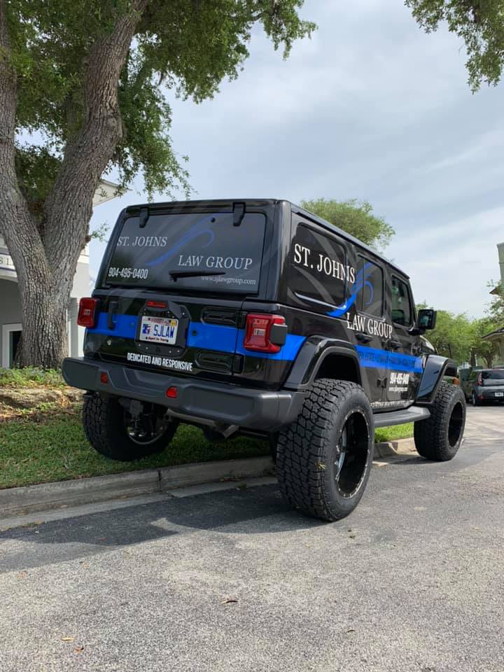

I used this one: Body Guard Spare Tire Delete www.bodyguardbumpers.com/18-Jeep-JL-spare-tire-delete
I do not recommend wiring per the instructions because it taps off the right rear brake light. Since you need to unplug the harness for the OEM license location, I tapped into the factory harness and ran power to the new location. Also, the Body Guard kit does not specify that it comes with LED lights for the license plate but they are in the kit and work great.

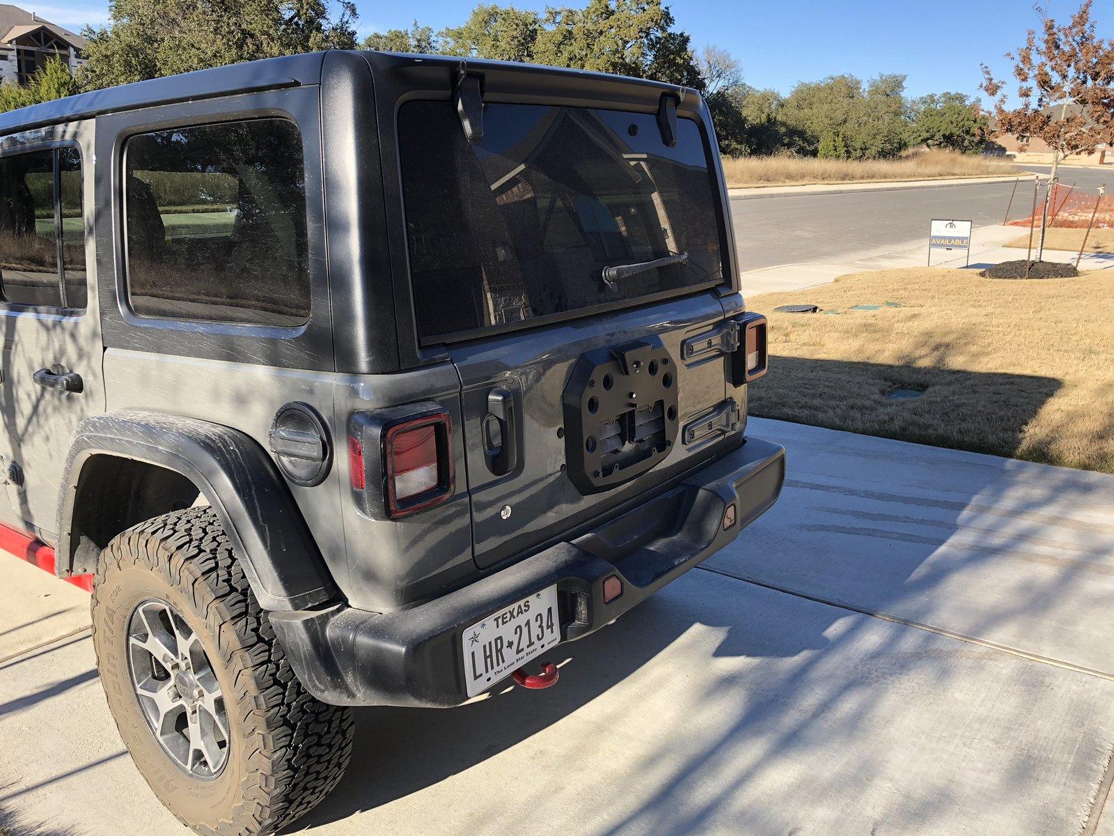

I'm going to order this as well if my factory wheels sell. I just don't trust my heavy wheel/tire combo on the back, and I'm sure with time there will be a rear bumper or carrier I like available.
Let us know how the factory camera needs to be modified to fit.
What rear bumper delete is that?

I'm currently trying to assess this situation. I'm the phone with ace engineering now asking about their "JL Gatekeeper" because I'm lifting and going 37s and I don't want to mount a 37 on the tire carrier. I'd rather just wait til DV8 launches their tire carrier. This is ace engineering's product.
What rear bumper cover is that?

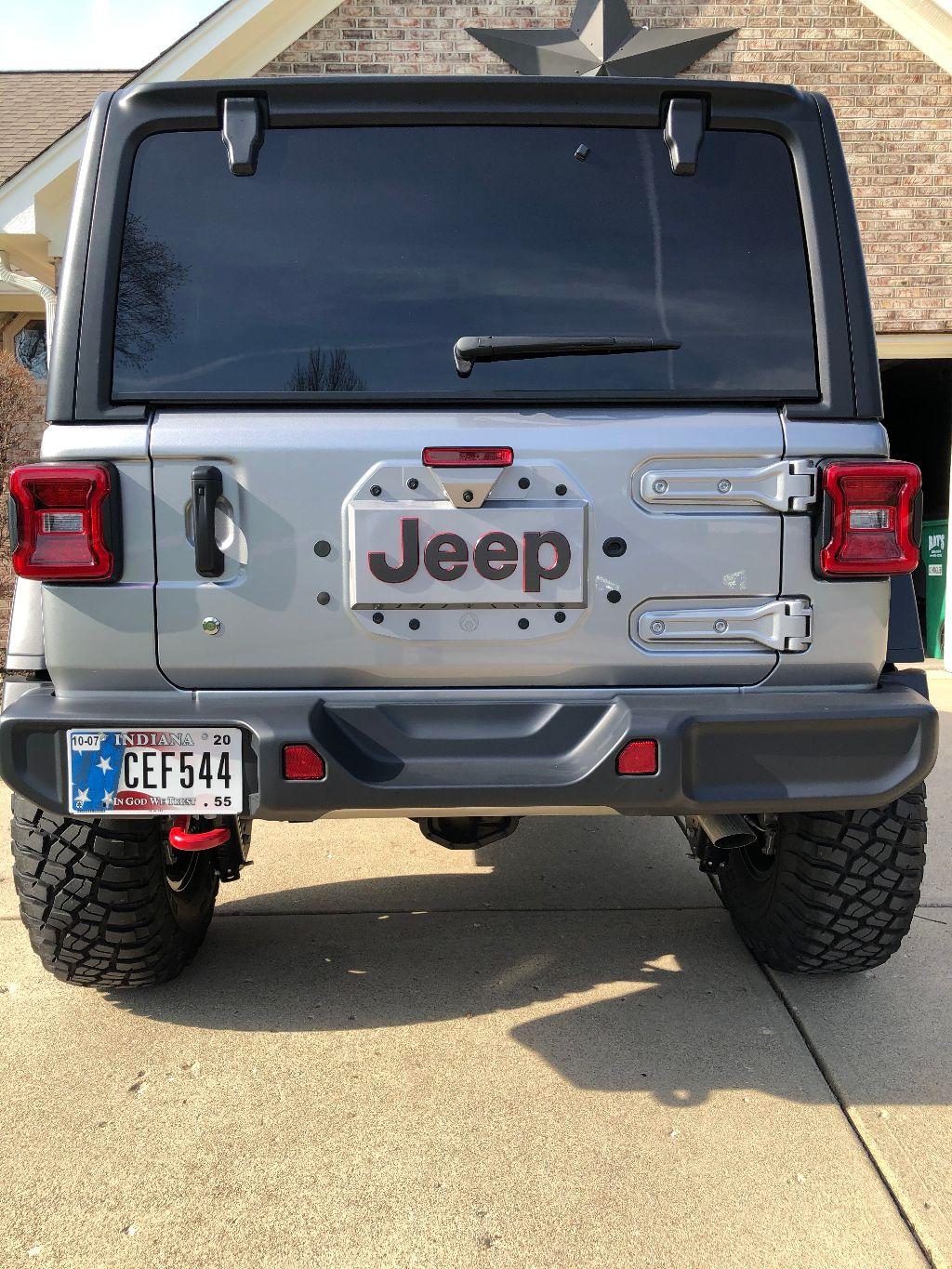

Love this Artec Industries rear tire delete. Back up camera works great and gives the rear a nice custom look!!
