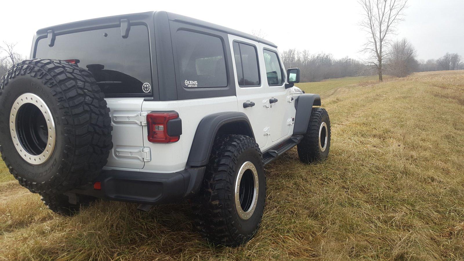

I have a 37 in tire on beadlock wheel mounted on the stock back tailgate. You may have to extend the tire isolators. This is easy to do. I used three hockey pucks, drilled holes through them. I pulled the stock isolators out of the tailgate, cut the rubber nub off. Then ran a 5 inch bolt through the isolator and through the hockey pucks Put a well nut on the bolt and then attached it to the tail gate. It is very solid and does not move around. You may not have to do any of this. I am just saying. It may not be necessary to buy all that other stuff. I will add a different bumper/tire carrier as soon as the one I want is released.

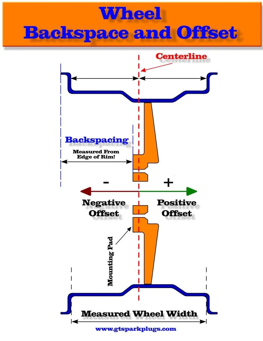

Actually, that is incorrect. a 0 offset wheel on a 9 inch rim is actually a 5" backspace. when you measure wheel width, you are measuring inside the wheel where the tire sits. Backspacing accounts for the inner portion of the rim.
a Negative 12/13 would have a 4.5" Backspace
Here is a sample pic of offset vs backspacing.

So can my new wheel and tire combo (20x9 fuel assaults with 305x55 tire fuel gripper at) fit on the stock tire carrier with no issues? I was thinking about purchasing the mopar mounting bracket if needed.

Thanx Mojito JLUR--crap I forgot about the mounting diff.--4.5 to 5" BS is probably OK for Fzaino1 wheel--
I told him to try the sp-atre anyway to MEASURE THE BUMPSTOP DIFF.-
