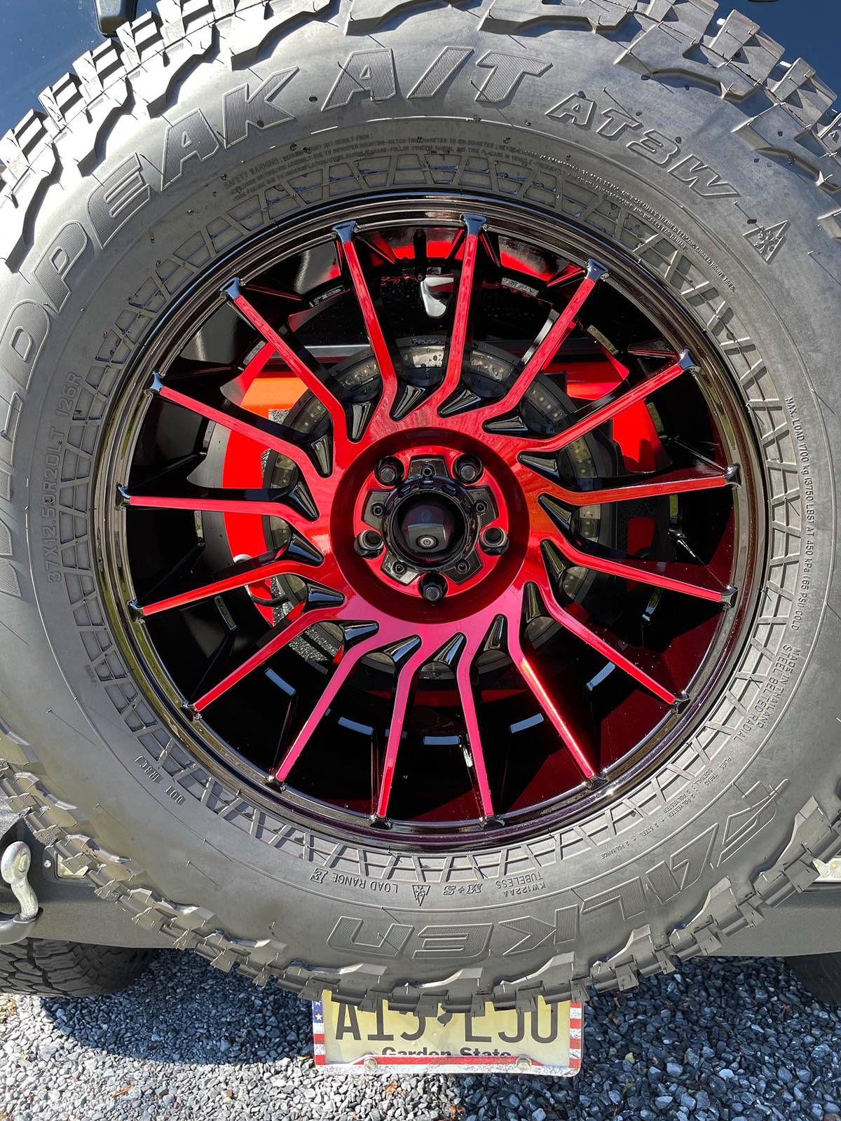

Yes camera cover fit until I upgraded wheels and tires. I had to do the splice because mine was an $20 Amazon find with 12”of wire coming off the ring. Plug and play would have been much easier.
Jeep Wrangler JL Spare Tire Brake Light IMG_4623
Nice wheels.
