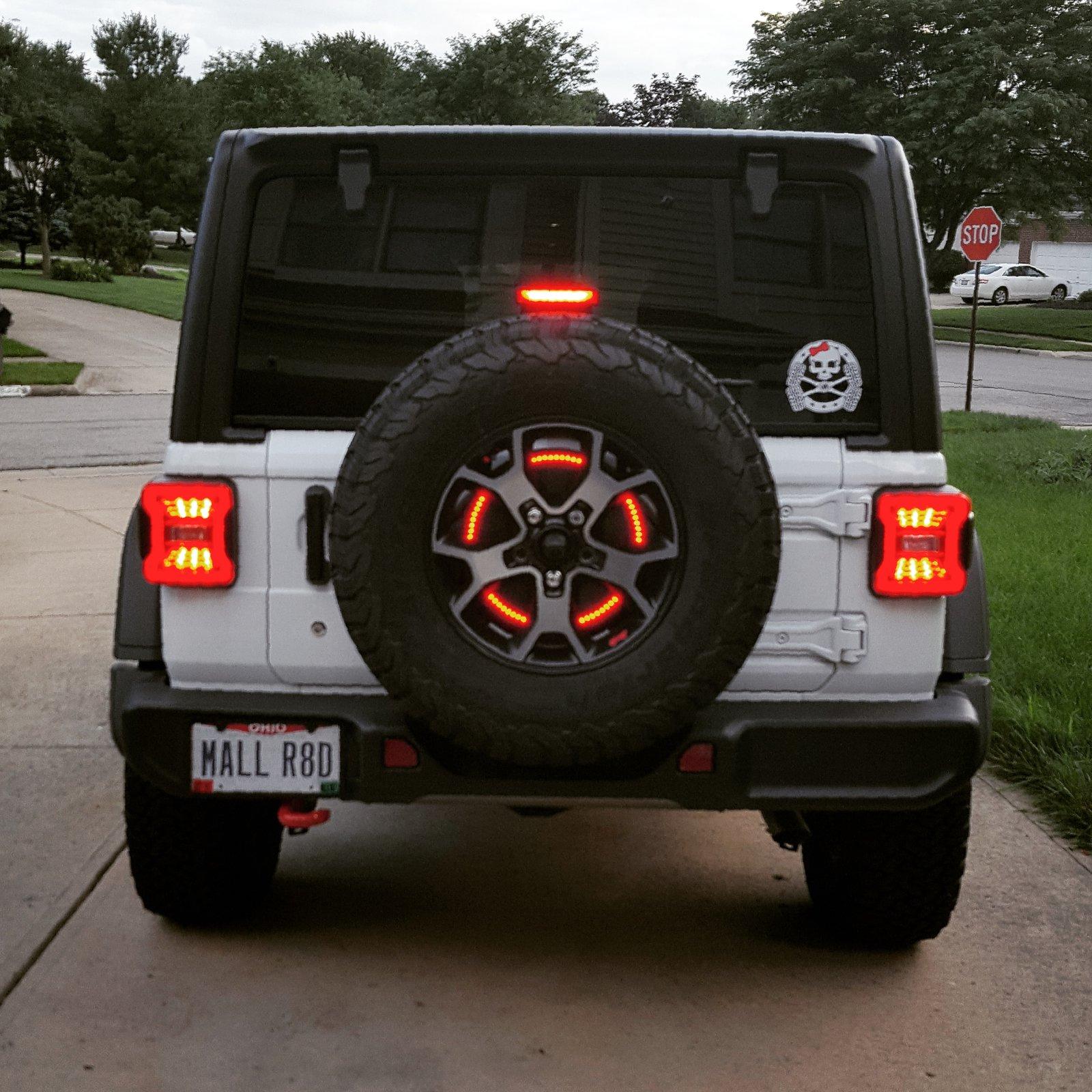

I installed the quadratec with the y adapter today. Took me 20 mins and only tools needed were a t-25 bit and a tire iron to remove spare. No cutting, splicing, tape. Plug n play.
Jeep Wrangler JL Brake light inside the spare tire? 20190917_195500

Quadratec finally started shipping theirs. Was on backorder for a while.
Got mine today as well.
"Y" connector makes it truly plug-n-play.
Works with brake lights only.
