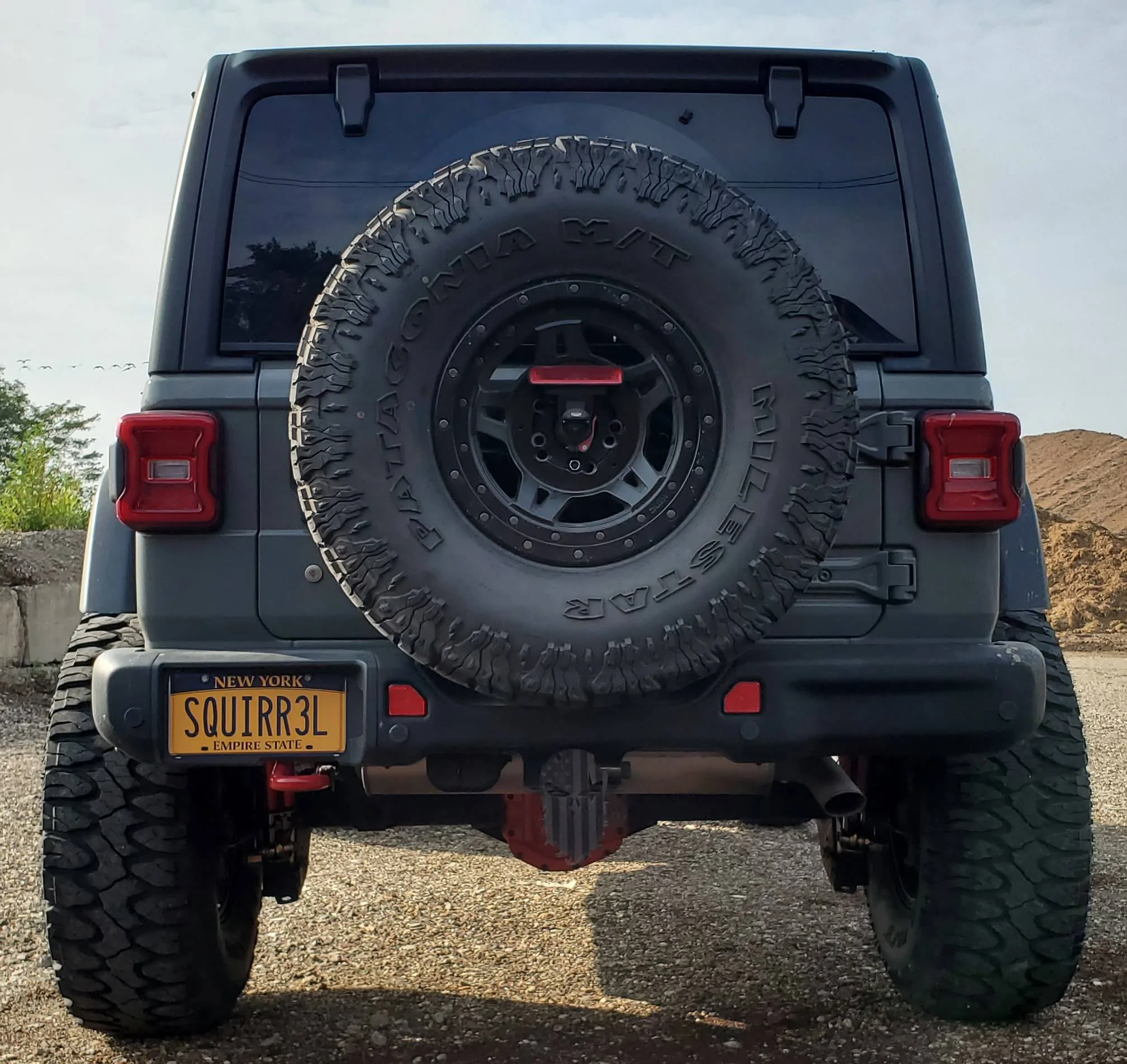

If we're definitely speaking of the Teraflex Alpha HD adjustable carrier, I assure you it'll work. Unfortunately, I don't have side shots to show it pressed into the tailgate bumpers. Here's pics of both the stock wheels with 315/70-17 bfgoodrich ko2's and than readjusted to accommodate 17x9 wheels with -12mm offset wrapped in 38x13.5's. The carrier still had more inward adjustment range left. I'll try to remember to pull that carrier out of storage tomorrow. I can take a pic of it, as it's still adjusted for the negative offset spare.
