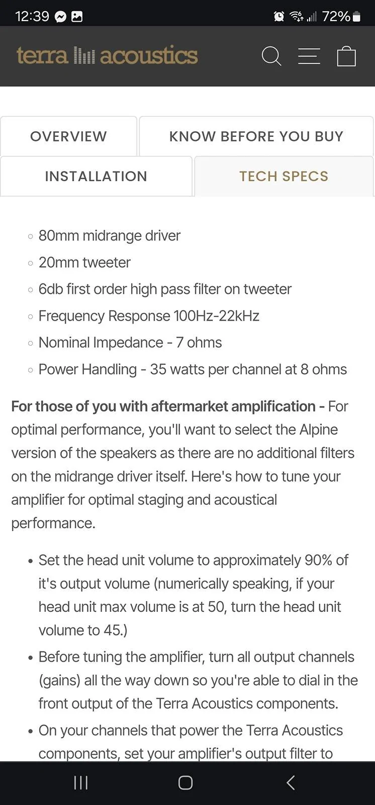

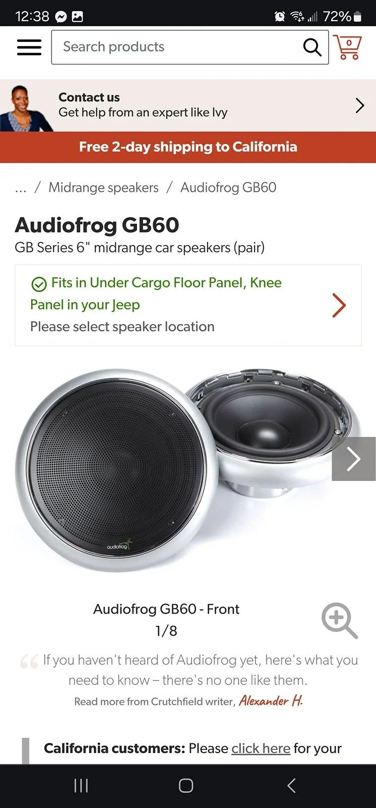

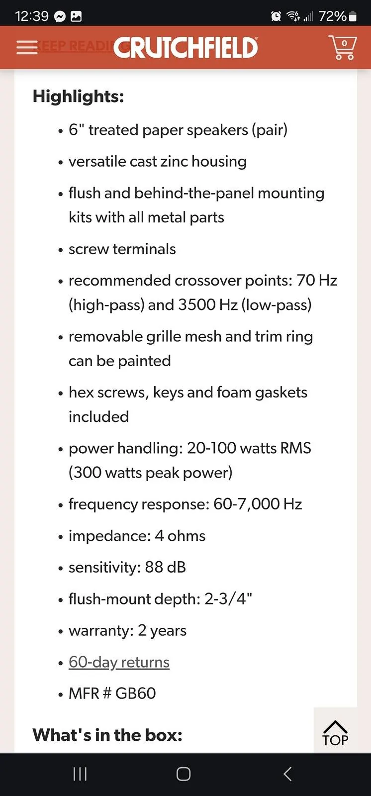

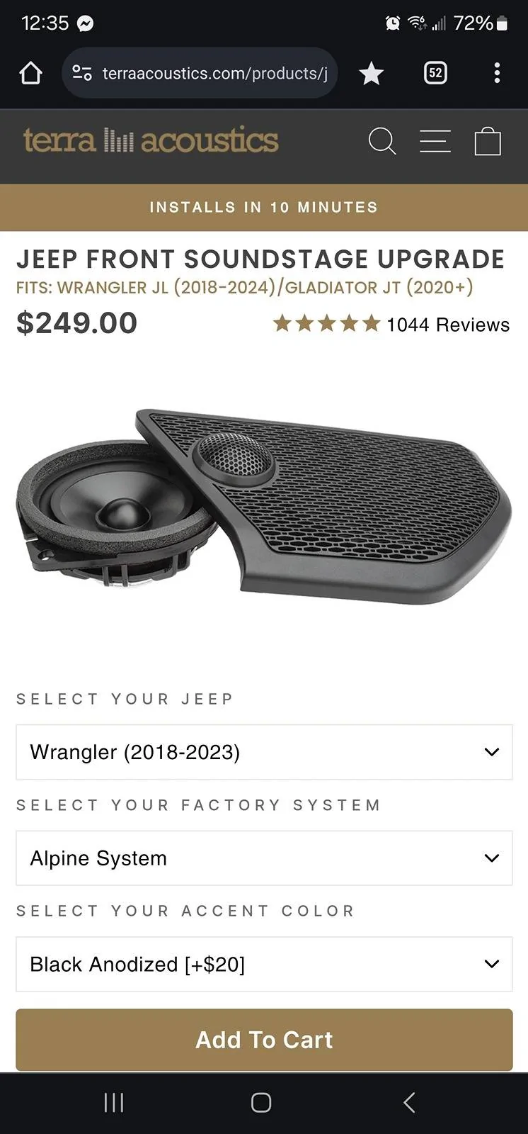

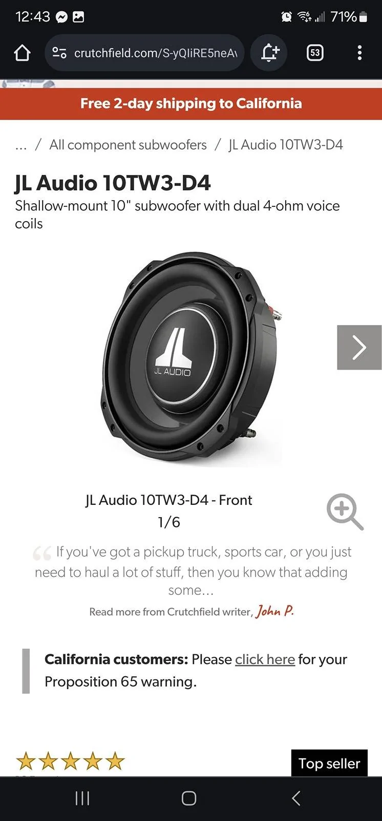

Hopefully this is in the right area for this topic.
I have a 2020 rubicon with the upgraded sounded system.
I'm not a fan of it. The sound is more than decent, but volume is too low, and not much treble.
I came across these items and wondering what amps and dsp are needed to power these.
I'm not great with electronics, but can at least wire properly with solder and shrink tubes.
Most of it, I'll probably pay someone to install.
I plan on leaving roll cage speakers stock, for the time being.
Just dash corner (pillar), knee panel, and factory subwoofer speakers will be replaced.
The speakers I've chosen, are likely to fit. I just don't know what amps/dsp are needed to make this sound very clean, rich, and also louder than stock.
Terra Accoustic (made for jeep JL). Is a component, mid and tweeter.
Audiofrog gb60 is a woofer.
And JL shallow mount subwoofer.
Can 1 amp do all of it? Or need separate amps?
Is DSP needed?
I plan to keep stock 8.4 headunit.

The Terra Acoustics are fantastic They look top notch installed too and easy to drop in, the packaging is nice and very well made. A huge difference in mids and highs. Acoustic Stuff was added to the sound bar behind the speakers which helped round out the missing mid range.

I had them on previous jeep, while sounding nice, they didn't get loud enough. Wondering if better amp would help, or if they would just get blown out/distorted.

They sound pretty loud in my 2Door, they've made revisions to the speakers as well. These are considerably louder than the Alpines. Their break-in period was followed as well and they sound better after the break in period.

The closest I've heard from car audio that matched high end home stereos, was Audiofrog. But they are expensive, sometimes need custom enclosures, needs a quality DSP, and has to be tuned for your jeeps internal space.. wish I had the money for that. Been quoted over $10,000 for a 3 way component system with a 10" subwoofer, parts install and tune.

Just wish the Terra Accoustics offered a set that can handle a little more watts/power.
