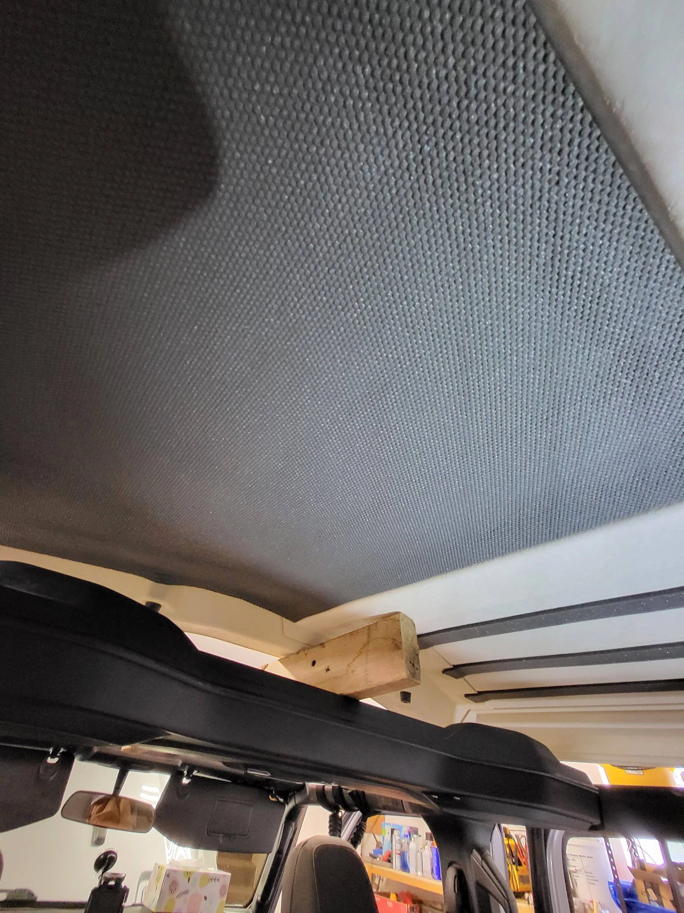

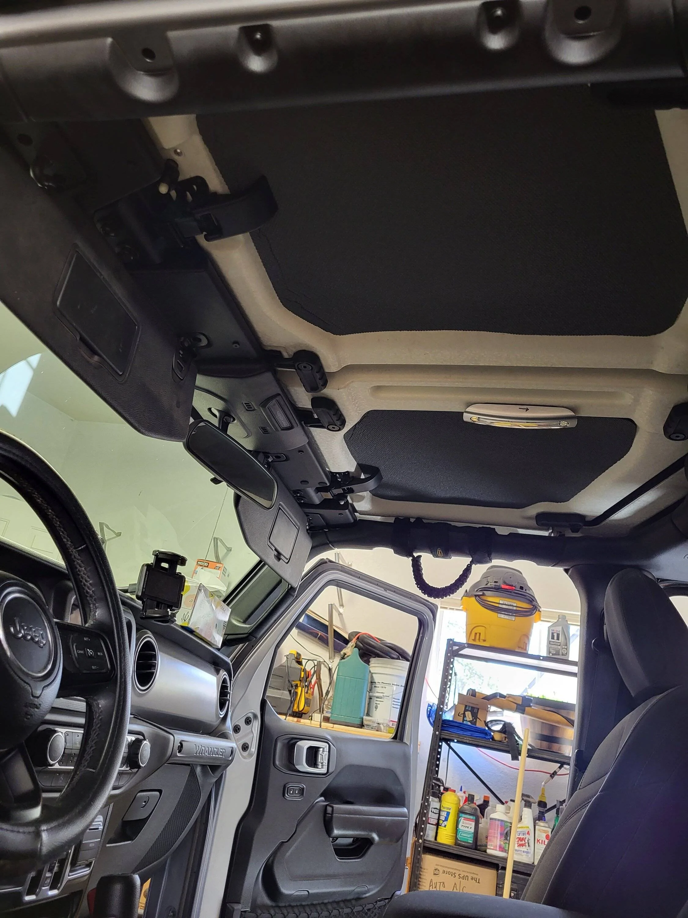

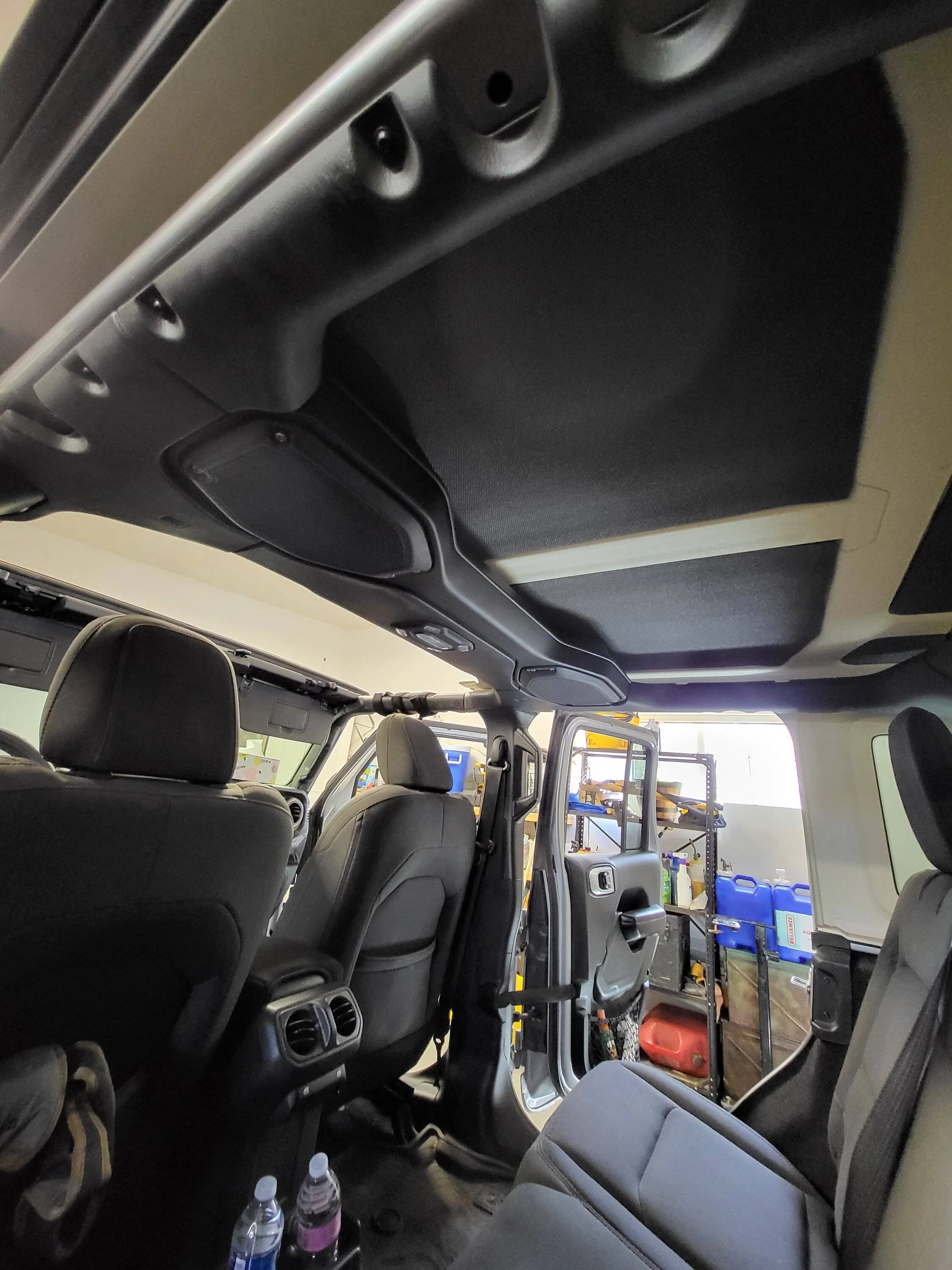

I went with Cover King. I installed sound deadening first then, installed the mat with supplied double sided tape and I added Barge multi-purpose cement between the recommended tape. It made a huge difference in acoustics and hot/cold temps on the interior. I've had it installed for over a year with no issues.
