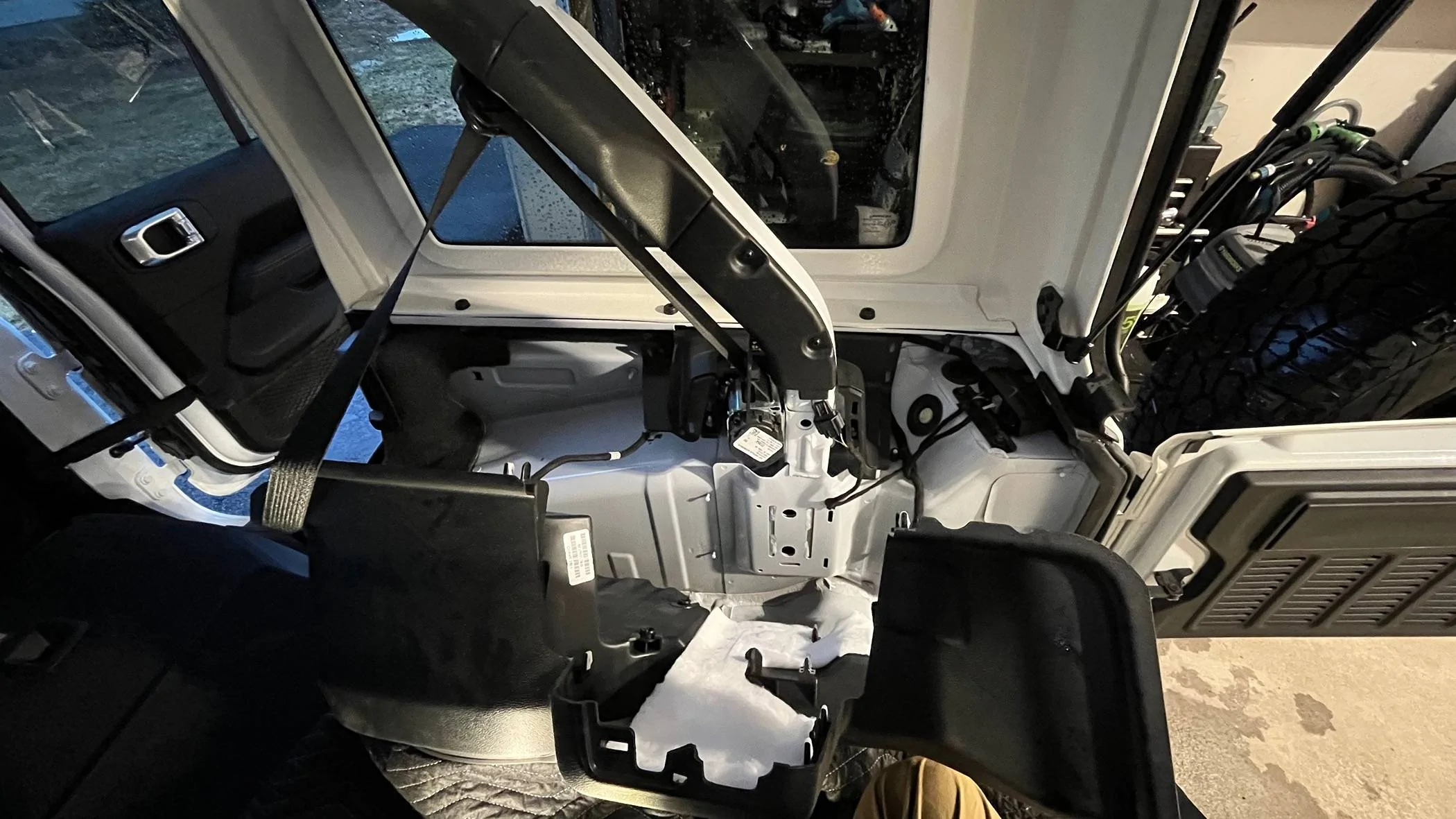

It sounds like the noise is coming from behind the rear passenger side cargo panel. So I YouTube’d how to remove it and decided to investigate.

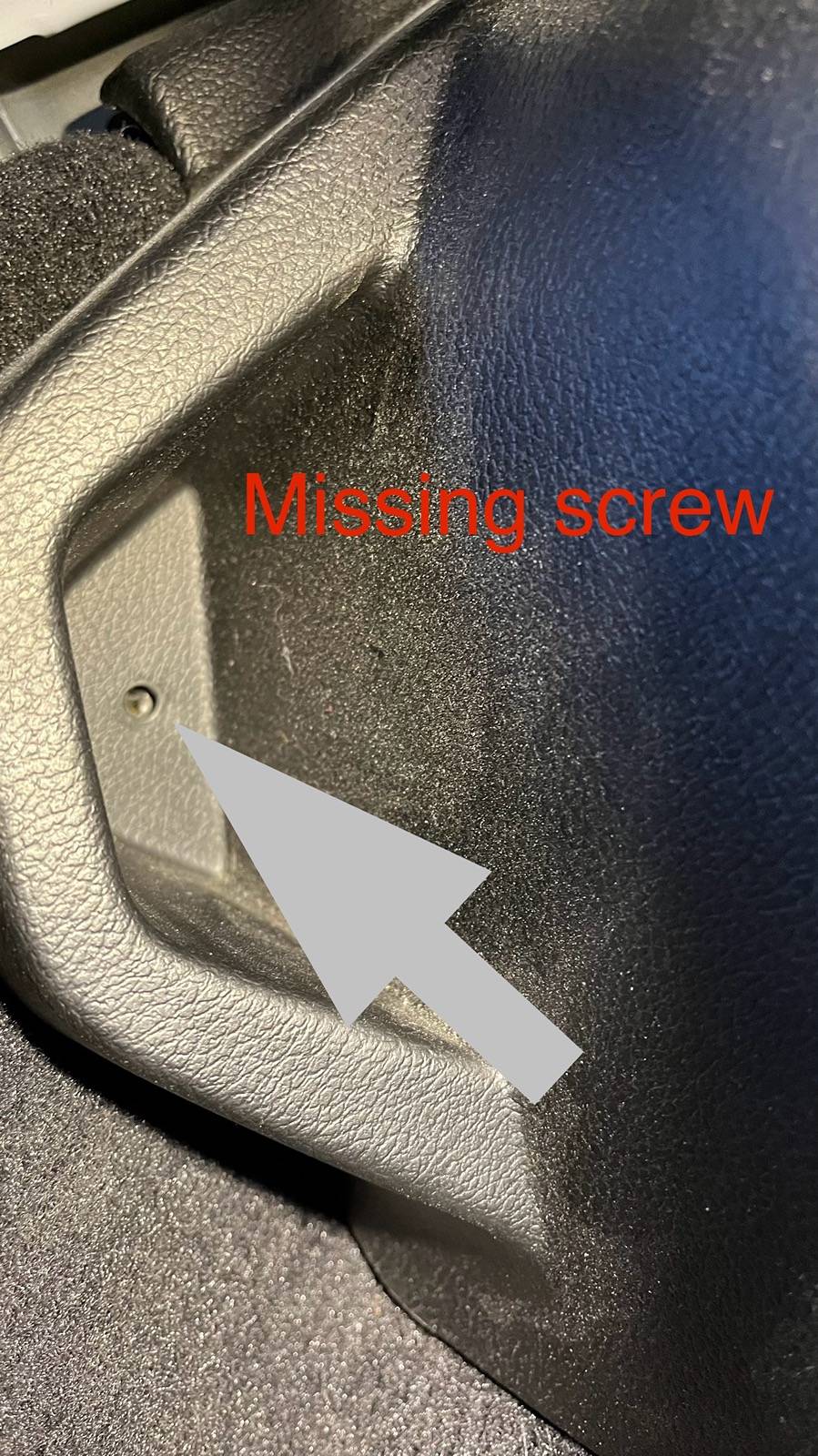

First off, whoever took it apart during the rear gate hinges getting painted, didn’t bother to screw it back in place. The T20 torx screw was missing. (I believe unrelated to noise). Once apart, everything seemed in place and there was nothing obvious that looked like it could cause such a noise.
Standing outside the Jeep, you can still hear the noise but only faintly.

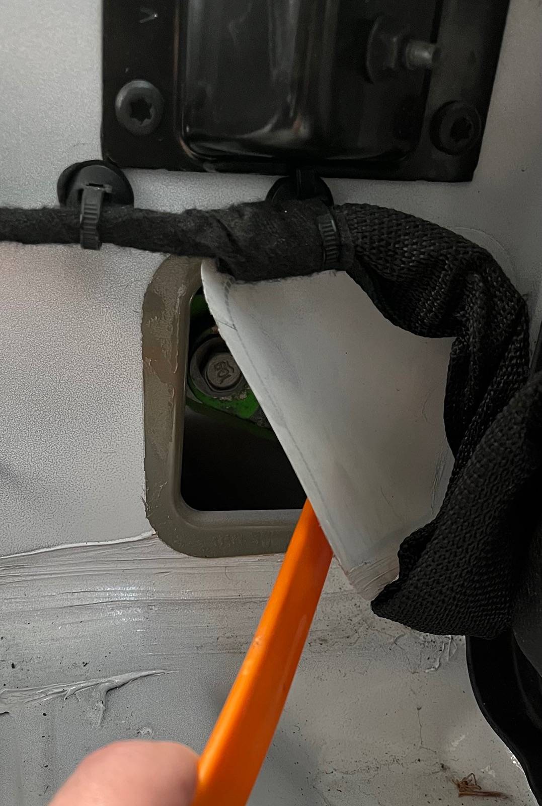

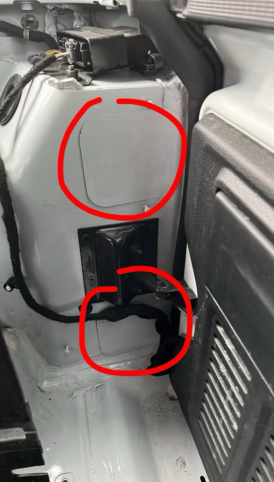

I figured it out.
Morons at body shop who did corrosion repairs took the tail gate off. The access points are covered with a thin layer of plastic glued to the metal.
They didn’t bother sticking them back down and they were flapping inside.
