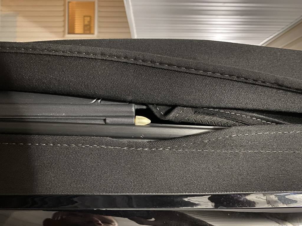

I’ve got a 2 week old 2024 Sport S 4xe with a soft top. I tried to remove the soft windows today and noted the back right one was not sliding off easily. I noted that it had halfway come off the track at the top. When I put it back on, it slides alright, but when I hook the latches at the bottom, it pulls the top little track guide off for the first 3-4 inches. Any idea how to fix that?

I tried holding it in place while my wife secured the bottom clip, and it still popped out. It doesn’t harm things while driving, but the window is not secured at the top, is hard to remove, and I worry it’s just going to get worse if not addressed.

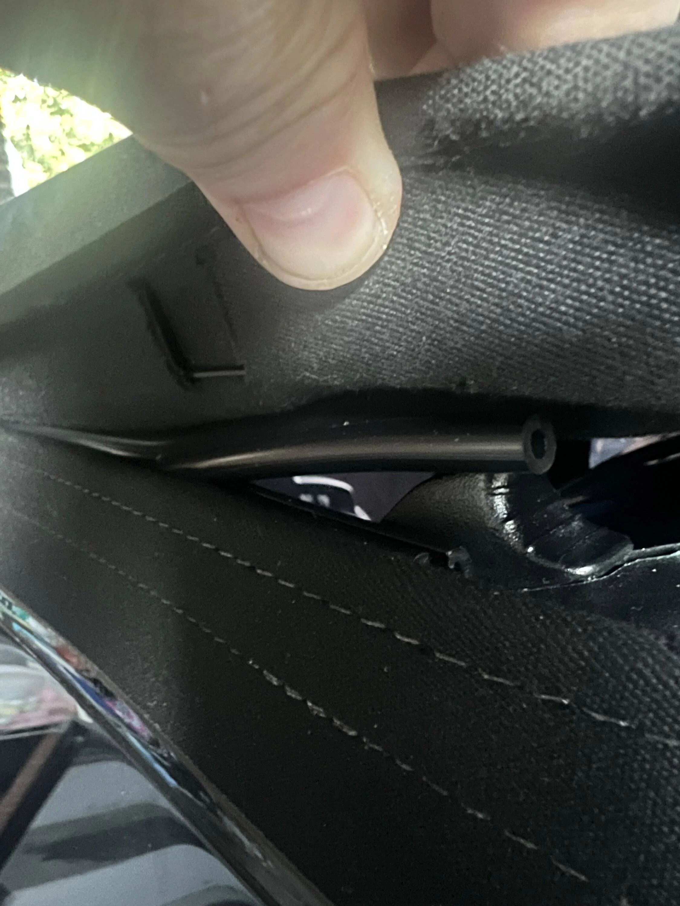

My 2022 does the same thing on the driver's side. I'll try the fix referenced above on the 2024 top.

Good luck. Mine hasn't had any issues since I pulled it over a little bit. That actually looks a little different than mine, as the side windows don't have that white pointed guide. I only see that on the rear window.

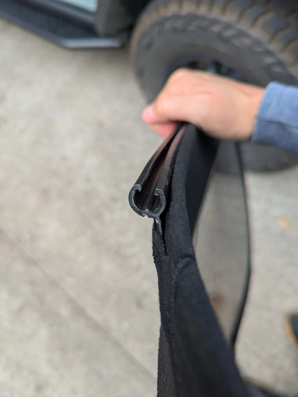

Same issue here, 2024 four-door.
Jeep Wrangler JL Soft top side window coming off track PXL_20250731_183214560.MP
The main difference I've noticed on mine is that, in addition to being flexed a little open, the end of the C channel seems to have a nick on the lower outside that would make it more prone to this kind of stress and also some lightening of the plastic on the inside indicating that the plastic has indeed been stressed.

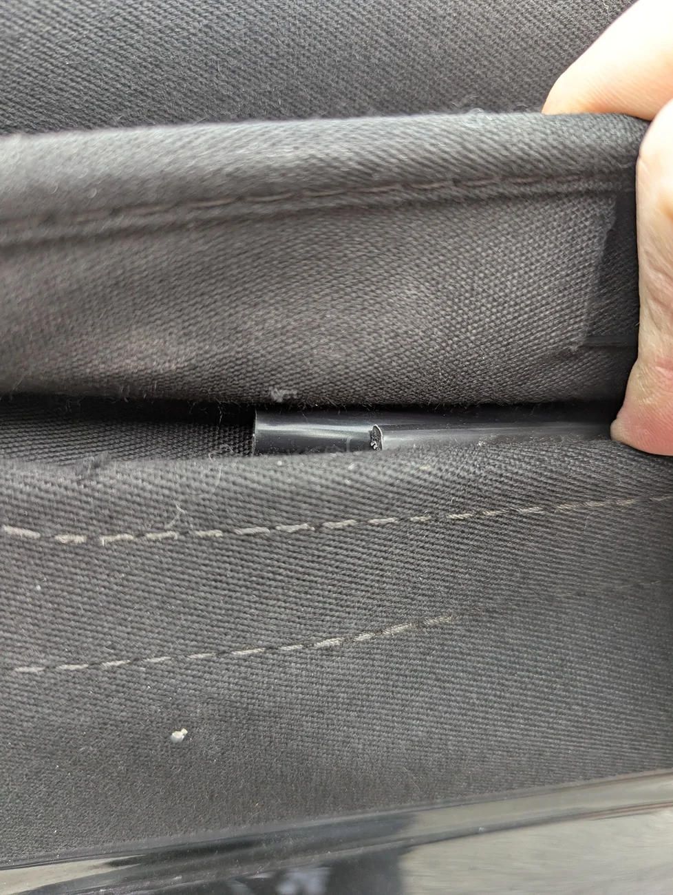

Jeep Wrangler JL Soft top side window coming off track PXL_20250731_183348873.MP

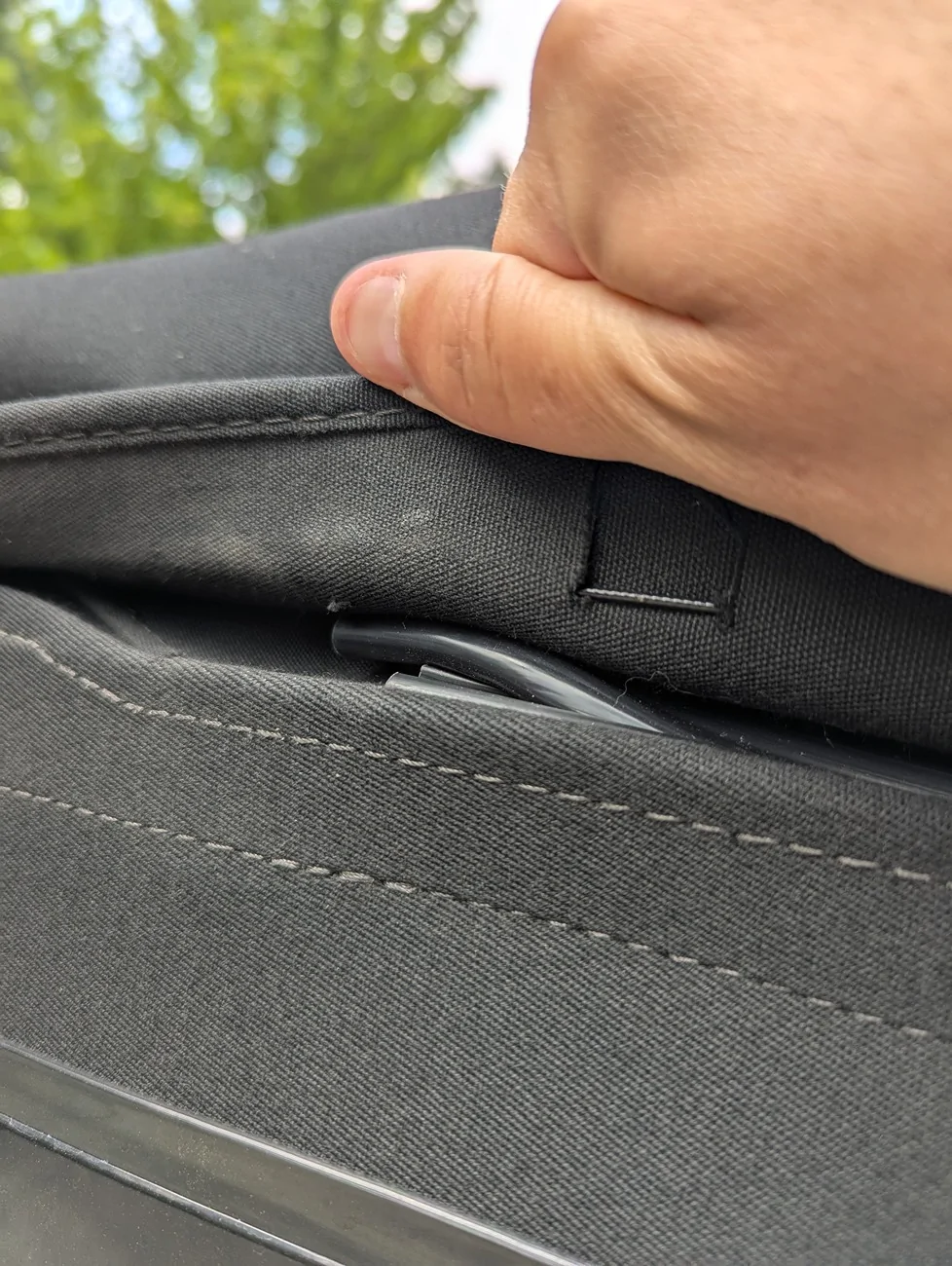

All that said, the soft top fabric was shifted all the way over on the bow and centering it seems to have essentially resolved the problem. The bead still does seem a little loose in the C channel at the front end, but at least it's in the track.
Jeep Wrangler JL Soft top side window coming off track PXL_20250731_185932545.MP
