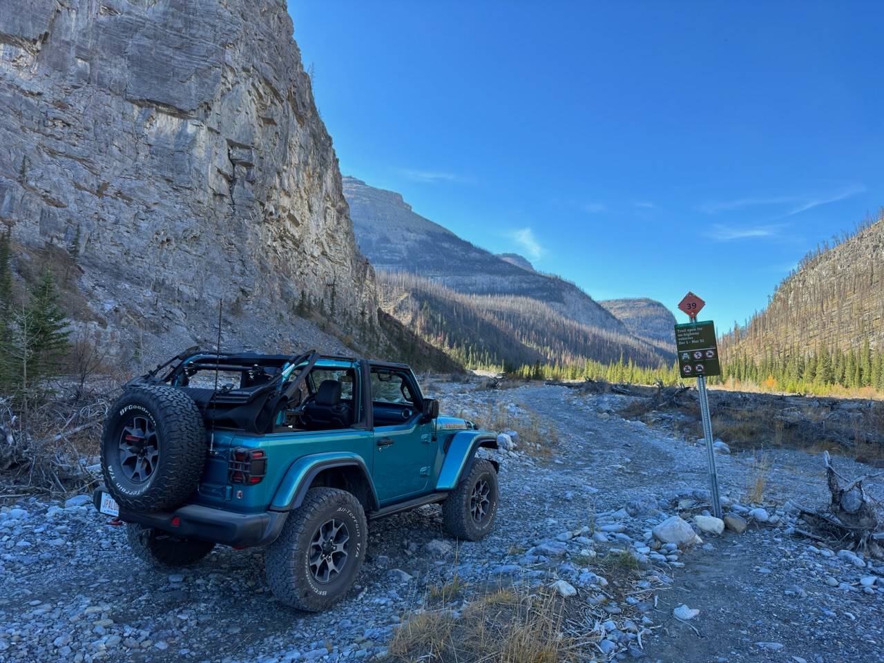

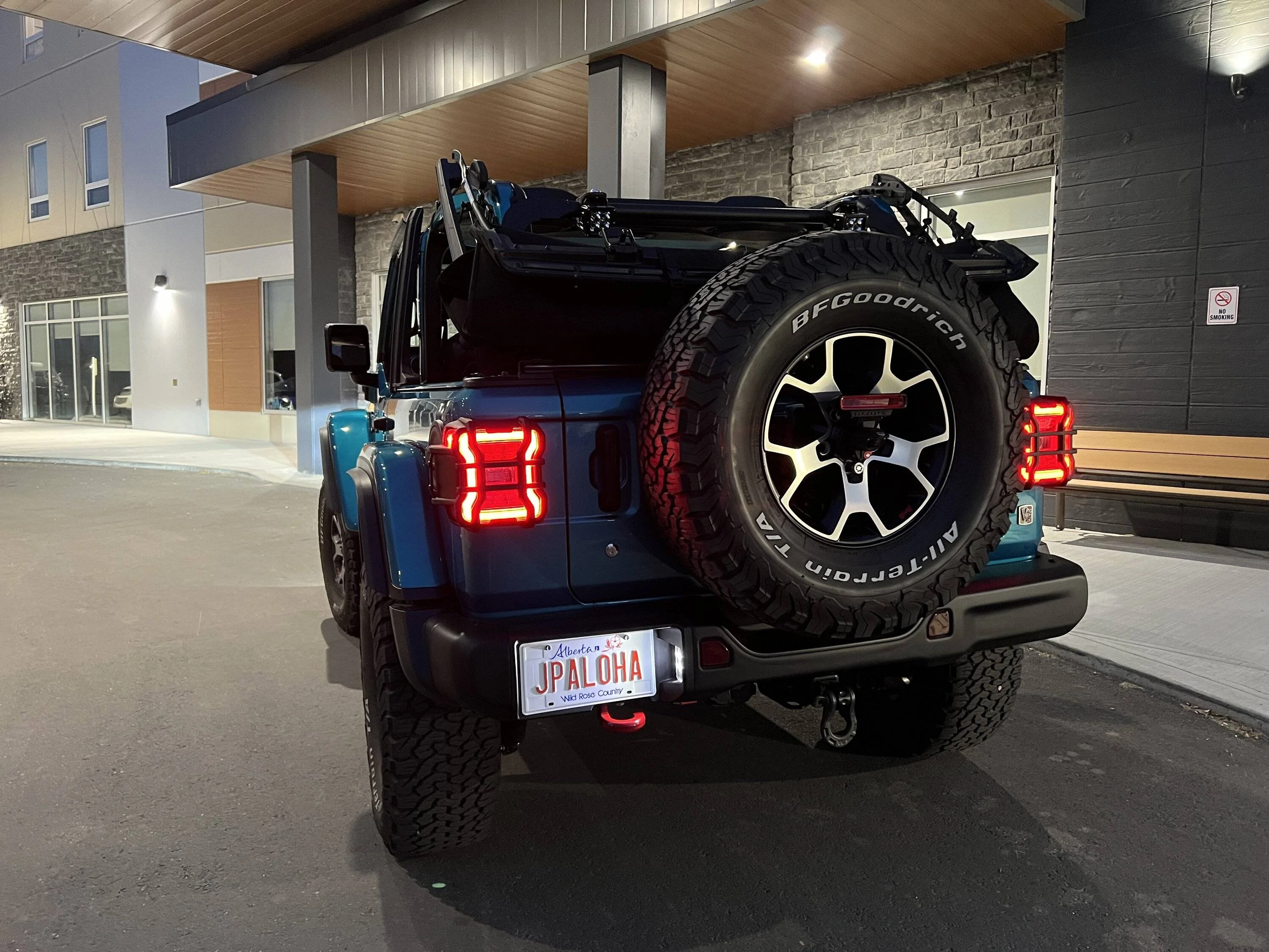

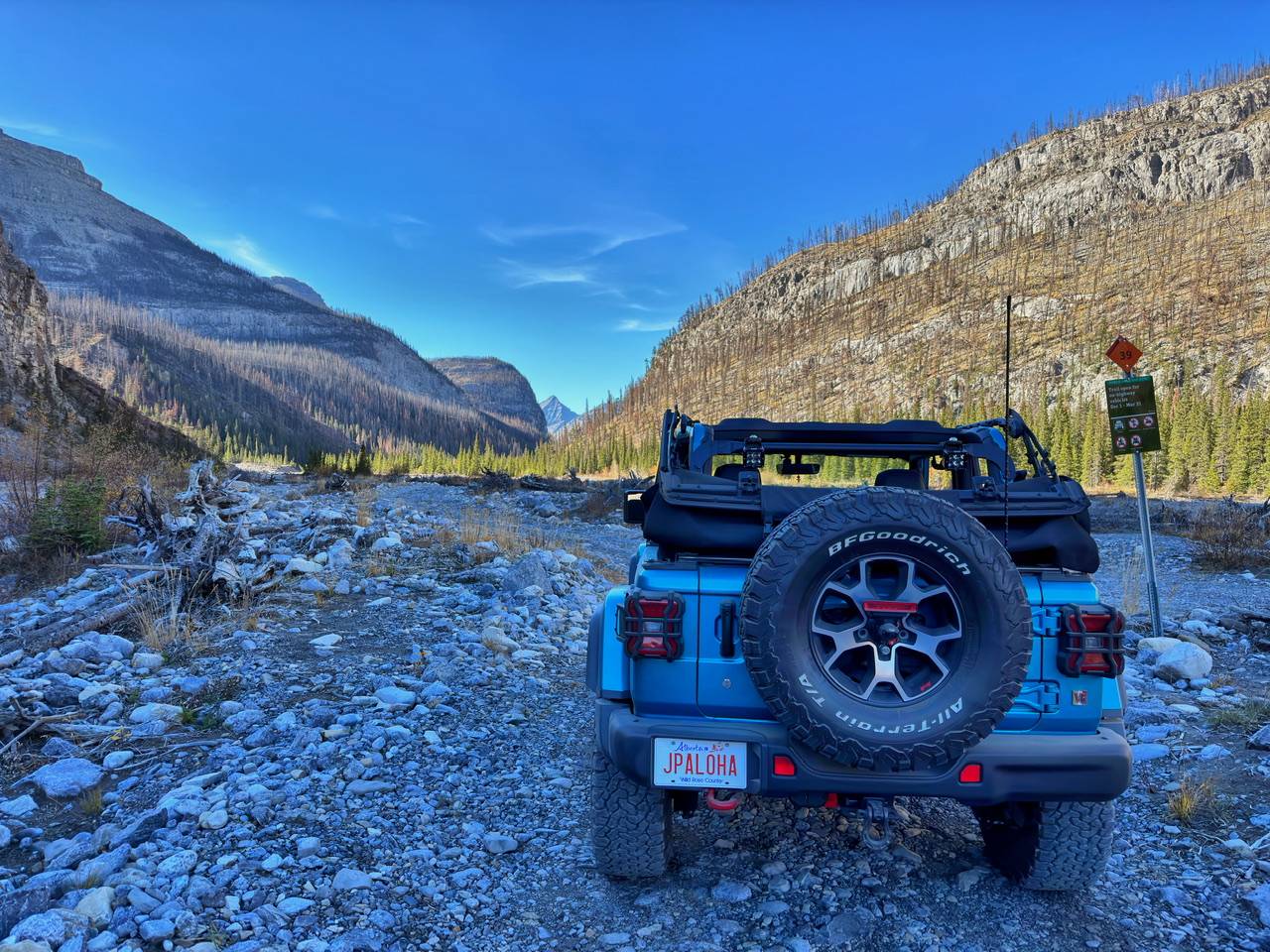

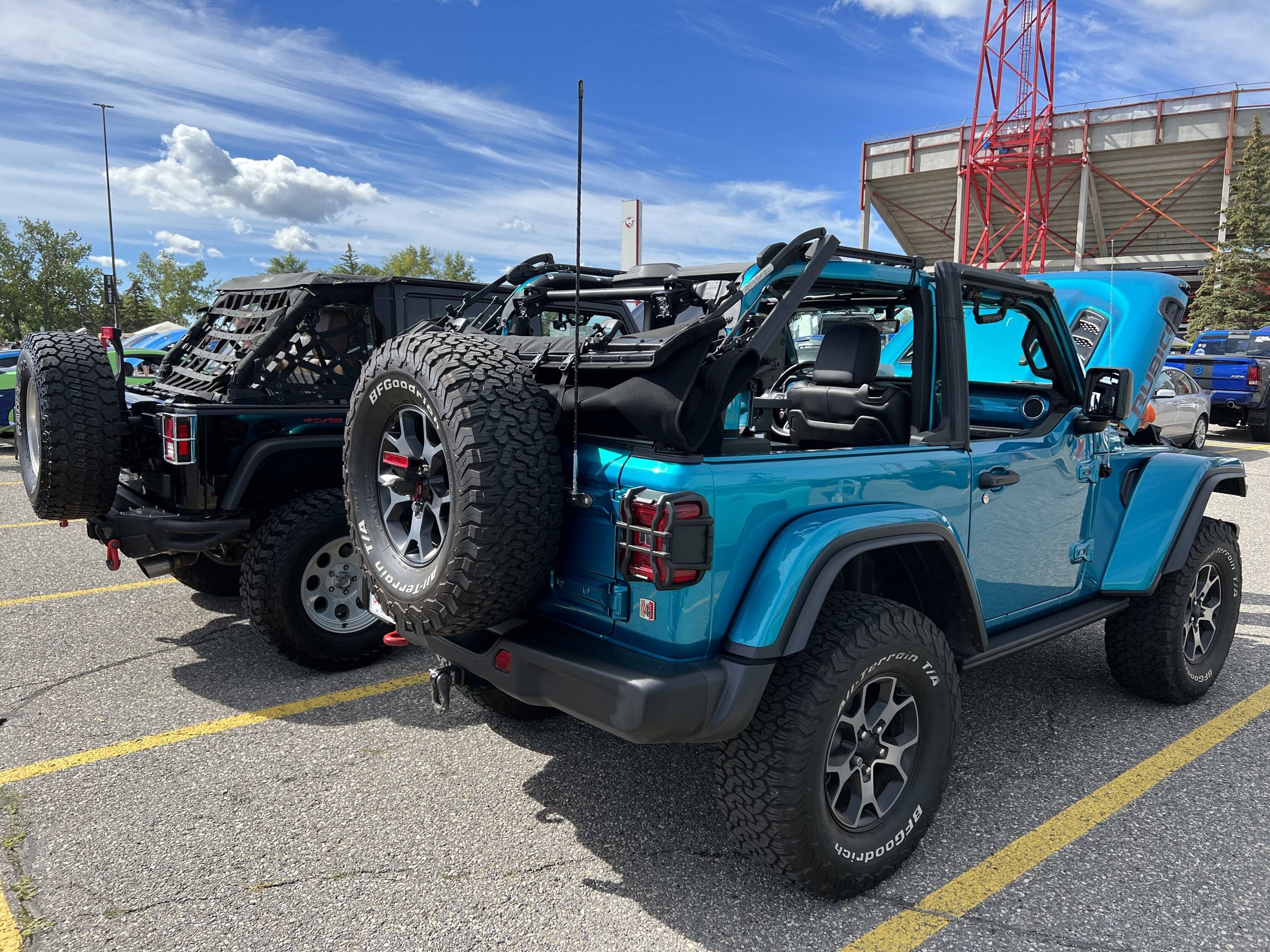

Here’s a few shots from the rear.
‘Tuffy security enclosure, the top does not lock into position so using a Diabolical top cover which I run under the tailgate bar and pull tight to eliminate any bounce.

Thank you so much for the pictures. Really sweet ride! Can you tell me what the item is
Thank you so much for the pictures. They are very helpful. Is that a soft top boot you're using in the pictures. If so, can you let me know which one you're using. It looks like something I'd be looking to get. Thanks again. Sweet looking ride with some great scenery!
https://shop.diabolicalinc.com/products/soft-top-cover
it‘s gone up in price since we bought ours, something similar could be made for much less
