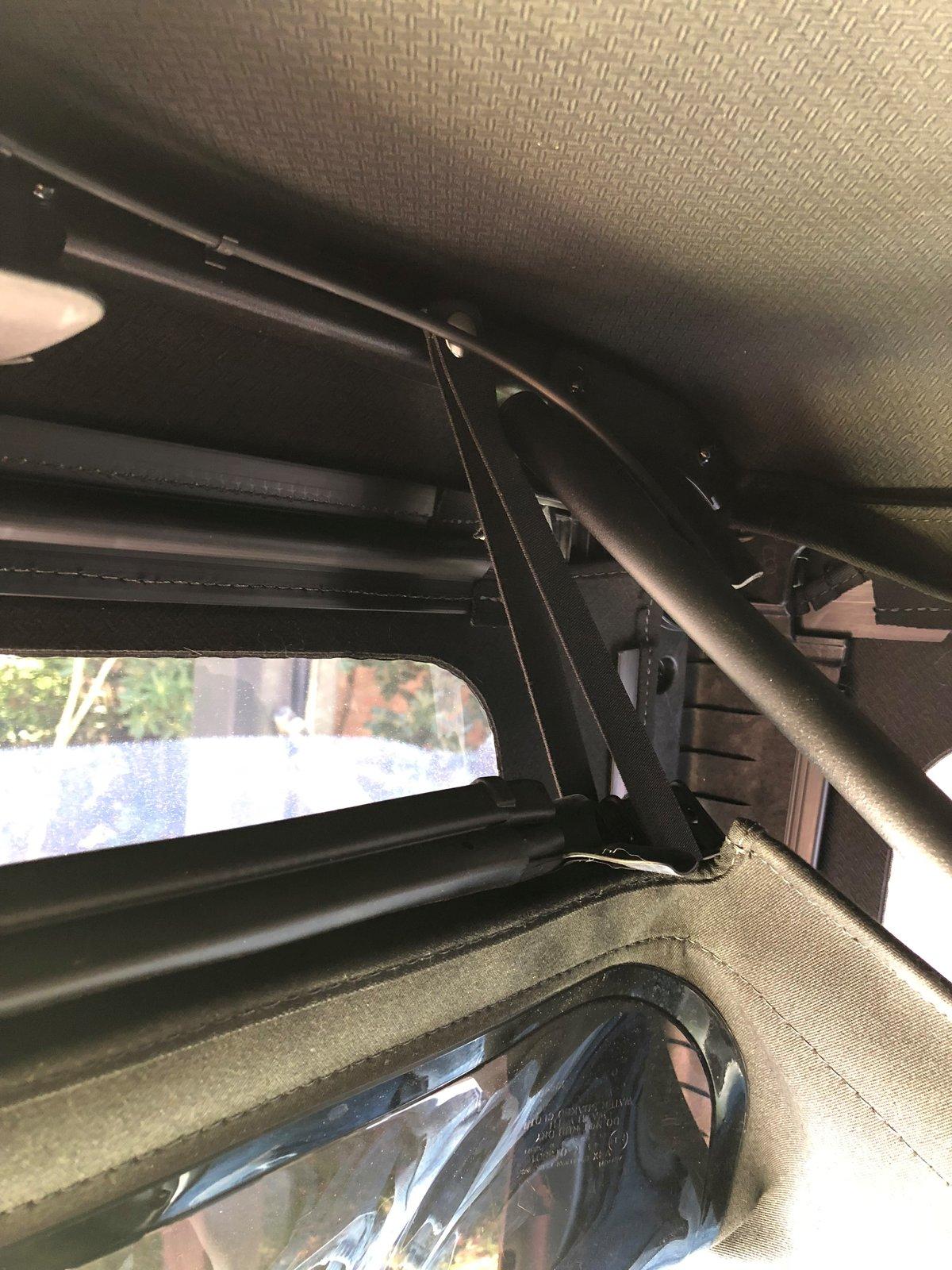

I had two sets of straps. One to hold the top down in the Sunrider position, and the second are to hold the rear window when it is "rolled" up. Since you can't really roll it up, those second set of straps (w/ a snap on them) are kind of useless. I got the rear window to "loop" up but not much else. See pics.

Ah that's right, I haven't used those since you can't really roll up the windows
That is what I thought.
