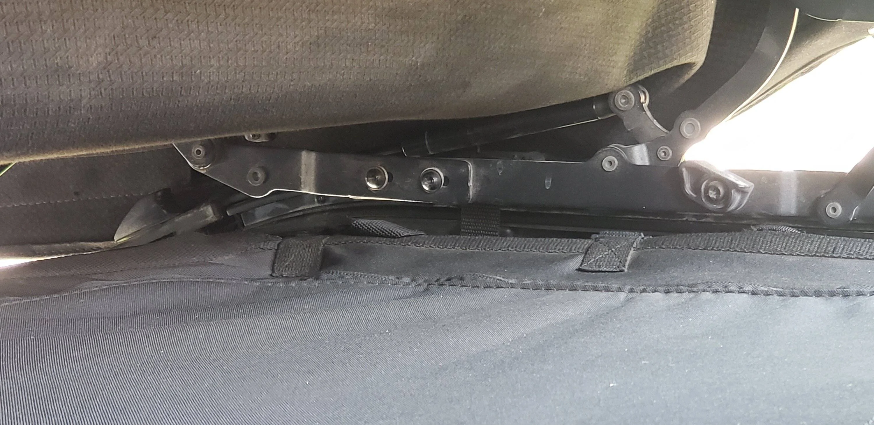

Found two rail screws on the driver and passenger side that look to be adjustable. Thinking that making the rail longer may load the spring more to keep it from rattling when the top is closed, but a little afraid to mess with them. Has anyone tried this? Have internet searched quite a bit and have not found any info on what these screws on the soft top rails adjust, but they do look like the adjust the length of the rails.
Can you post a picture of these rail screws?

Jeep Wrangler JL Soft top hinge squeak 20220721_123005
Those screws are in slots, so adjustable, but not sure on what they adjust, and a little afraid of loosening them to find out!
