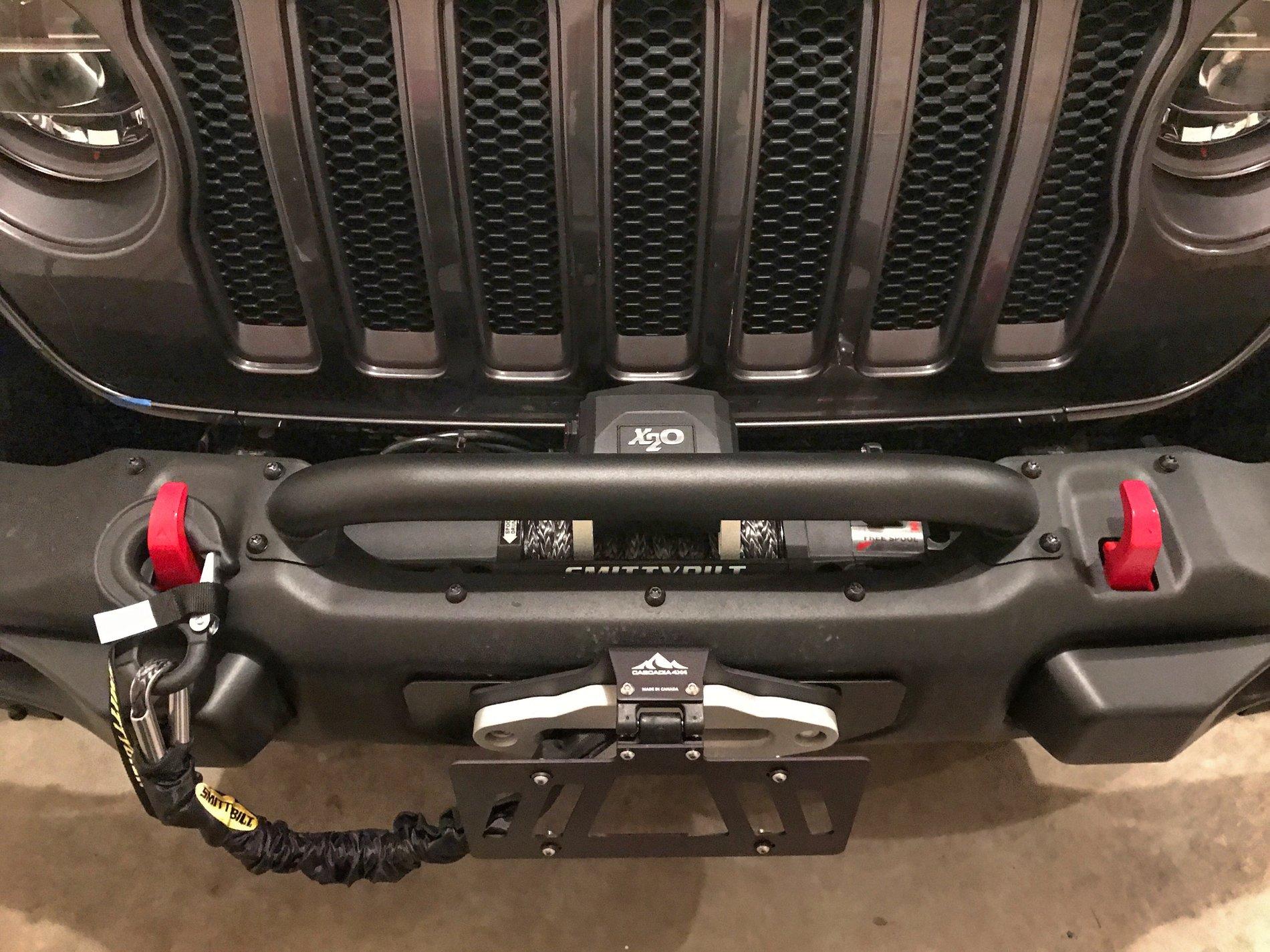

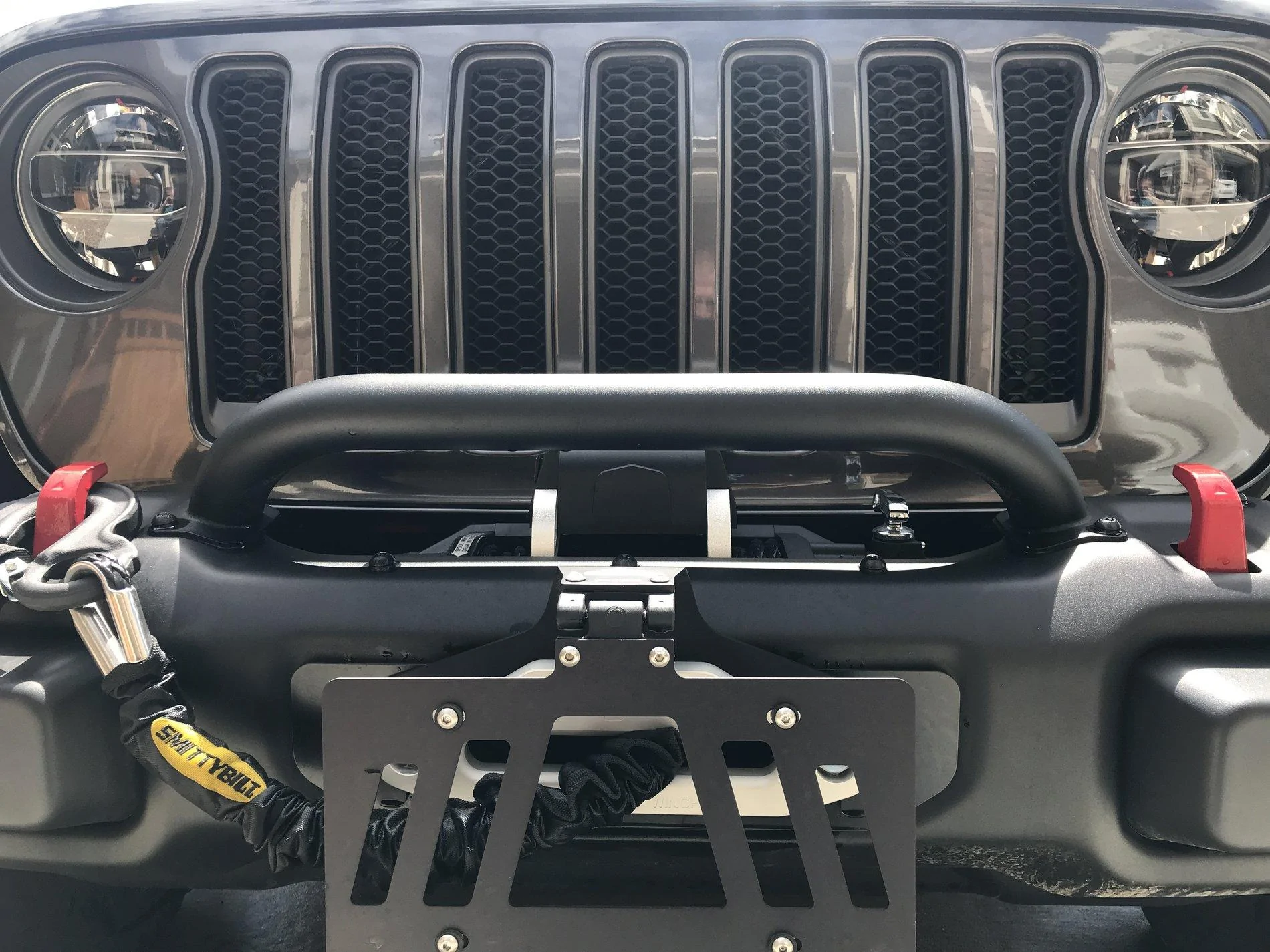

Got mine on tonight with the rusty plate as well. Flip up license plate.
I was able to find the mounting plate for the winch but couldn't find the flip up license plate holder. Would you happen to have a link?

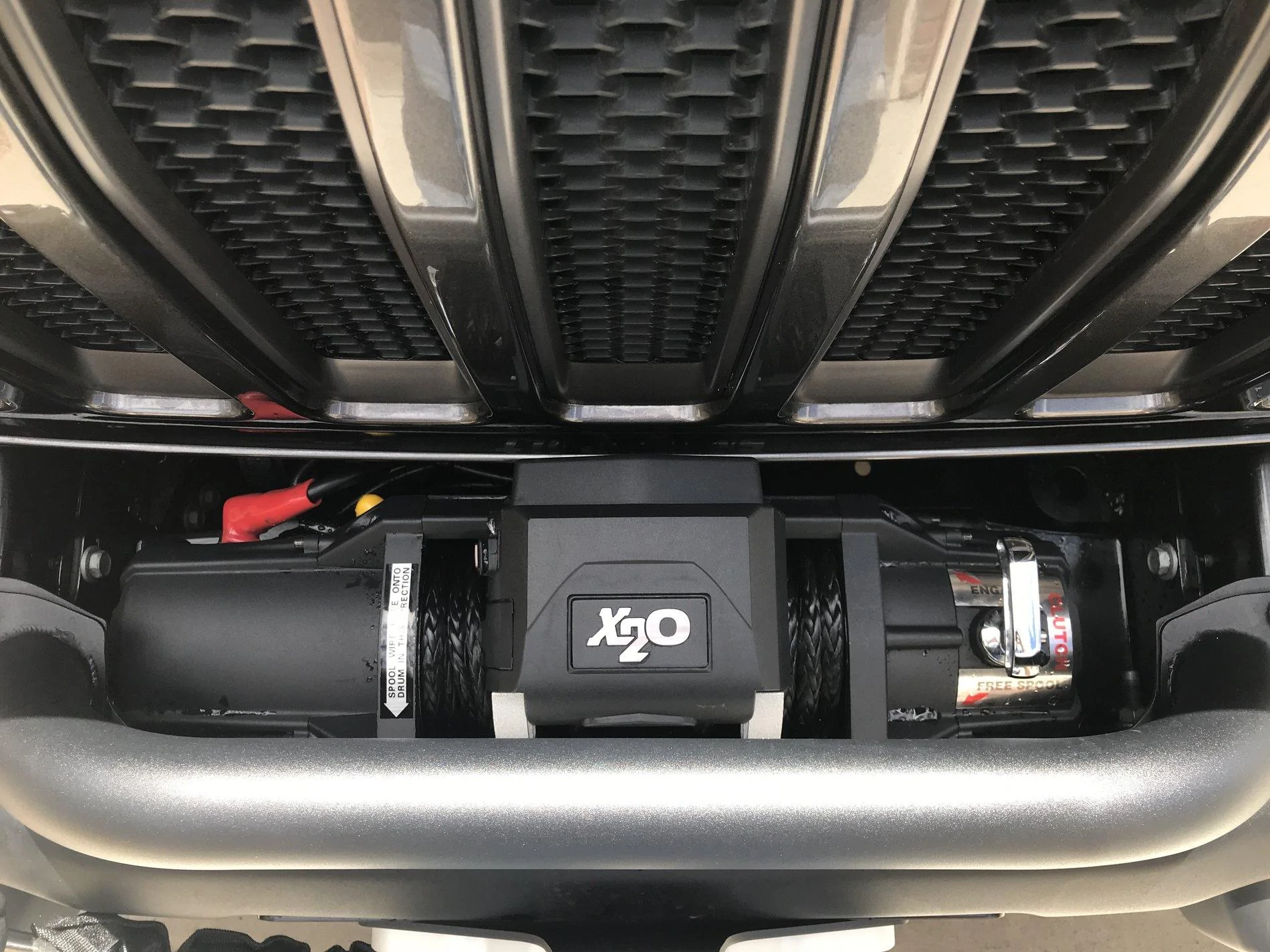

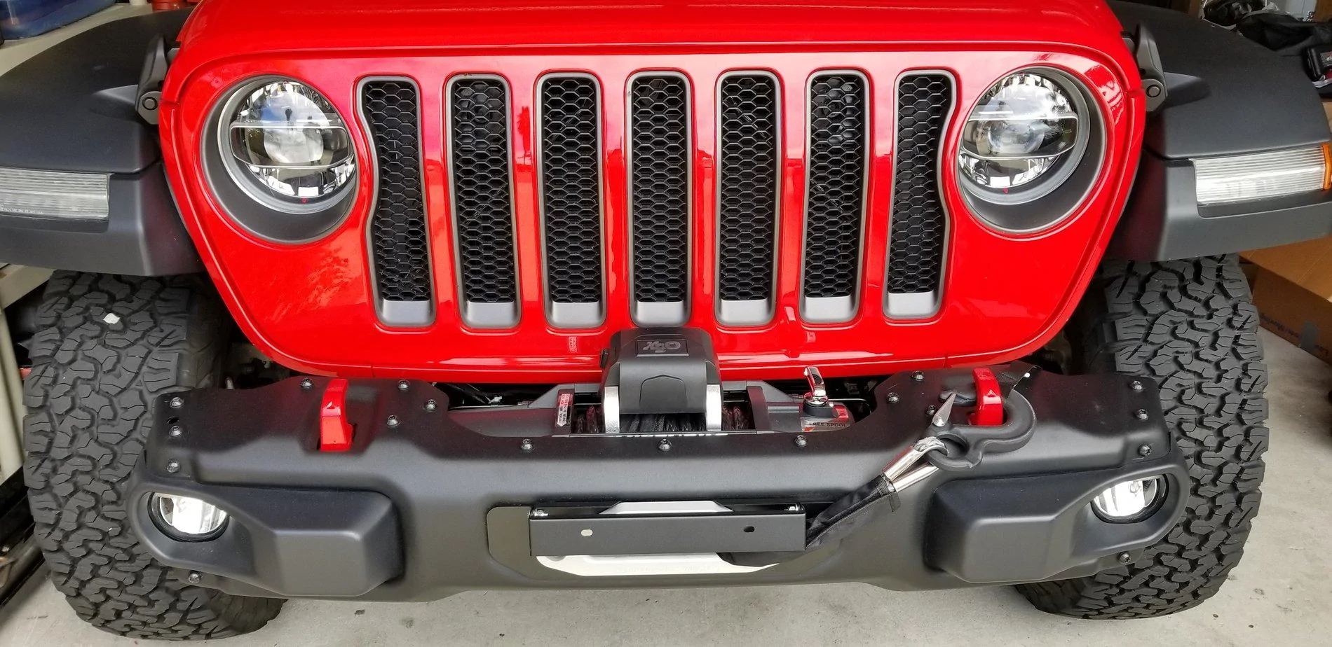

Installed my X20-10k today. Took a little longer than I was planning trying to get the wiring how I wanted it and since I was doing it solo. Pretty happy with how it turned out. Just need the mounting brackets for the Mopar lights and the front end is done.
Where'd you get your license plate holder from? I see cascadia..is that the same as the universal one on amazon? https://www.amazon.com/Cascadia-4x4...cense+plate&refinements=p_85:2470955011&psc=1
Where'd you get your license plate holder from? I see cascadia..is that the same as the universal one on amazon? https://www.amazon.com/Cascadia-4x4-Flipster-Universal-Mounting/dp/B0716K9LDK/ref=sr_1_2_sspa?rps=1&ie=UTF8&qid=1523329451&sr=8-2-spons&keywords=winch+flip+up+license+plate&refinements=p_85:2470955011&psc=1
https://www.amazon.com/gp/product/B01N4AKOEB/ref=oh_aui_detailpage_o08_s00?ie=UTF8&psc=1

Oh I thought you got yours from rusty's as well. I really appreciate it!
I bought from Rusty’s for the winch plate. eBay for the winch and Cascadia for the plate holder.

Did this install yesterday. My first time working on a Wrangler. Took about 3 hrs including a trip to Home Depot for deep sockets.
Wiring tip - I used a bent coat hanger to help pull through the wires.
