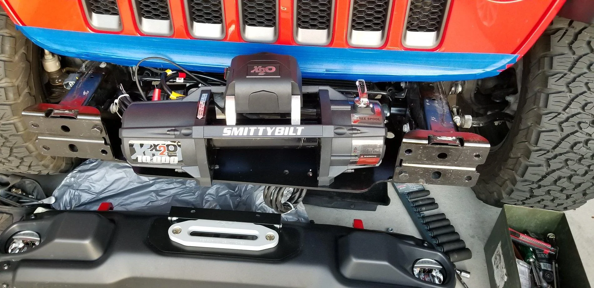

Mid winch install with Rusty's plate. I goofed and need to better manage the wiring to tuck it in under the grill (any tips?). The wiring out of the back of the winch to the controller box I think just needs to "point down" to tuck it under. I stopped as it was getting late.

Installed my X20-10k today. Took a little longer than I was planning trying to get the wiring how I wanted it and since I was doing it solo. Pretty happy with how it turned out. Just need the mounting brackets for the Mopar lights and the front end is done.
Wiring - do you mean to the battery or to the controller box? I need to point my connections at the back of the winch "down" I think to be able to tuck it better. I'm not to the point of getting to the battery yet, but saw the mopar instructions for routing.
Looks awesome.
I spent WAY to much time mounting those little tiny screw / nuts on the controller box to the middle of the winch. Either it's a bad design, bad angle or maybe my black "hooks" are bent but I bet I spent 30 minutes on that! :(
Looks awesome.
The controller box was a bit of a pain to attach like you said. I kept screwing and unscrewing the wires from the controller box to the winch to try and get them to lay right. They’re pretty thick and not very bendy so I couldn’t get them under the grill all the way. I got them as close as I could and then zip tied them together. Ran the battery wires under the grill and up the side by the air intake and then along the battery box so they weren’t all over the place.
