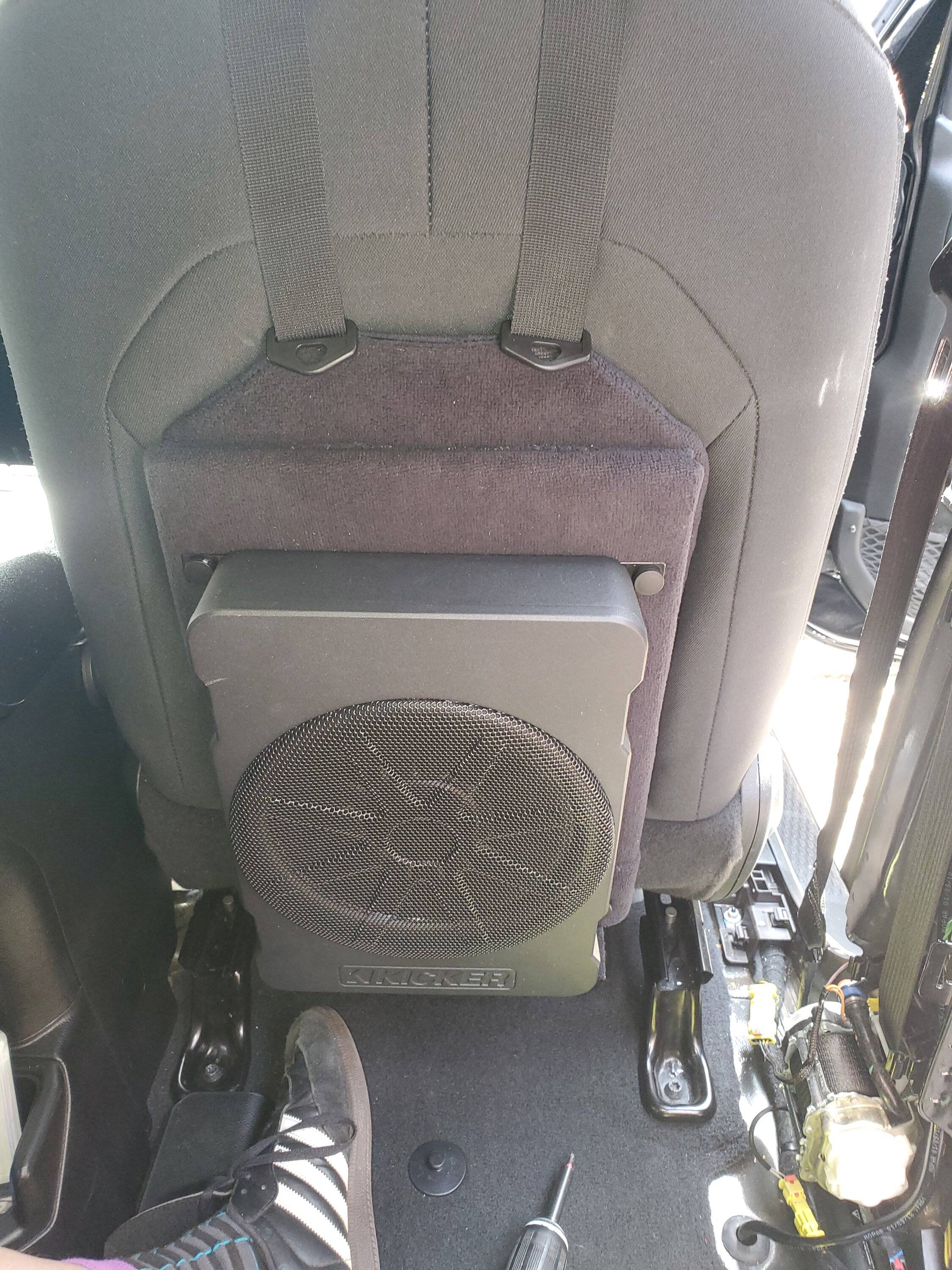

That's part of the problem and confusion!!!! In my jeep, there are only two wires to each side . . . Totally and completely perplexed by this . . . I looked the passenger side all over, only finding green wires!!!! Meaning REAR RIGHT, the driver side has the REAR GREY wires - so, I'll only be tapping into the RIGHT side . . . Hope it works but not too keen on running wires to both right and left . . .The four wires you need to tap into are on the passenger side b-pillar. And they are easy to locate as they are the only ones twisted. Gray/Green and Gray/DarkGreen for left. Dark Green/Green and DarkGreen/Gray for right.
