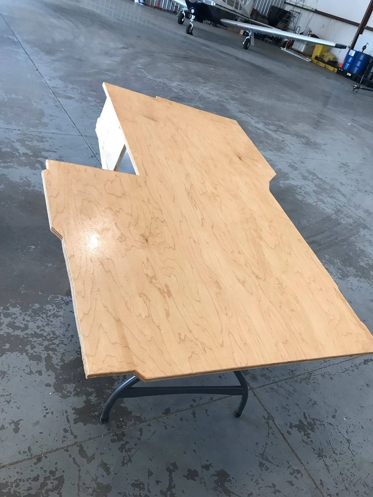

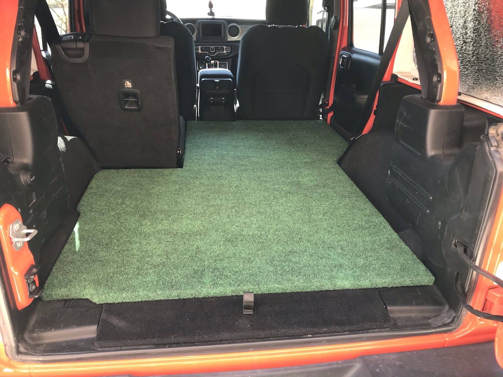

So, after reading about what others have built for platforms and sweating over my rusty woodworking skills, I finally bit the bullet and designed my own to be super simple and easy to install/remove. It was all done from one sheet of 3/4” maple plywood that cost $89 at Lowe’s. I made a template out of cardboard and made a few adjustments once I traced it onto the plywood. Below is the finished platform with the carpet I chose because it was $14 at Lowe’s.
Jeep Wrangler JL Simple, practical (Goose-Gear-like) platform. IMG_5330
Jeep Wrangler JL Simple, practical (Goose-Gear-like) platform. IMG_5328
Jeep Wrangler JL Simple, practical (Goose-Gear-like) platform. IMG_5331

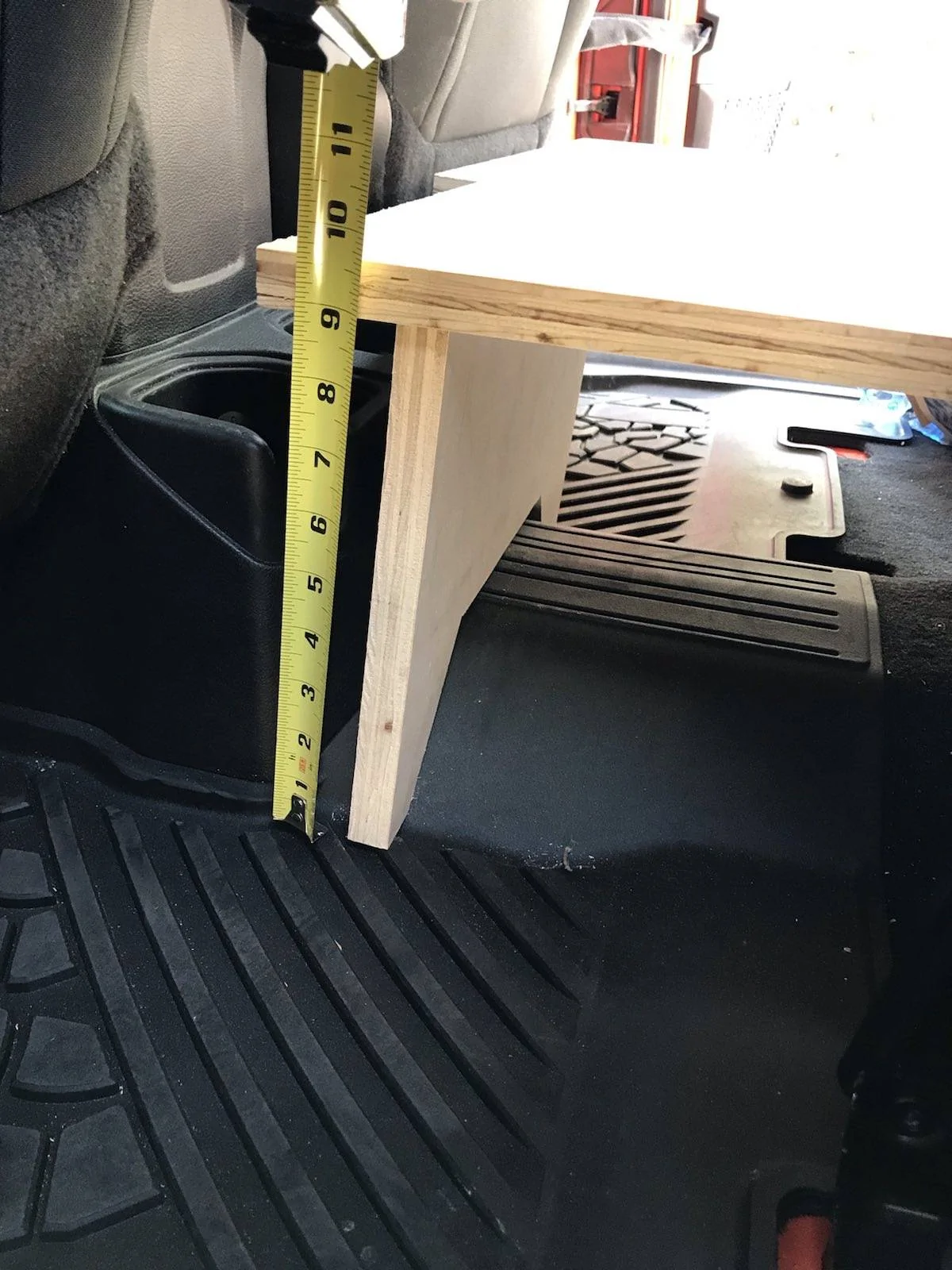

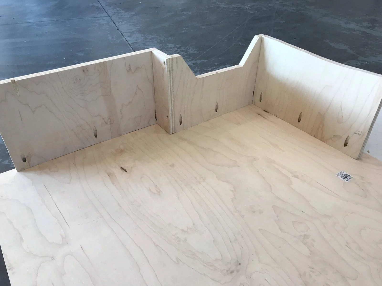

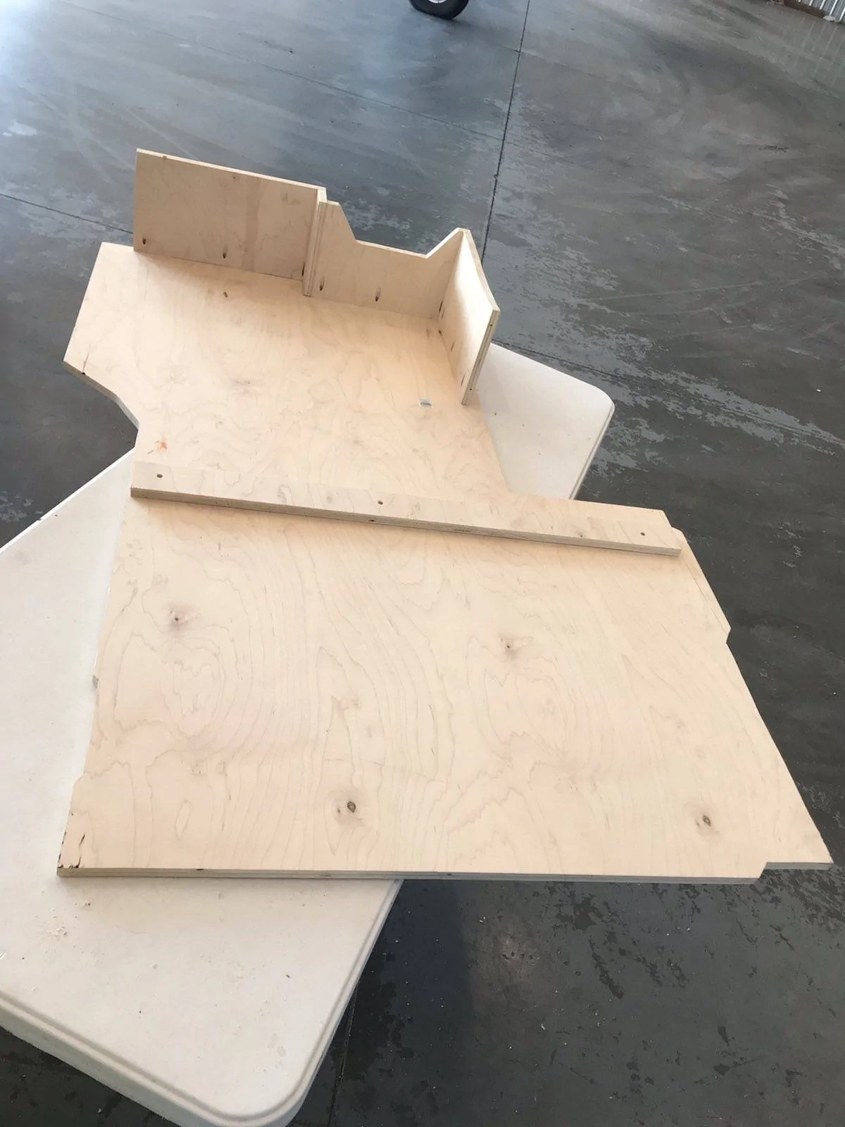

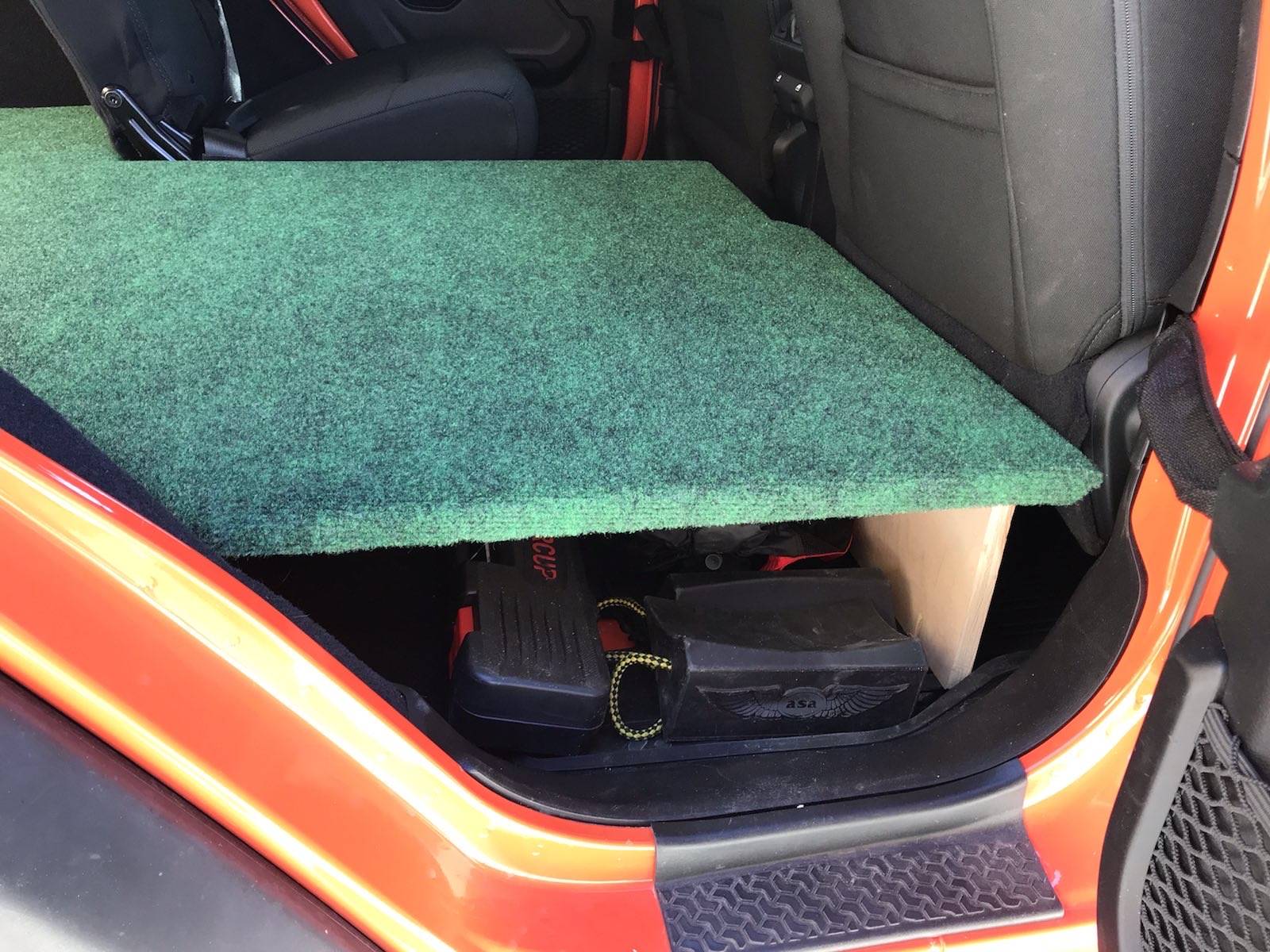

The hardest part was figuring out how to support the front. I used scrap from the same sheet of plywood at a height of 9”. Then attached everything using pocket hole screws. I also used a strip across the underside to fill in a gap and make it more firm.
Jeep Wrangler JL Simple, practical (Goose-Gear-like) platform. IMG_5325
Jeep Wrangler JL Simple, practical (Goose-Gear-like) platform. IMG_5326
Jeep Wrangler JL Simple, practical (Goose-Gear-like) platform. IMG_5327

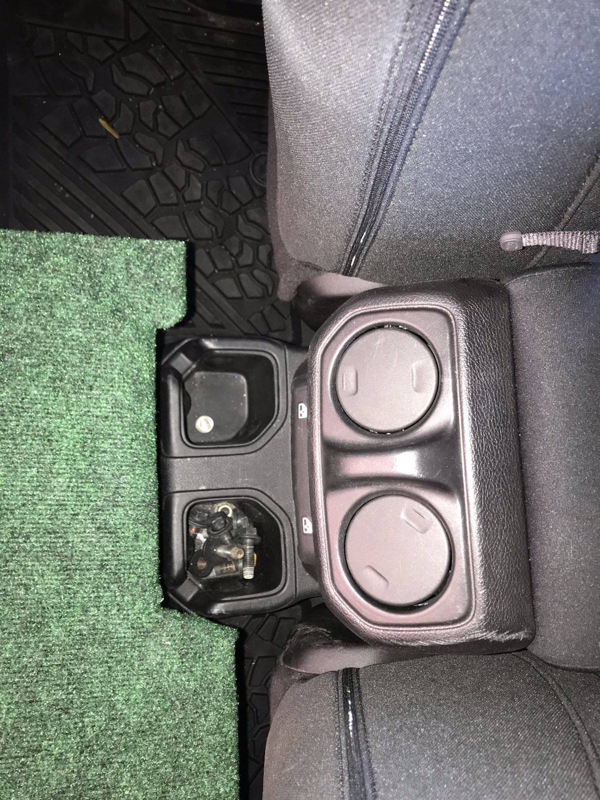

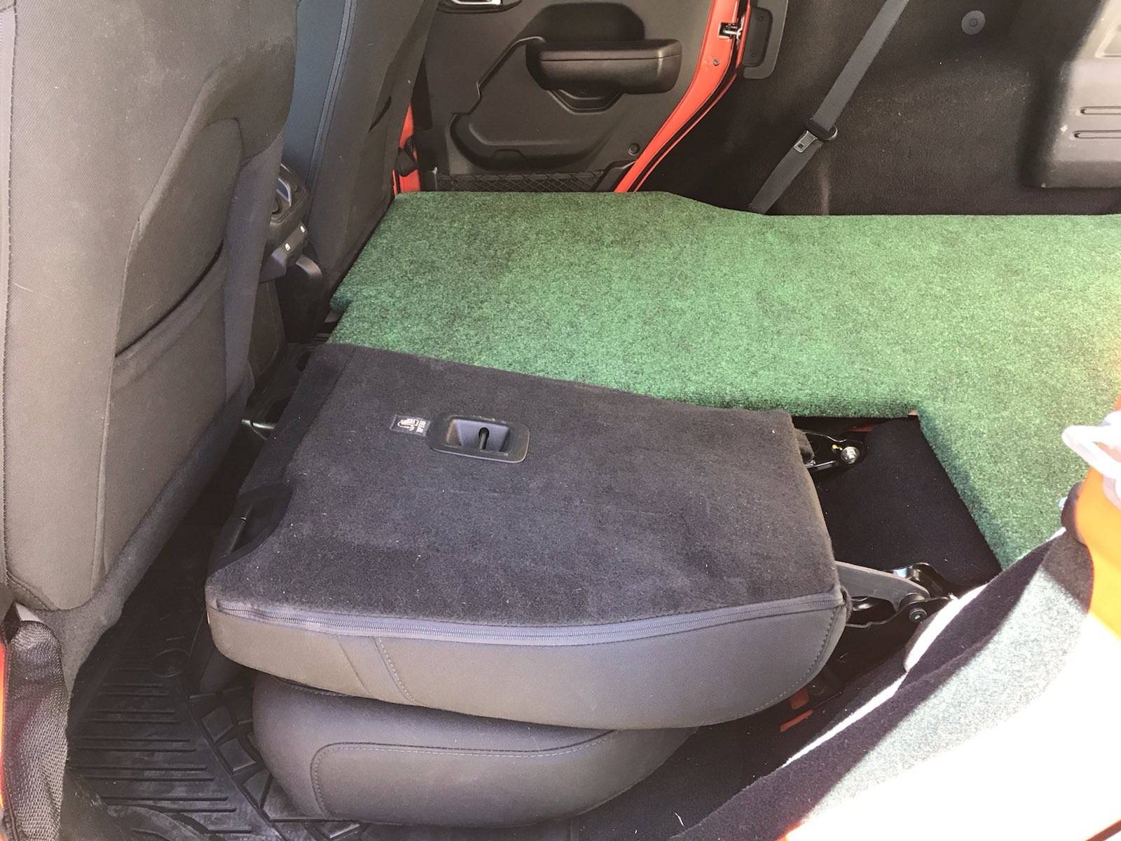

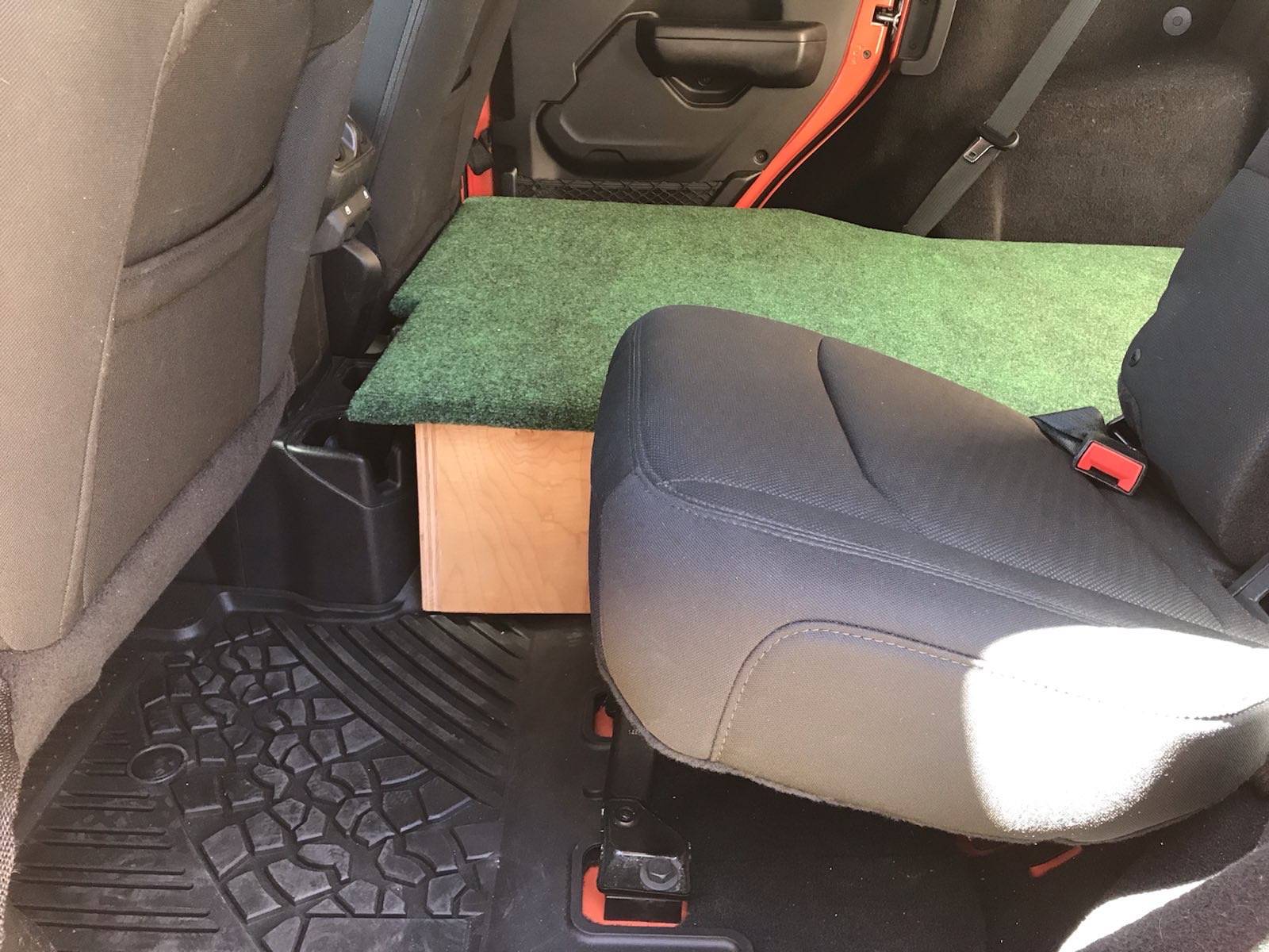

I opted to leave in the 40% seat and keep access to the rear cup holders.

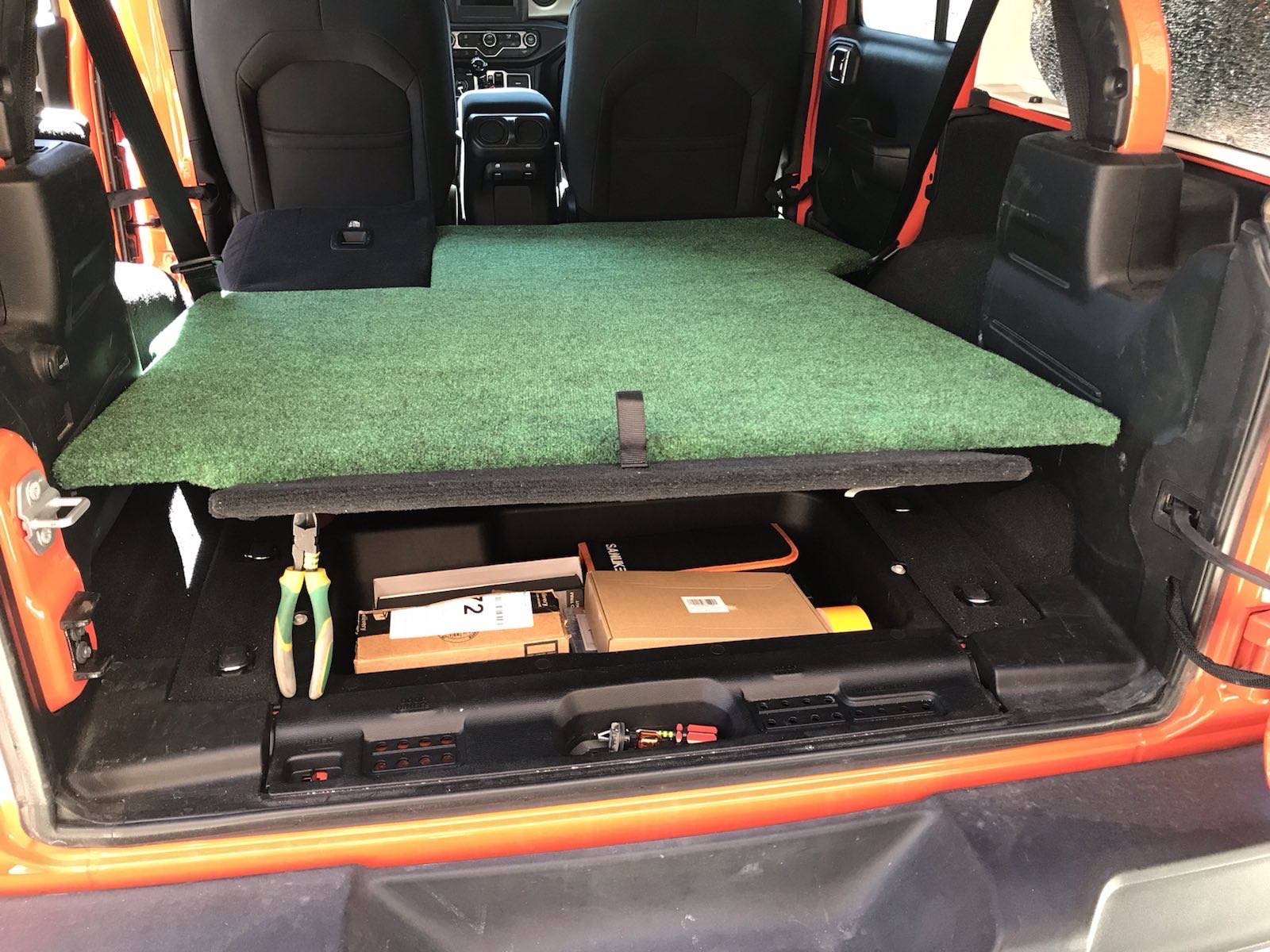

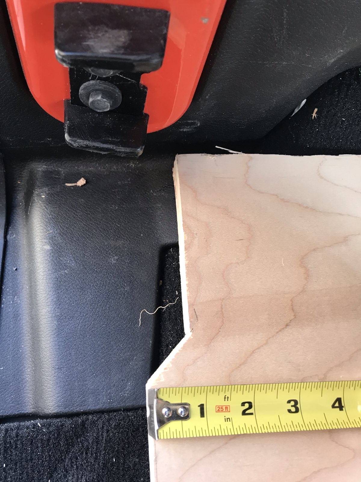

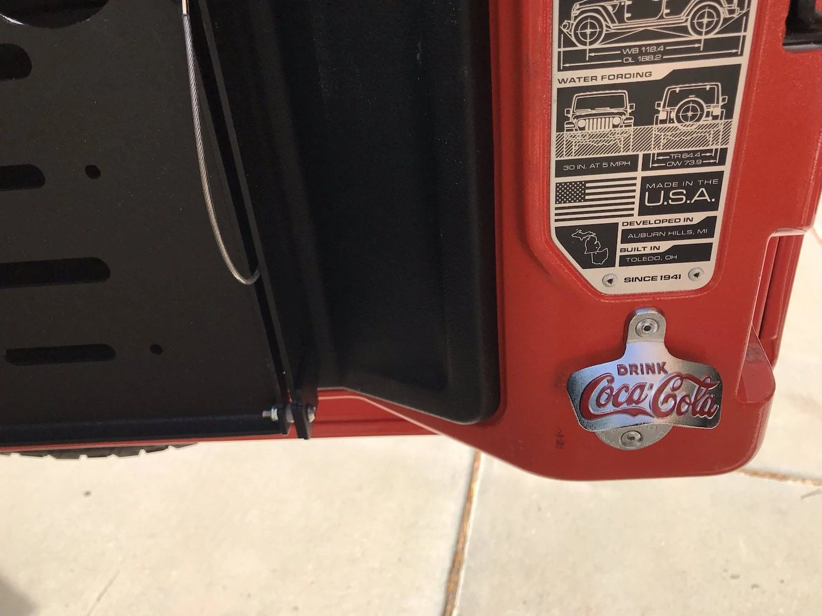

It’s not attached to anything, the weight holds it in place and access to the rear storage is easy by just lifting the rear of the platform. The platform doesn’t shift, squeak or rattle; nice and quiet. The real beauty of this design is I did not have to pull out anything but the 60% seat. The carpet and rear floor mat stay where they are. I can pull this out and reinstall the rear seat at anytime. The notch on the rear drivers side is to accommodate a bottle opener I mounted next to my tailgate table.

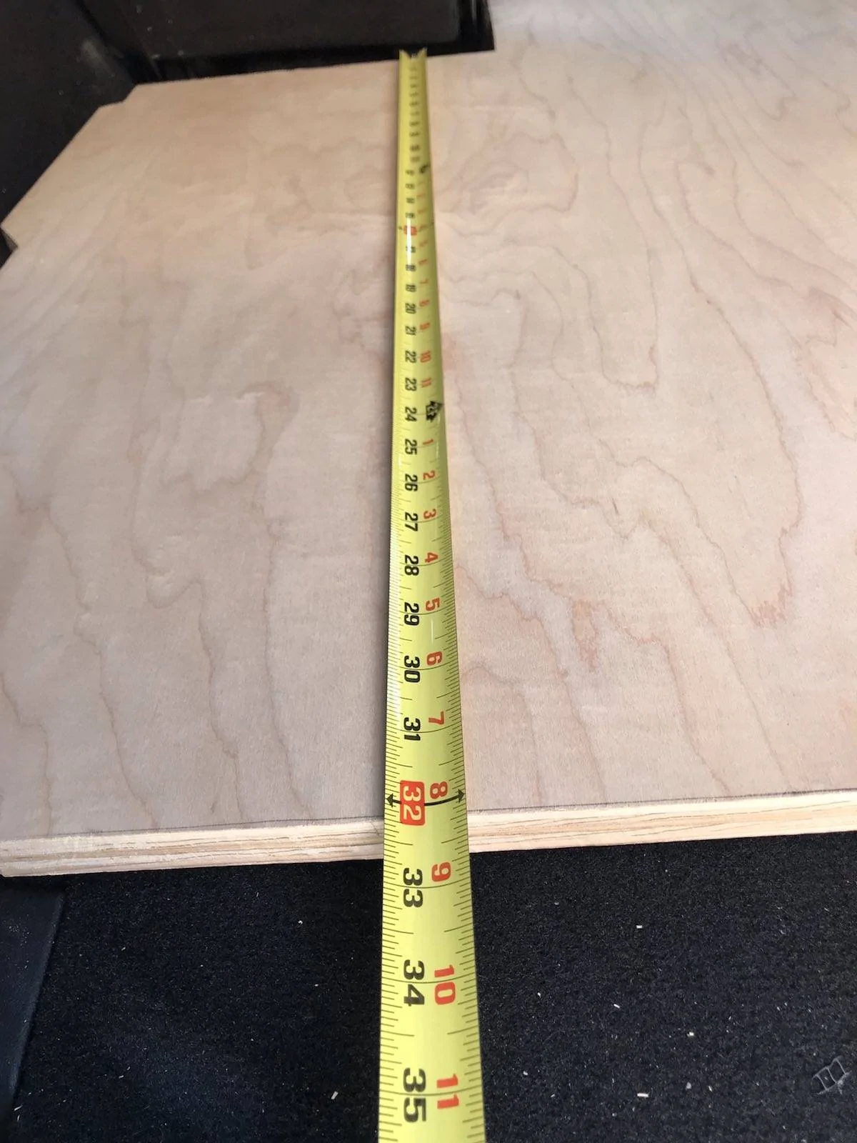

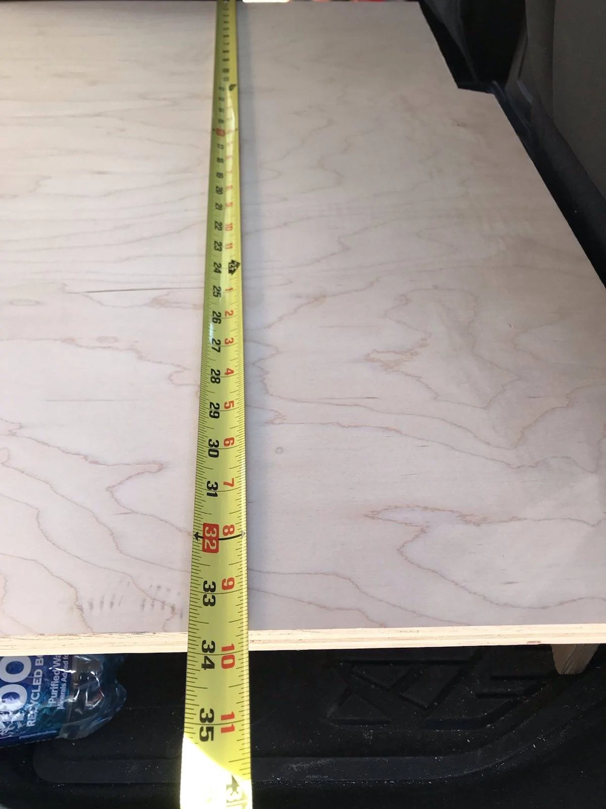

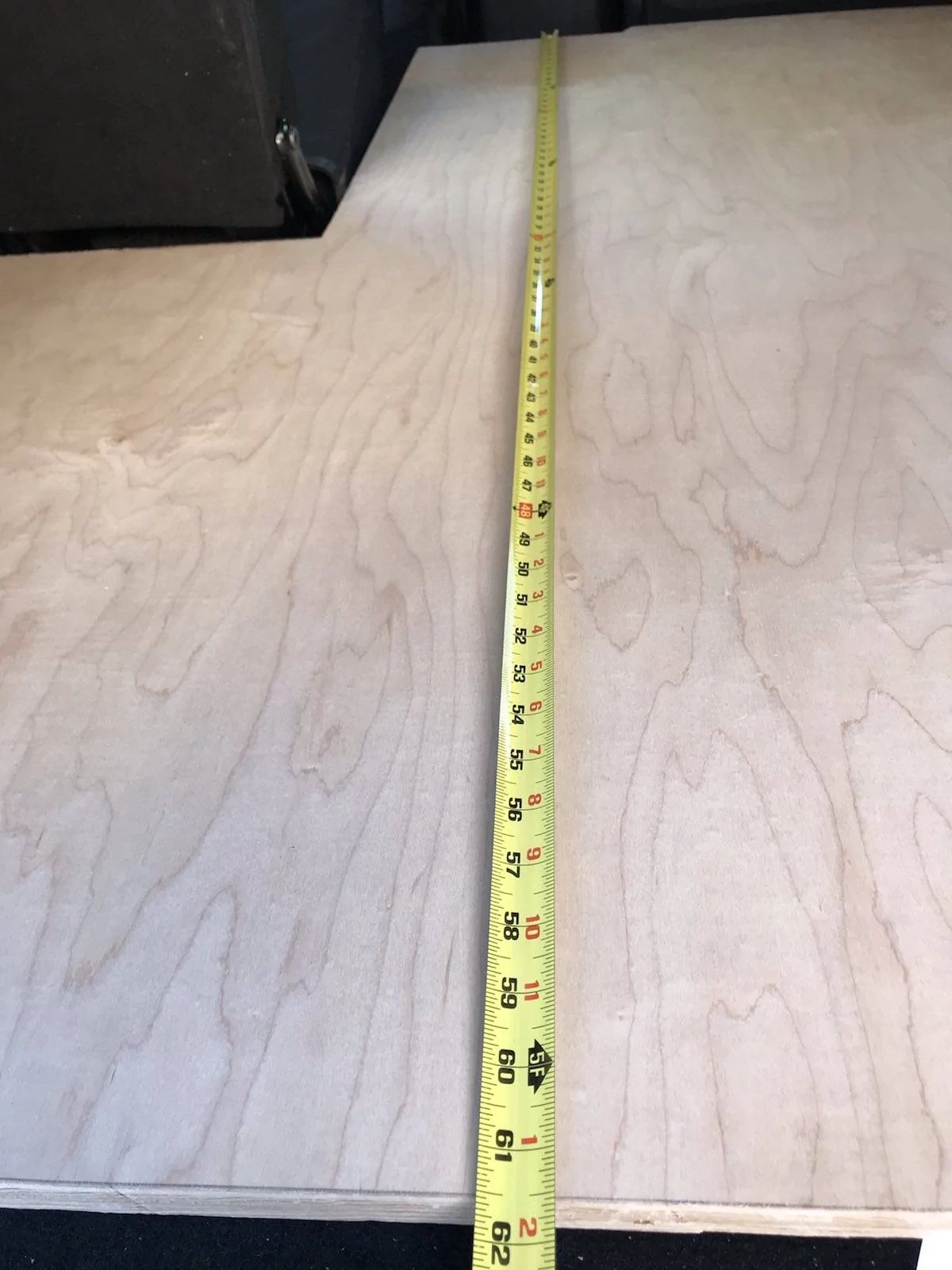

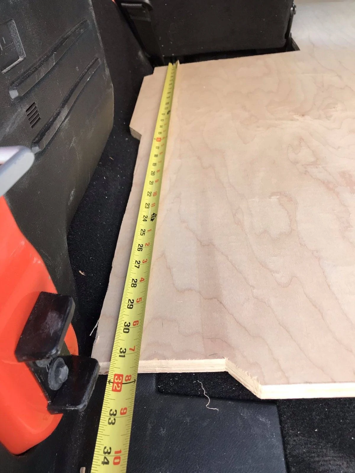

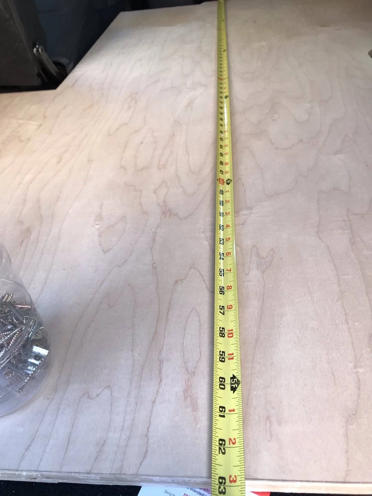

These are some pictures I took that show some measurements. And one final one just because. ?
Jeep Wrangler JL Simple, practical (Goose-Gear-like) platform. IMG_5322
Jeep Wrangler JL Simple, practical (Goose-Gear-like) platform. IMG_5320
Jeep Wrangler JL Simple, practical (Goose-Gear-like) platform. IMG_5319
Jeep Wrangler JL Simple, practical (Goose-Gear-like) platform. IMG_5318
Jeep Wrangler JL Simple, practical (Goose-Gear-like) platform. IMG_5317
Jeep Wrangler JL Simple, practical (Goose-Gear-like) platform. IMG_5316
Jeep Wrangler JL Simple, practical (Goose-Gear-like) platform. IMG_5315
Jeep Wrangler JL Simple, practical (Goose-Gear-like) platform. IMG_5276

I was thinking of making it so I could have one rear seat exactly like you did. IIRC, there's an issue with supporting the 40% seat, at least with my 2018. Can you explain what you had to do to support the seat?
