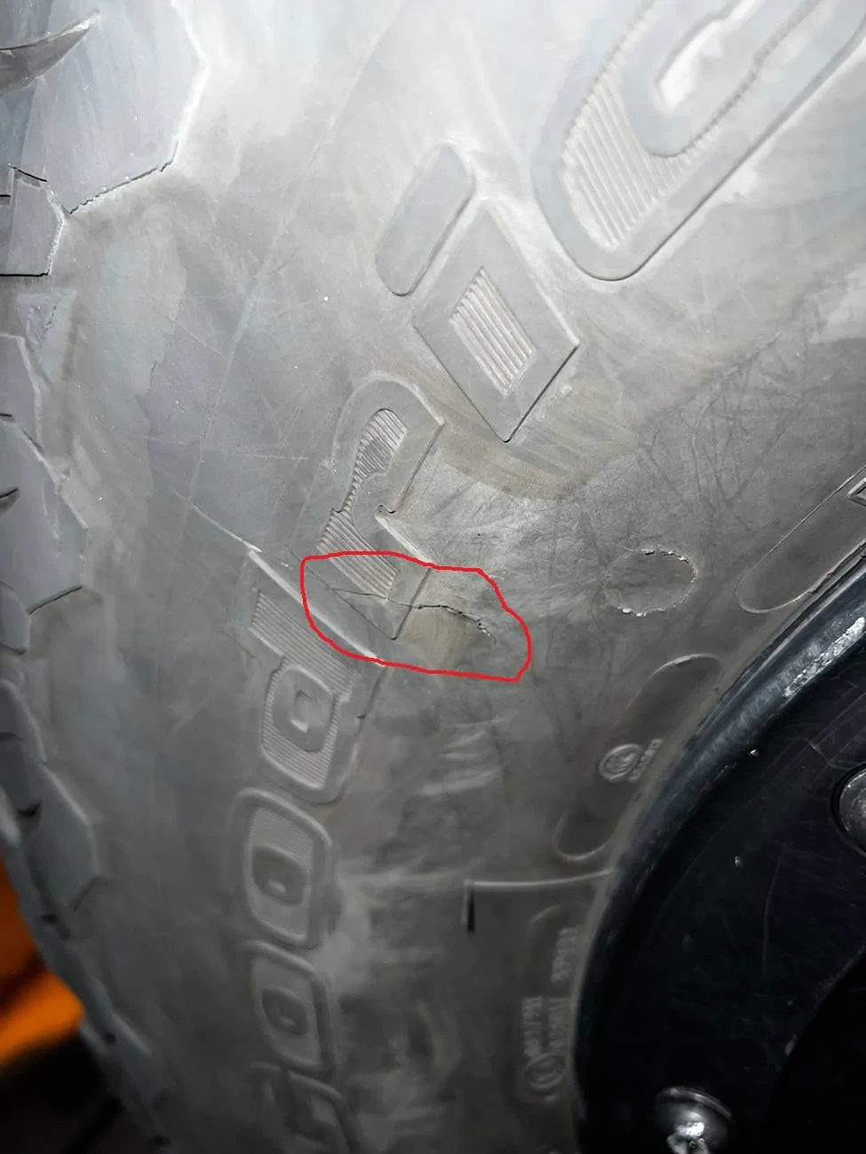

Hi, last weekend I did cut one of my ko2s with a sharp rock on the sidewall. I am a bit concerned about it but not sure if it’s fixable, a replacement is needed or I can use it like this
If damaged, can I swap it with the spare? It has 20k miles and spare is new. I want to eventually replace them with 37 (this are oem 35 from the XR trim)
thanks!
Push on it and take another picture. It looks like just a flesh wound to me though...I would just continue ops normal. I would compare the depth of your spare to your 4 tires in use using a tread depth gauge. Going forward I would rotate all 5 tires if you either get a new set, or the tread depth is not that far off...that's a whole other tire to get more mileage out of before it runs out of time, or gets completely sun-checked just hanging out on the back of your Jeep.

not really an issue. belt isnt compromised at all. you cant even see the belt. if its holding air youre good. if it bothers you swap it out with the spare. should have been rotating that spare in the whole time.
K0s seem to have rather weak sidewalls. or at least the load C do.

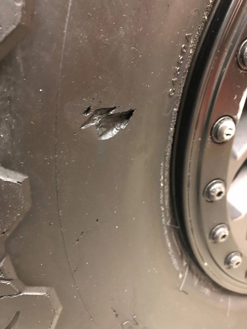

So honest question, you guys would be ok ok running either of these tires. First pic mine, 2nd pic OPs? Maybe I am paranoid without a reason. I wouldn’t and don’t like having a damaged spare.
The OP's original photos showed just a thin cut to the sidewall. In his new photos, as well as yours, the problem is you have a chunk of the outer ply missing, so the inner sidewall ply is now more vulnerable to the next hit. On pavement you might be fine for 50,000 miles. Offroad, you've increased the odds that the next rock to scrape the tire can now scrape that inner layer and pop the sidewall. I've run with small chunks of the outer ply missing for thousands of miles with no issues. Larger ones, it's a judgment call.
I believe @wibornz ran his tires for some thousands of miles with a much worse looking gash in the sidewalls; it eventually gave out one day and he had to replace the tire.

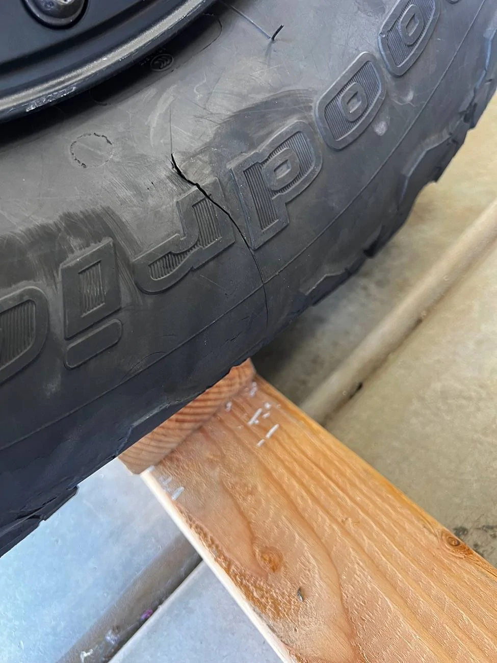

You mean like this?
Jeep Wrangler JL Sidewall cut with rock 1726127165012-p1
I put about 14,000 miles on this tire before it failed. I did this in February of 23, and the tire failed in December of 23. I was surprised at how long it lasted. When it failed, It just gradually lost air. Of course it failed while I was about 60 miles from home out running trails. I put the spare on and then continued on.
