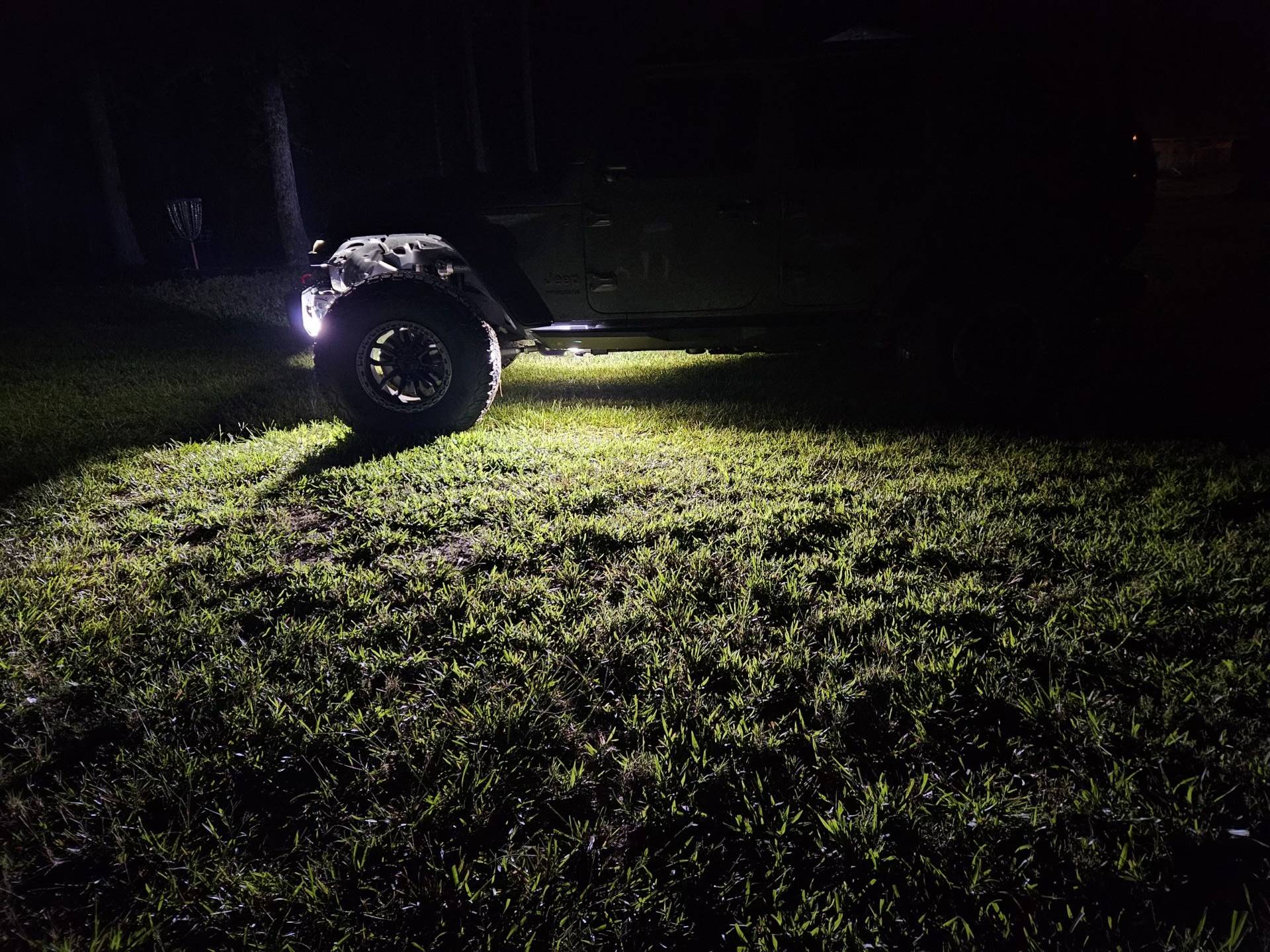

This is what I did and I love them for exactly that purpose and the turn signal covers the blind spot on the highway as well. If you look at them on my jeep, I had to cut and modify them due to the aftermarket fenders I installed. Normally they're a little longer than what mine look like.
Got a night shot of those?

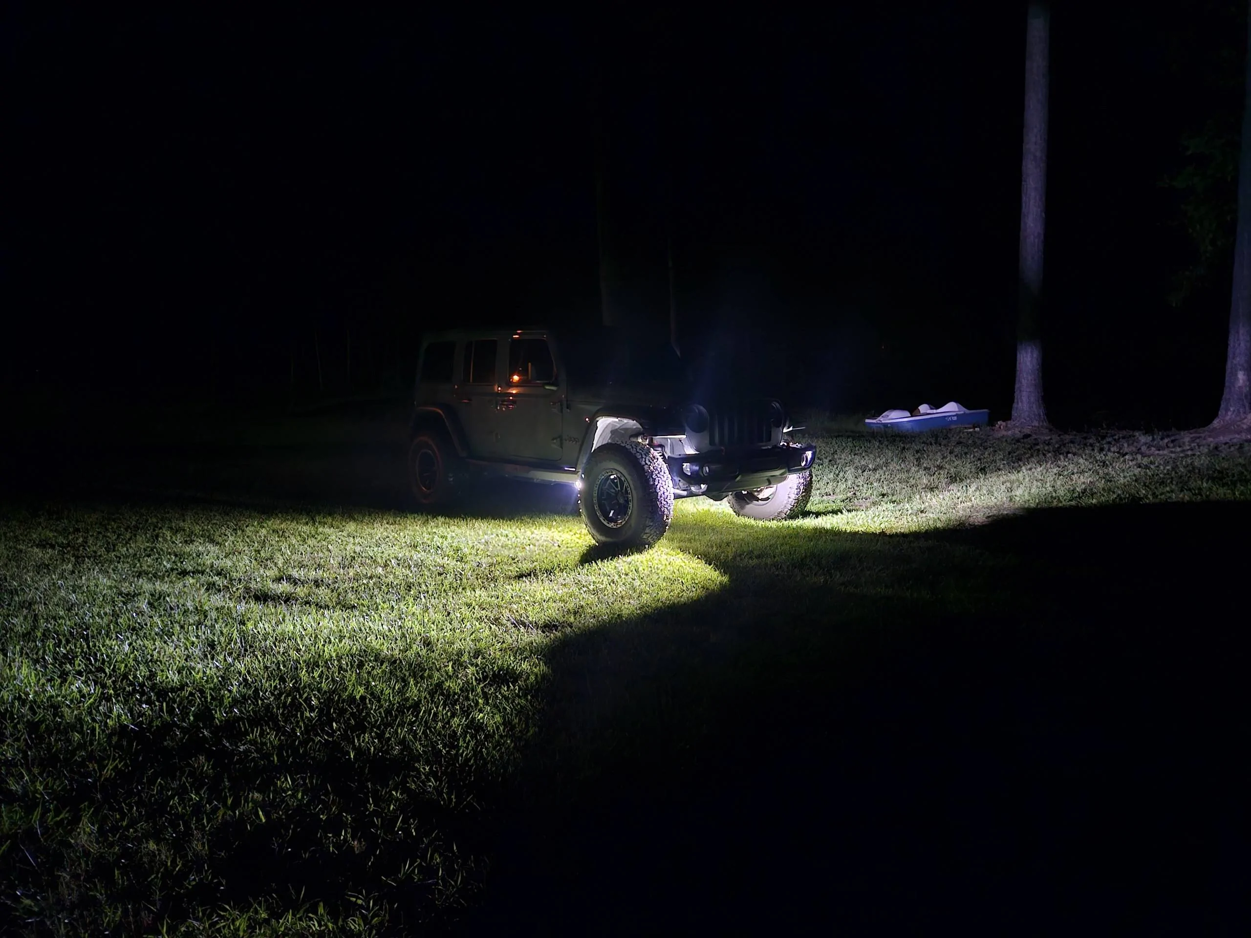

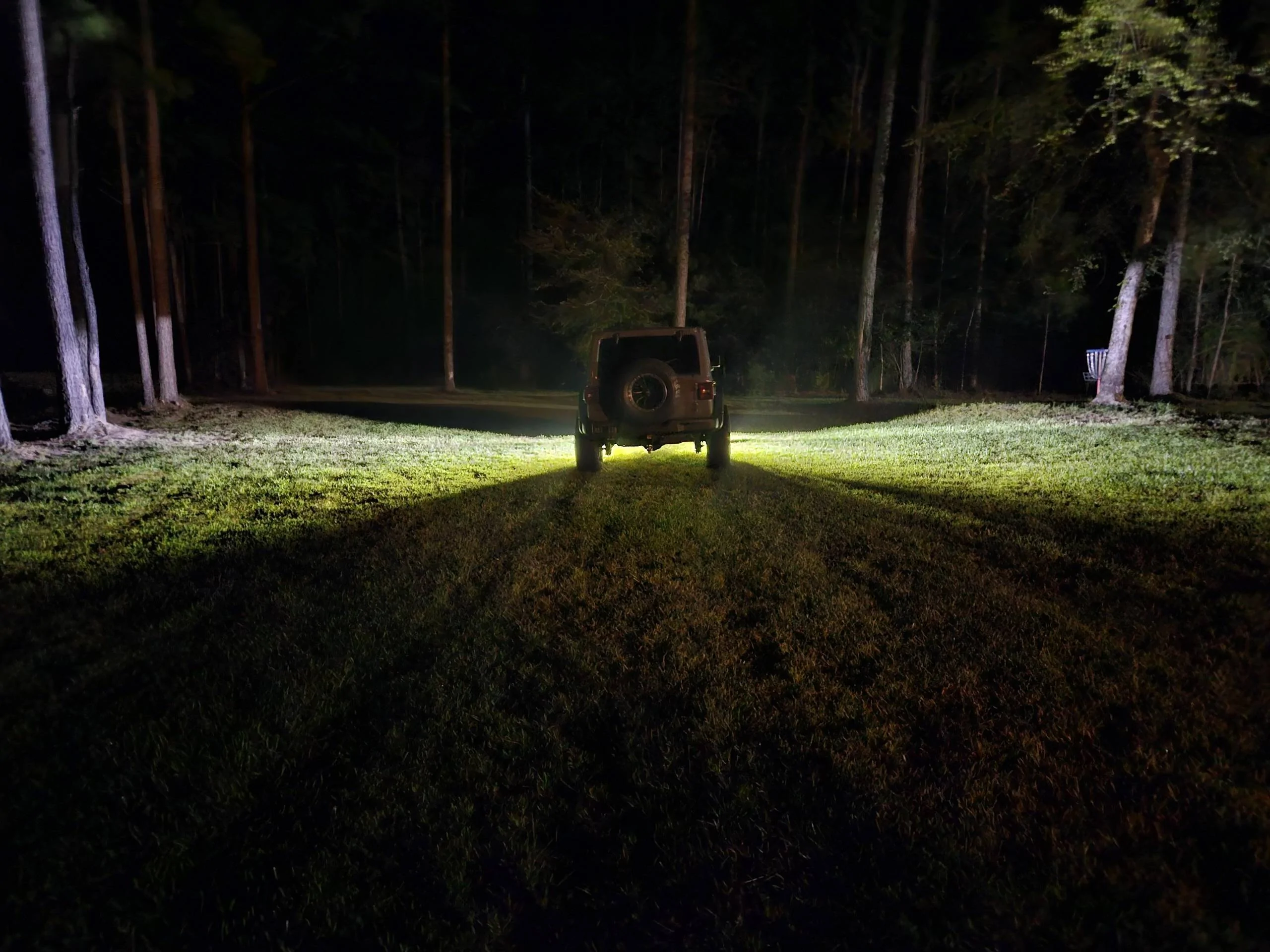

I pulled of the interior foot well light, so when you unlock with remote/or open the door they come on for a few long seconds. They automatically shut off, then as well I wired up a switch so I have manual control to turn them on when I want or full off (never come on).
Had to use a 3 way switch, custom bracket to hide the switch then a solid state relay (to handle the "dimming" foot well light as the signal, then 4 white rock lights from Oracle).
They are bright, but love them as puddle/approach lights!

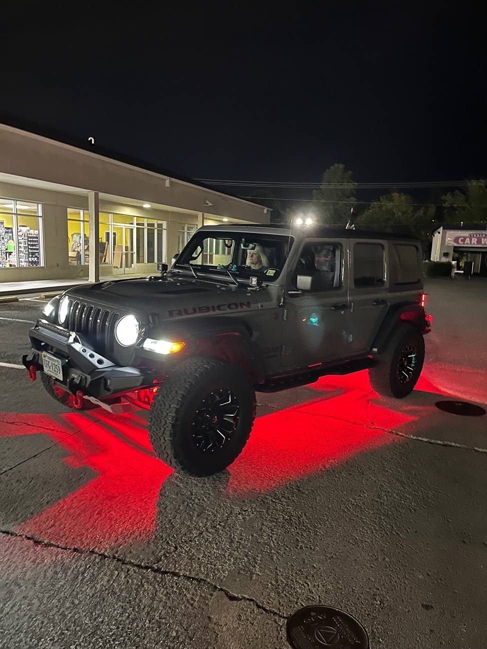

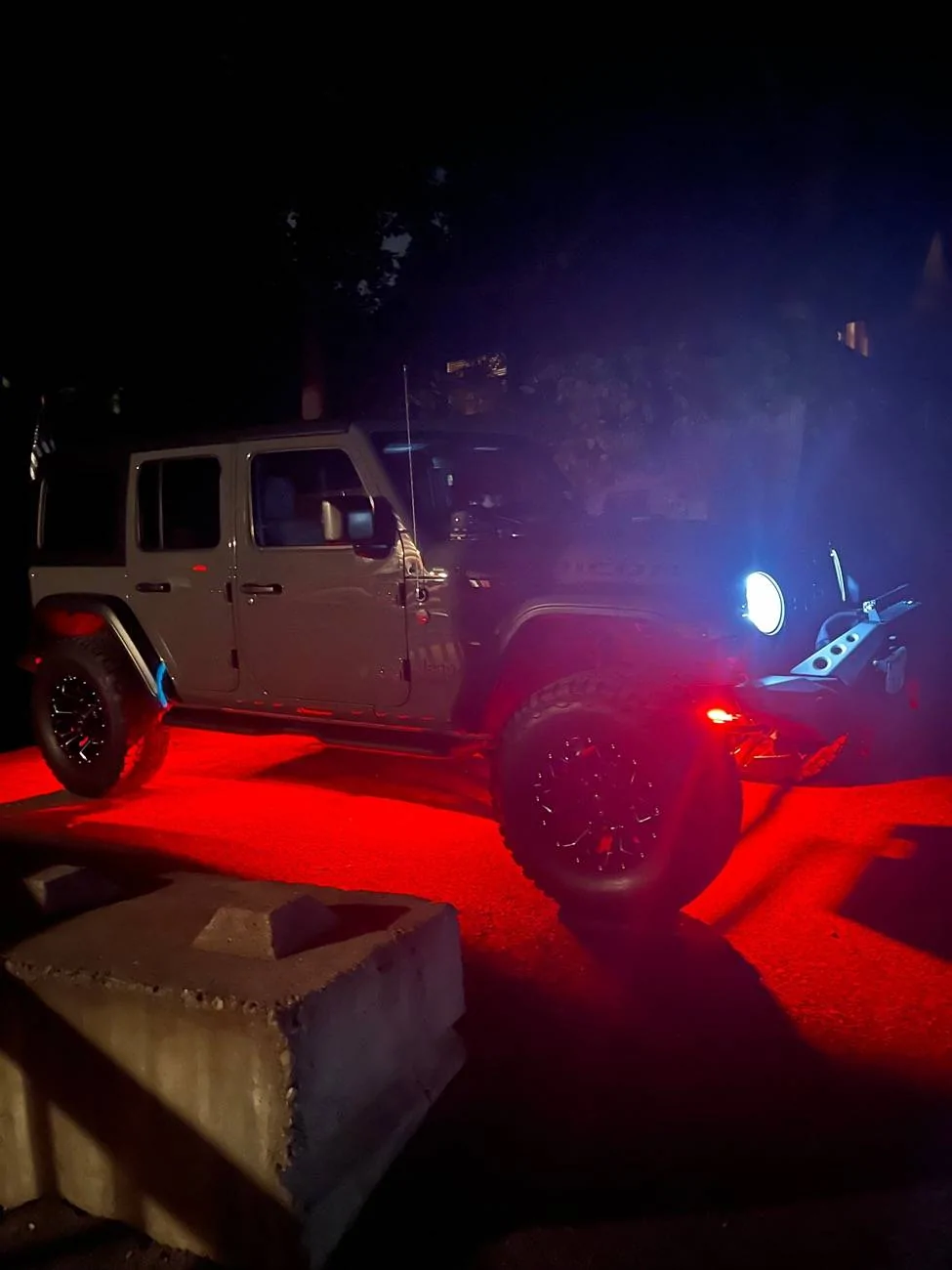

Lux magnetic, wired to aux switch and also Bluetooth to phone can turn on from a good distance away.
Looks great! Could we add this photo to our website?

For sure, I can try to take a better picture too if that helps!?
You guys have been great to work with/resolved any issues quickly.

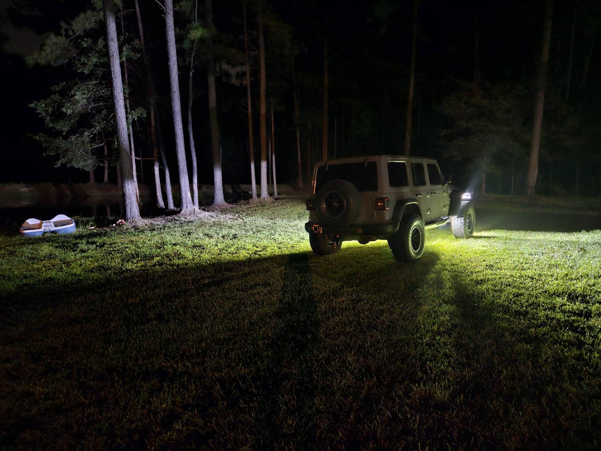

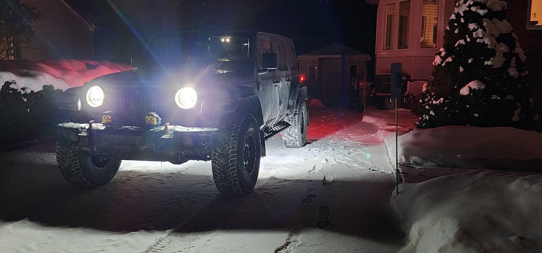

I might be biased, but I think the Flashtech Magnetic Mini6 are the brightest and easiest to install. They throw off a ton of light and make it easy to see where I’m stepping at night. I mounted them near the rock rails, and they’ve been holding up great.
I wired mine to an AUX switch so I can turn them on whenever I need, but you could also tap into the courtesy lights if you want them to come on automatically when unlocking the Jeep.
Here are a few pics of how they look:

Thanks! There are a total of four rock lights—two on each side. One is mounted behind the front bumper, and the other is positioned just behind the front wheel on the frame, with the same setup on both sides.
