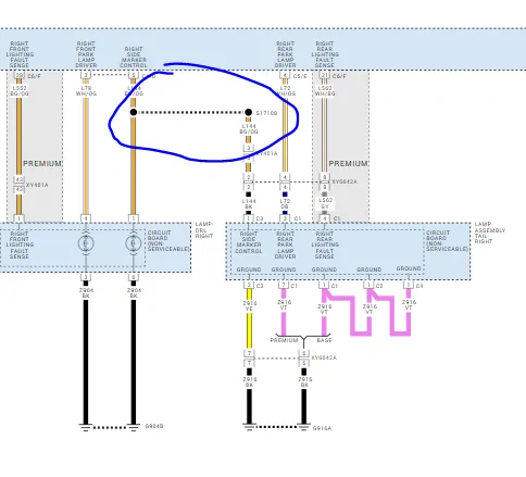

What color are the wires? Let me check the diagrams.

Yup, confirmed, lol.
OK, I think I have it figured.
Are your front DRLs still halogen? The lead to the side markers is spliced between front and rear. If you have halogens, you may have enough voltage drop to not fire the rear LED.

I figured it out....sort of....and rather stupid on my part. Those side lights are running lights and need to be turned on....they won't light up just with brakes and/or signals. So, I turned them on with my halogens and they BOTH worked. So, I tried the LEDs again....one works perfectly.....the other does not work.....the side light and outer ring fail to light up even though the signal works. So....it looks like I have a bad LED light. The halogens are back!!! At least I am getting good at taking these in and out.....and connecting and disconnecting those connectors!!!
