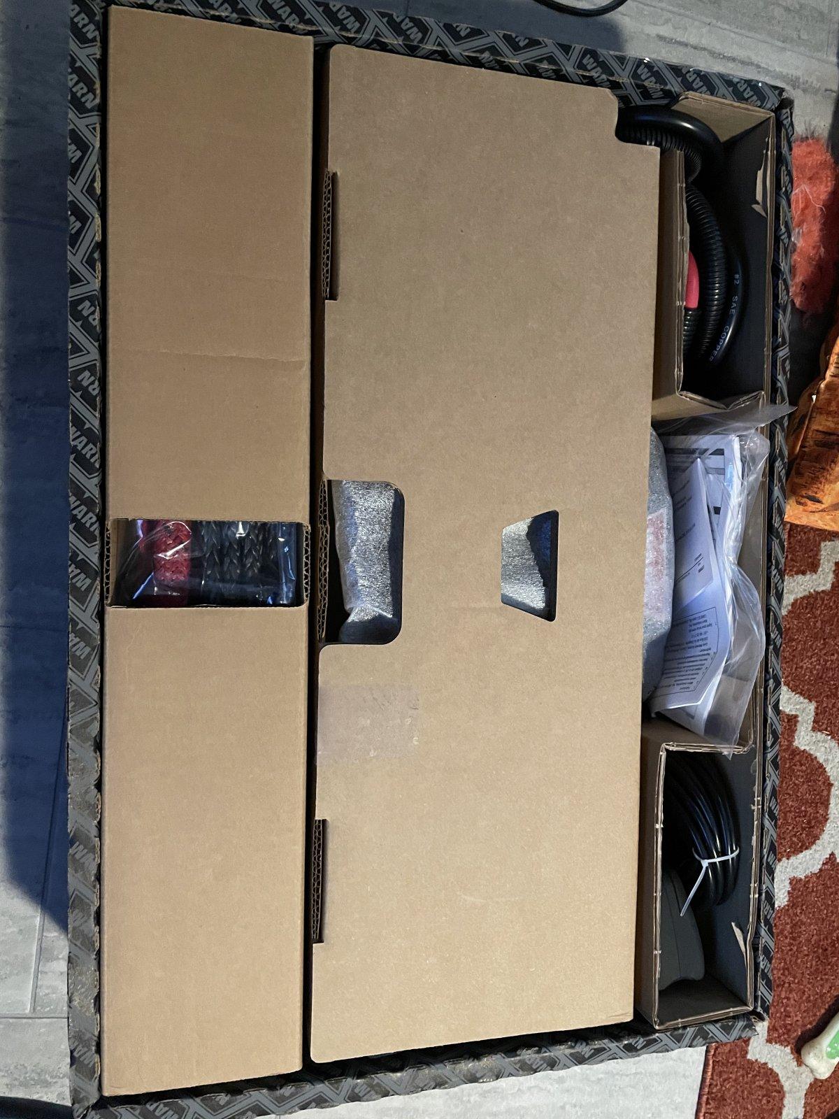

Warn uses a lot of cardboard and little foam wrapping on the Zeon that was delivered today.
Outer shipping box
Primary Packaging/Display Box with Lid Stapled to Inner Box that is extra thick
Then each portion divided beyond that
