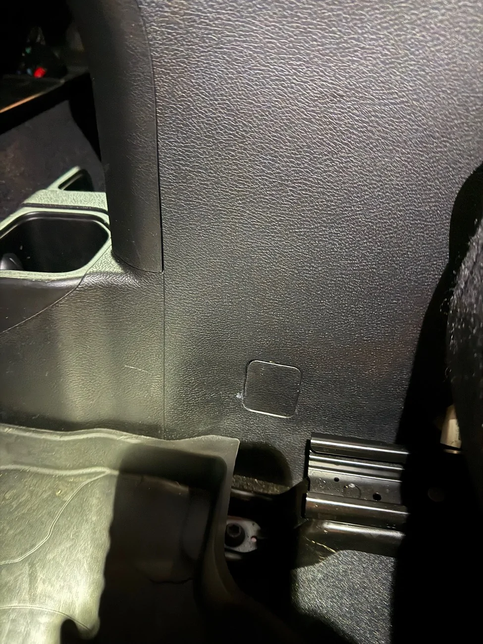

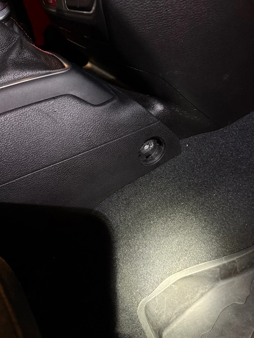

No reason to bring to the dealer. This is a common problem and a quick fix. It is very frustrating if you dont know exactly what to do however. It took me some trial and error to find exactly what to grease because initially I used some brush on lithium grease that did not get all the way into the pin that needs to be greased. You need a can of spray lithium grease. You also might initally think you need to remove the shift knob, cup holders, boot ect. Dont remove any of this. Just do the steps below.
1. Remove the (4) 10mm bolts holding the center console down. They are hiding behind little removable panels. Use a small flathead or pick tool.

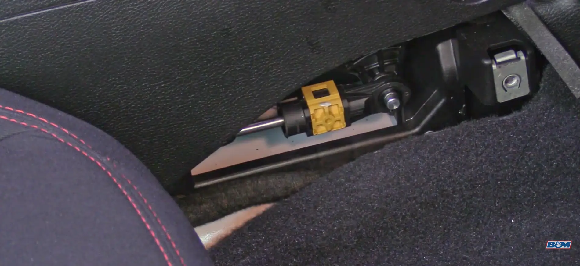

This will give you the ability to 2. lift up on the center console and raise it about 3-4". Thats all you need. You will see this linkage pin.
Jeep Wrangler JL Shifter boot - shift linkage squeak IMG_2405
3. Squirt the lithium grease on that round pin and work the shifter back and forth and voila, noise is gone. Your welcome.
