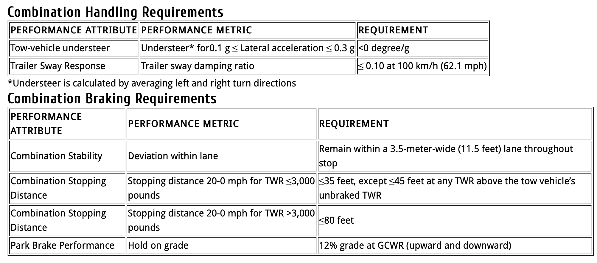

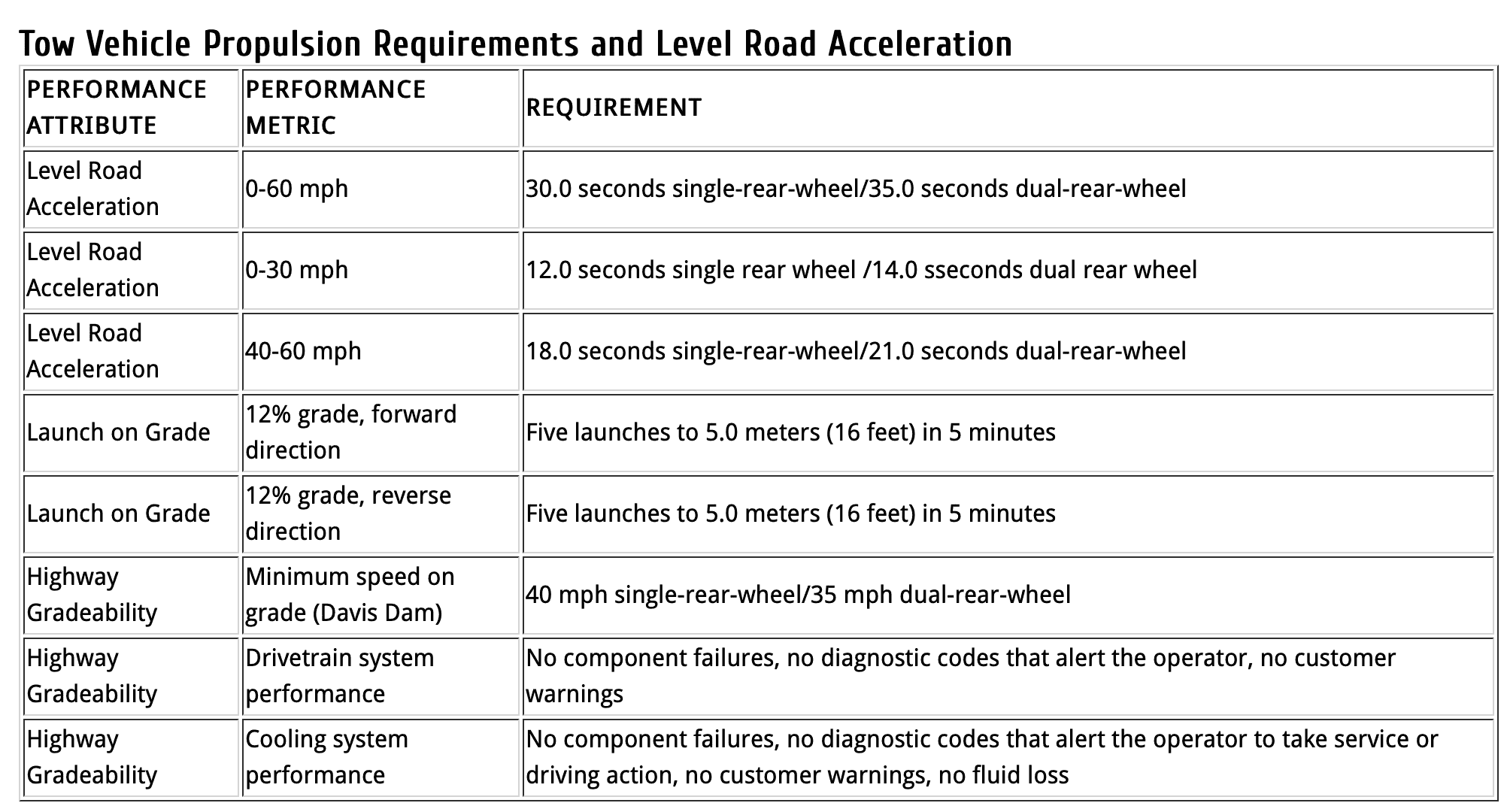

The JLU's tow rating is 3,500 pounds and not specifically the receiver, right?
I'm fairly sure that that's the result of a lot of factors, including braking, suspension, vehicle length, laws, maximum speeds allowed while towing, lawyers, etc. The limits of the receiver are buried in there somewhere, but I'm thinking that they're not an overall limiting factor.
correct EU versions have a towing limit of 5500lbs, they have a mandatory speed limit while towing though, I think of 55mph.
highlights of test:
Jeep Wrangler JL Shackle Hitch Opinion? 1663296682939
Jeep Wrangler JL Shackle Hitch Opinion? 1663296722476
