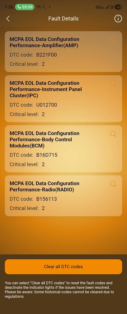

Here are the OBD error codes:
BCM: B16D715 Critical Level 2
IPC: U012700 Critical Level 2
AMP: B221F00 Critical Level 2
RADIO: B156113 Critical Level 2
I am stumped.. would have bet the module went bad and apparently my model year has no manual TPMS master reset. It sb automatic...
Pics posted.
