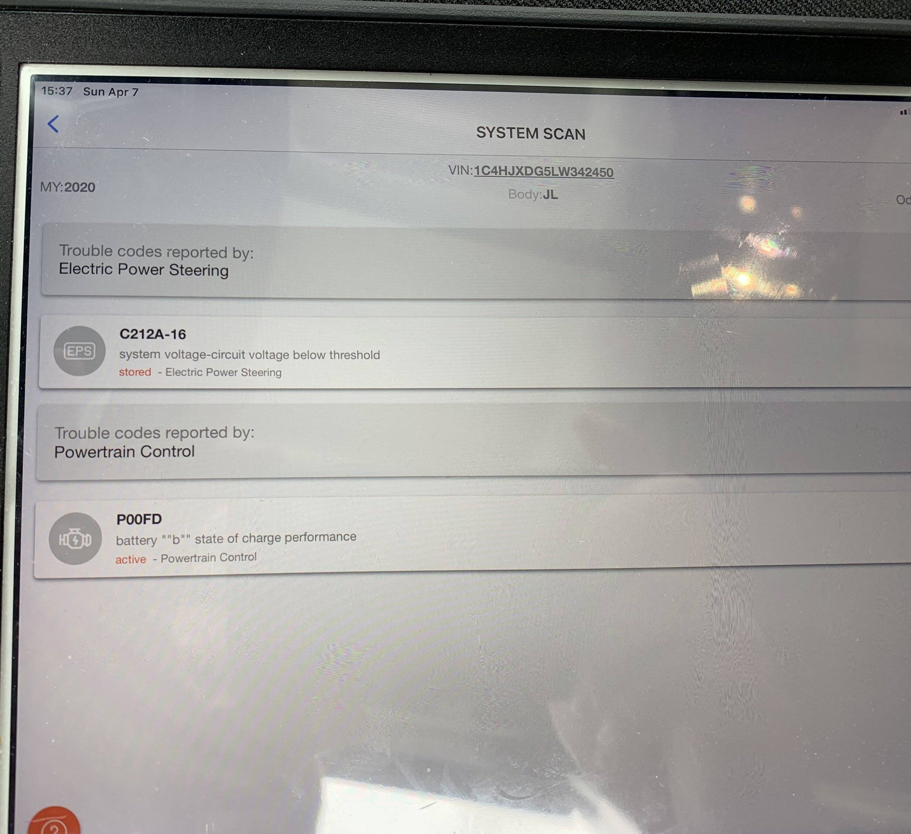

I have a 2020 JL that I bought used last year. About 3 months ago the light came on for the Start/Stop System. I have a JScan and decided to run the diagnostics to see if there were any error codes. It showed two. One from the Electric Power Steering stating system voltage-circuit voltage below threshold and the other from the Powertrain Control stating battery “b” state of charge performance. The main battery was changed just before I bought the Jeep last summer. I don’t know how old the auxiliary battery is. If it is failing could it be causing the error codes? I did bypass the auxiliary battery by pulling the fuse and disconnecting its negative cable from the main battery but that didn’t help.
Thanks in advance for any information

Your batteries are bad. This is what happens when you only change one and not the other. The older battery will kill the new battery. Don't do that.
Replace both Main and Aux at the same time and you'll be fine for a good while.

Thank you everyone for the replies. It did confirm my suspicions it was auxiliary battery related. I was hoping bypassing the auxiliary battery would clear it up. Maybe if I reset the codes with JScan? I need to figure out how to do it. I also need to disable ESS with JScan if that’s an option.

Do the Aux bypass, and replace the main battery at the same time.

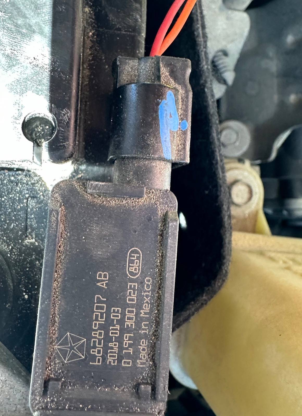

Does anyone know what this is? It’s on the Beatrice battery post and what was bolted down. I disconnected the positive and negative and pulled the fuse… just not sure what to do with this?

Leave it alone. Read this thread. First few pages are the key pages.
https://www.jlwranglerforums.com/fo...sing-the-aux-battery-easiest-solution.100296/
So I had unhooked the positive to the six battery as well and Jeep wouldn’t start. Hooked the positive back up and every things work like a champ.
I had already pulled the #42 fuse… so we will see. I’m also going to access my canbus behind the glove box and push all white connectors in…. And buy a spare canbus as a risk aversion step.
thanks for the input and the link
