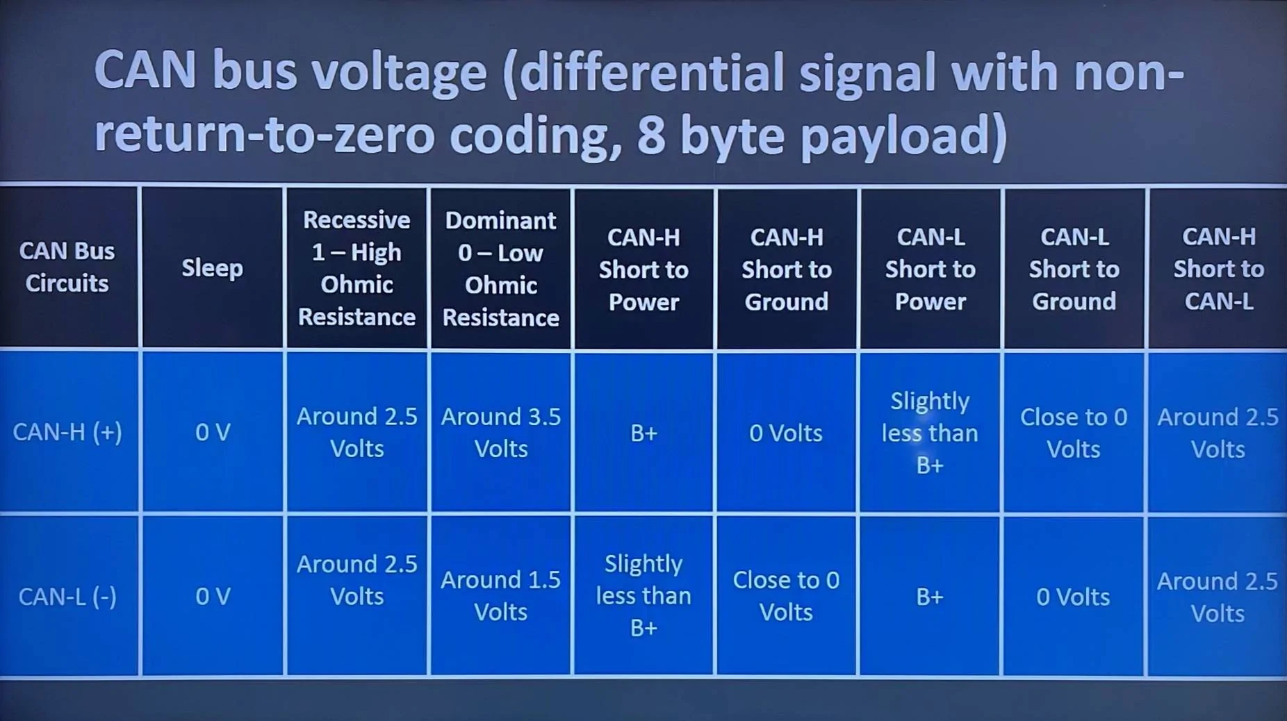

Here is some aid for someone who might be trying to use a multimeter to diagnose this (but it may not end up being necessary):

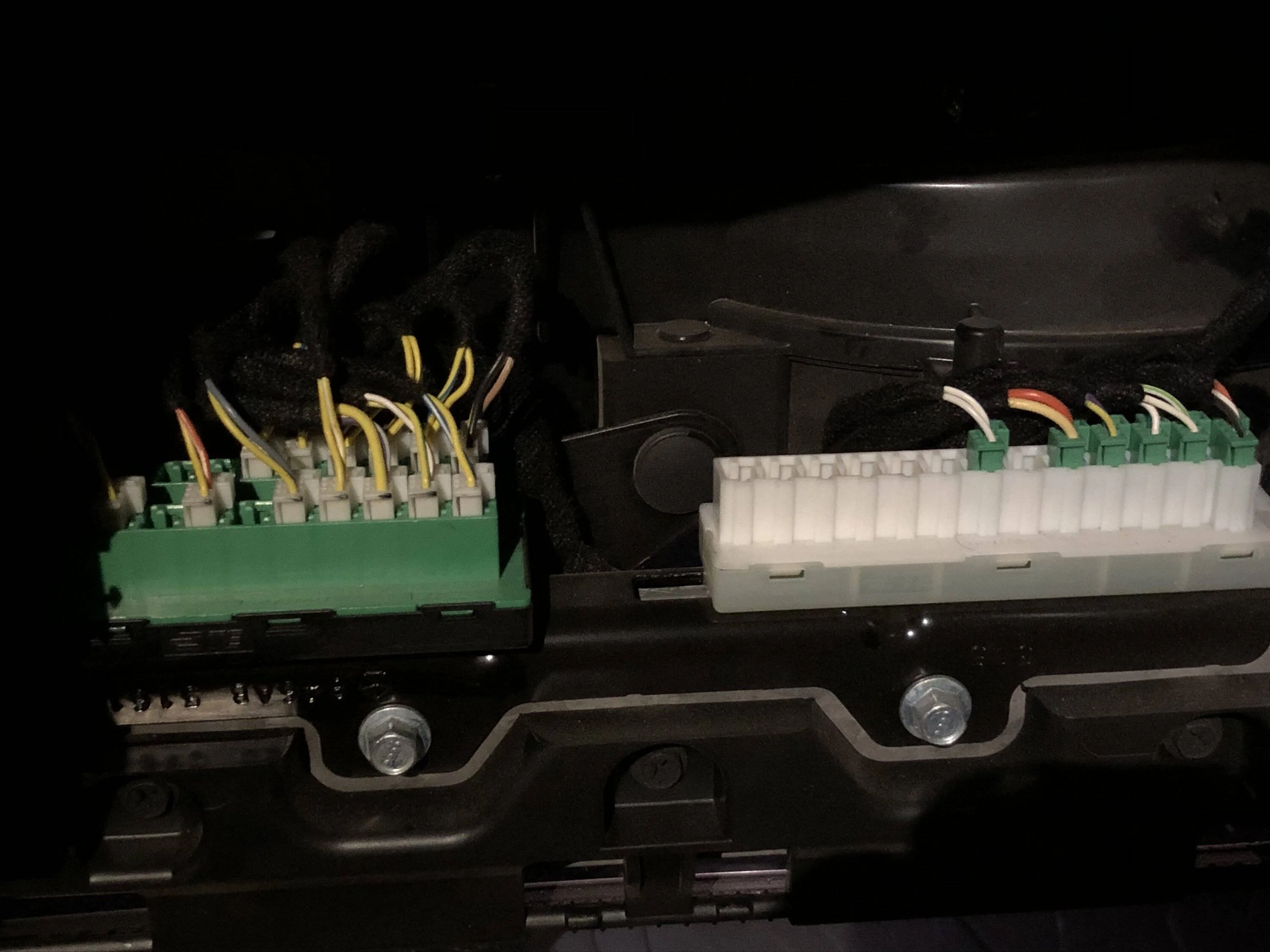

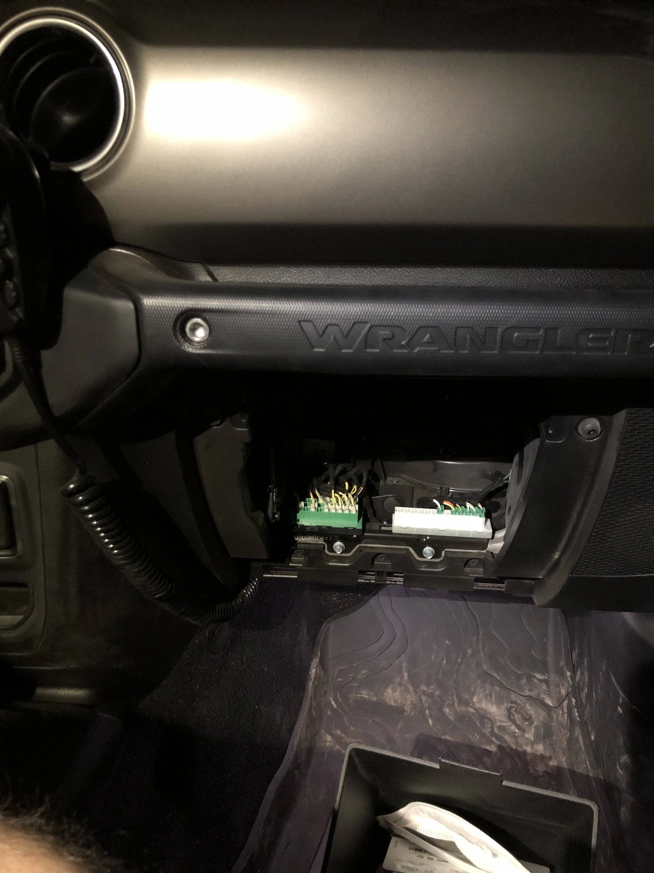

My Can Bus C issues appear to have stemmed from a loose connection on the star bus bar behind the glove box. Wish I would have checked that before I drove half way across the country to get back from Moab after my power steering cut out in Colorado. The technician referenced this star case number https://static.nhtsa.gov/odi/tsbs/2021/MC-10212468-9999.pdf
Very easy connections to check, it takes 10 seconds to pop the glove box out
Thanks for posting the STAR.
Yes. That and there is another one like that under the passenger front seat (this one can actually be damaged if you store or push things under the seat.
I checked those two first. But in my case it was an external harness near the transmission tunnel that was chafing.

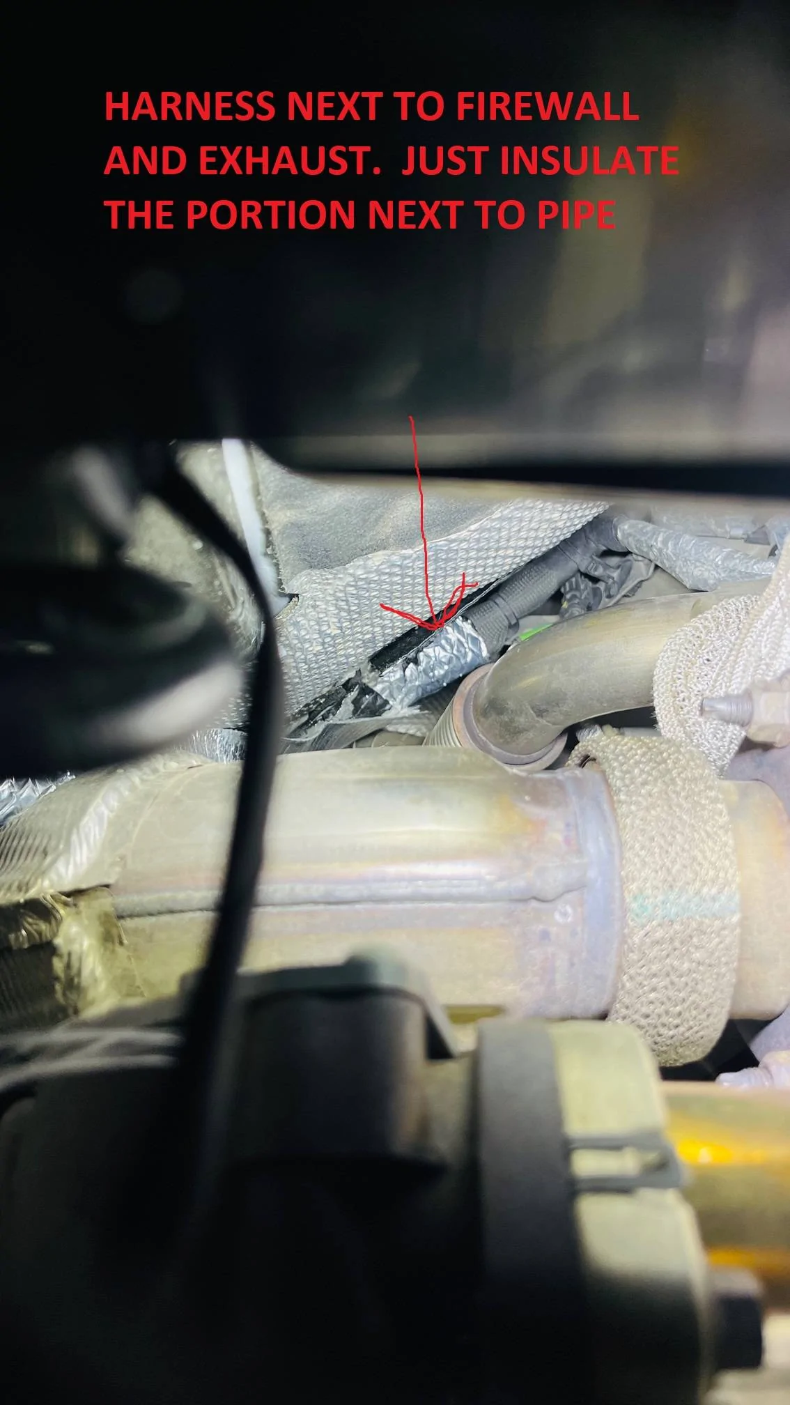

I found my problem.
2021 Jeep Wrangler JLU
Ecodiesel
Stock
Symptoms:
1. "Service Shifter Soon"
2. Random warning lights
3. Loss of power steering
I noticed that even the slightest bump would trigger the malfunction after ten minutes or so.
The fix:
Insulate the wiring harness next to the exhaust pipe at the entrance to the transmission tunnel.
This is on the passenger side of the tunnel. The loom wrapping of the harness showed very minor signs of rubbing, but no exposed conductors were visible.
Wrapped the loom in heat-reflective insulation and secured with stainless steel zip ties.
It's been five days now with ZERO incidents, and I'm calling it fixed.
Good Luck.

I found my problem.
Ecodiesel
Stock
Symptoms:
The fix:
Good Luck.
Picture of affected area pretty please!!!!
