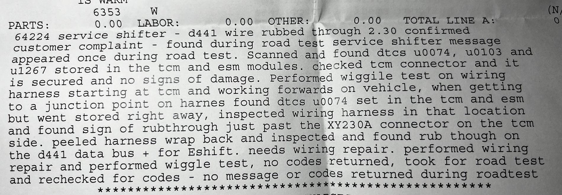

Posting update. 2nd dealer resolved my issue (so far). Fix below
That was exactly my issue and same resolution. It has been trouble free for 2 years now, including multiple off road trips over mud and water.

There are a few threads on the "Service Sifter" msg and some related CAN C (high speed) Bus errors, but none of them has a fix or list of parts changed to fix or dealer service record.
If you have had the "Service Shifter" issue or other error messages (ABS system error, Stability control not available error, etc) and have a fix, please post what the fix is, preferably with a list of parts changed and/or picture of service record. All these modules are connected via the high speed CAN C bus, and there will typically be multiple codes.
If you have pictures of suspected/actual affected areas, please post - e.g. some people indicated a faulty/rubbing wiring harness near right front tire, others a pinched harness under shifter housing.
Many have indicated no resolution from dealer to date - it would be good to know what was tired.

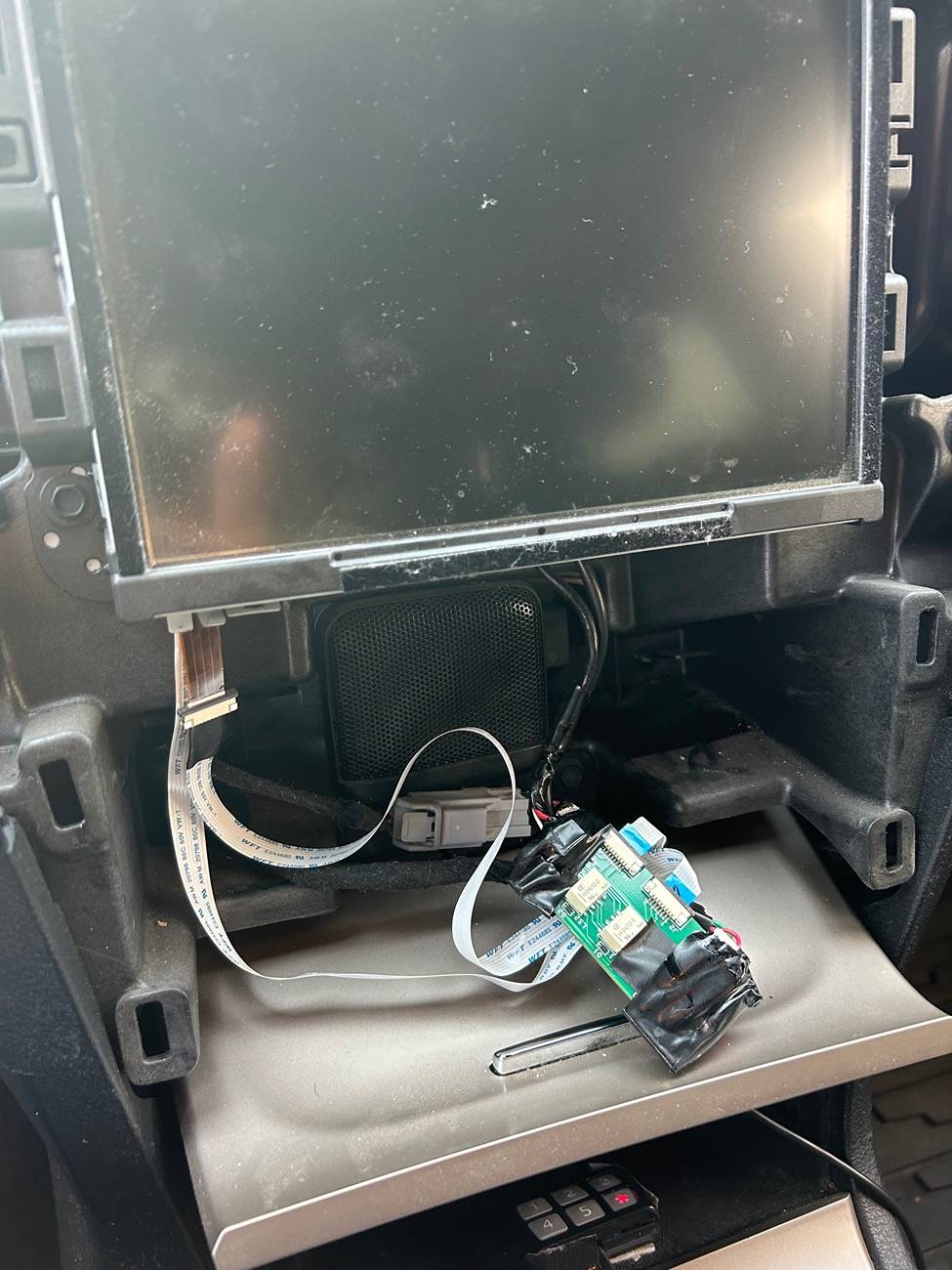

Hi ,
Tnx for reply ,
I am suspicois this electronic card behind the Radio i found it like that.
Do you think this is the cause?

Hi ,
Tnx for reply ,
Hi, I am really not an expert on CAN Bus, so don't want you to rely too much on my comments....But, I really don't think that board or the entertainment system is connected to the High Speed CAN Bus C. Can Bus C is reserved for important controls like stability control, transmission control, power steering control, etc.
Even if that board is connected to a can bus, which I doubt, it would not be the CAN Bus C.
Having said that, the root of all these CAN bus problems is signal/electrical noise that corrupts the messaging traffic. Any circuit that generates noise, interference or affect the ground can cause issues. I just don't think that is culprit.
It is a detective work, though. You need to check all the harnesses to the components mentioned.
Good luck on the hunt.
