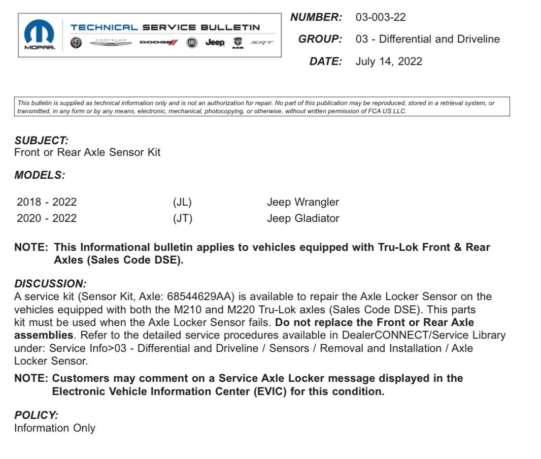

This TSB may prove helpful…
Jeep Wrangler JL Service axle locker on and off 1663045178784
Thanks. I potted my sensors to work around this TSB, and don’t think they’re to blame. (When those fail the light stays on and the lockers won’t work.)
